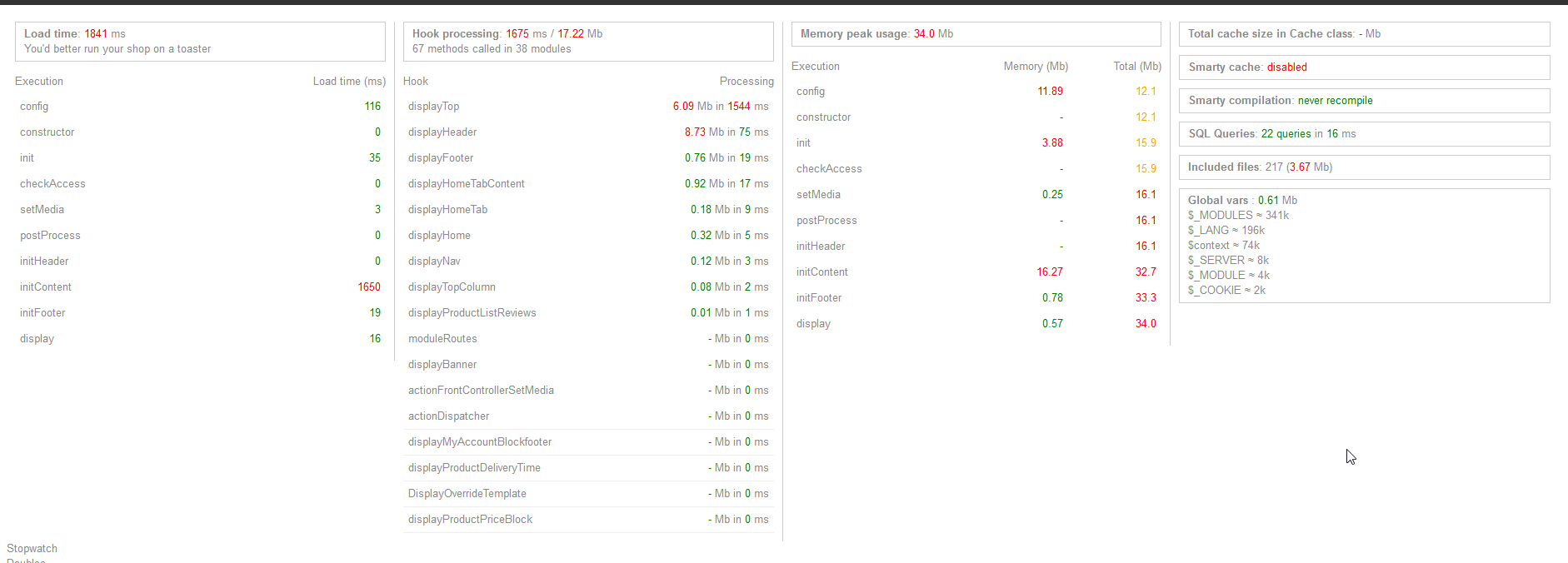

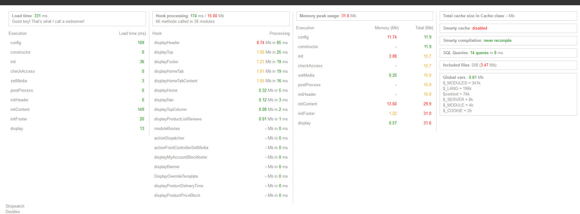

flopp Posted February 26, 2015 Share Posted February 26, 2015 I have setup a new Prestashop store that is running very slow. Page load speed is 2 seconds on every request. I set the define('_PS_DEBUG_PROFILING_', true); in condif/defines.inc.php and found the problem in "initContent" and the hook "displayTop". Further I disabled all modules that used "displayTop" hook. I re-enabled until "blockcart"-module. Then the Processing time went from 85ms to 1544ms. Prestashop version: 1.6.0.11 blockcart version: 1.5 This is the default blockcart module that comes with Prestashop. I have attached the before and after benchmarks. How can i troubleshoot this further? Why is this module so slow? Link to comment Share on other sites More sharing options...
