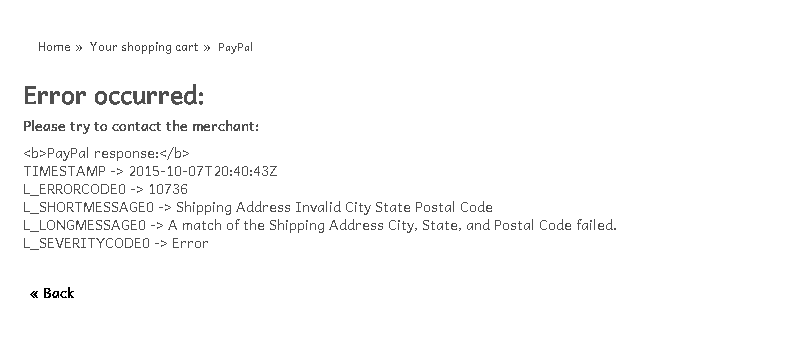

subaru4wd Posted October 7, 2015 Share Posted October 7, 2015 Well I haven't had any problems with missing orders, however I do get several orders that receive a "payment error" because the customers shipping address does not match the paypal address on file. I noticed every one of our military customers who try to place an order to an APO are no longer able to. Is there anyway to avoid this? Link to comment Share on other sites More sharing options...
subaru4wd Posted October 12, 2015 Share Posted October 12, 2015 Any fix for this address mis-match error?I had 7 orders this weekend that failed to process the payment. These are big dollar orders, and I typically email the customer to smooth things over, and get them to make a paypal payment manually, then I push the order into processing. If we could avoid this problem, my customers orders would process and I could go back to doing other things instead of sending out a bunch of emails. Thanks. Link to comment Share on other sites More sharing options...

subaru4wd Posted February 5, 2016 Share Posted February 5, 2016 More and more orders are failing to process because of payment errors with paypal. Most recently this error for some international customers: Quote PayPal response:TIMESTAMP -> 2016-02-05T22:41:59ZL_ERRORCODE0 -> 10723L_SHORTMESSAGE0 -> Shipping Address State EmptyL_LONGMESSAGE0 -> The field Shipping Address State is requiredL_SEVERITYCODE0 -> Error The Field Shipping Address State is Required but that field is not available for international addresses in prestashop. Its odd cause orders from customers in brazil get this error but i have orders from customers in turkey and their address has no state, but the payment processed fine??? Any idea's how to avoid this? Link to comment Share on other sites More sharing options...
tdr170 Posted February 6, 2016 Author Share Posted February 6, 2016 Actually Brazil does have States do a google search, My guess is that at some point PayPal updated their Software to require States for Brazil now. Well there is an easy fix for this go to localization, localization at the top of the page you will see Import localization pack use the drop down and select Brazil, uncheck everything except state. Now go to Localization, Countries and find Brazil click on edit and change the Contains States to yes, now in the address area make a space belox Address 2, on the right side choose State, then click name this will add a State:name to the address field, now your customers can include the state when they register. For those already registered hopefully they are not a lot go the address section of your BO and look for the addresses with Country, Brazil and copy the City, then do a simple Google search What state is Belo Horizonte in Brazil, you will get an answer of Minas Gerais, you can now use the drop down in the address edit to choose this State. Link to comment Share on other sites More sharing options...
subaru4wd Posted February 6, 2016 Share Posted February 6, 2016 Oh Geeze... thanks. Im going to have to do this for all other countries as well... i can see it being a huge pain. Thanks for the reply. Link to comment Share on other sites More sharing options...
