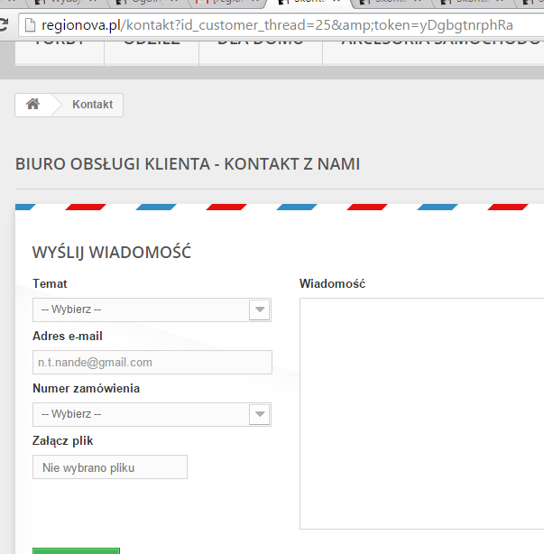

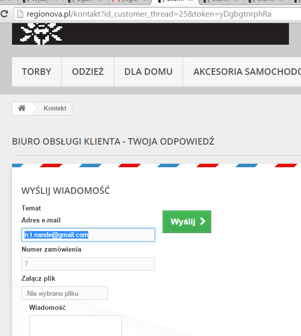

nnande Posted February 24, 2015 Share Posted February 24, 2015 Hi all! I've faced the following problem: I send a message to a customer by BO. He receives a message with a reply link - by default to save the message thread. The link looks like that: http://regionova.pl/kontakt?id_customer_thread=25&token=yDgbgtnrphRa Entering it the contact page appears, but it's broken - can't enter any topic etc. I've discovered, that if i add "amp;" after ampersand symbol everything works. The working link: http://regionova.pl/kontakt?id_customer_thread=25&token=yDgbgtnrphRa So, the question is what should i do to make prestashop render that "amp;" inside or maybe there is a different solution? I've found that the {link} phrase is responsible to paste the proper link inside mail. The file is in mails\en\reply_msg. Thanks. Link to comment Share on other sites More sharing options...
