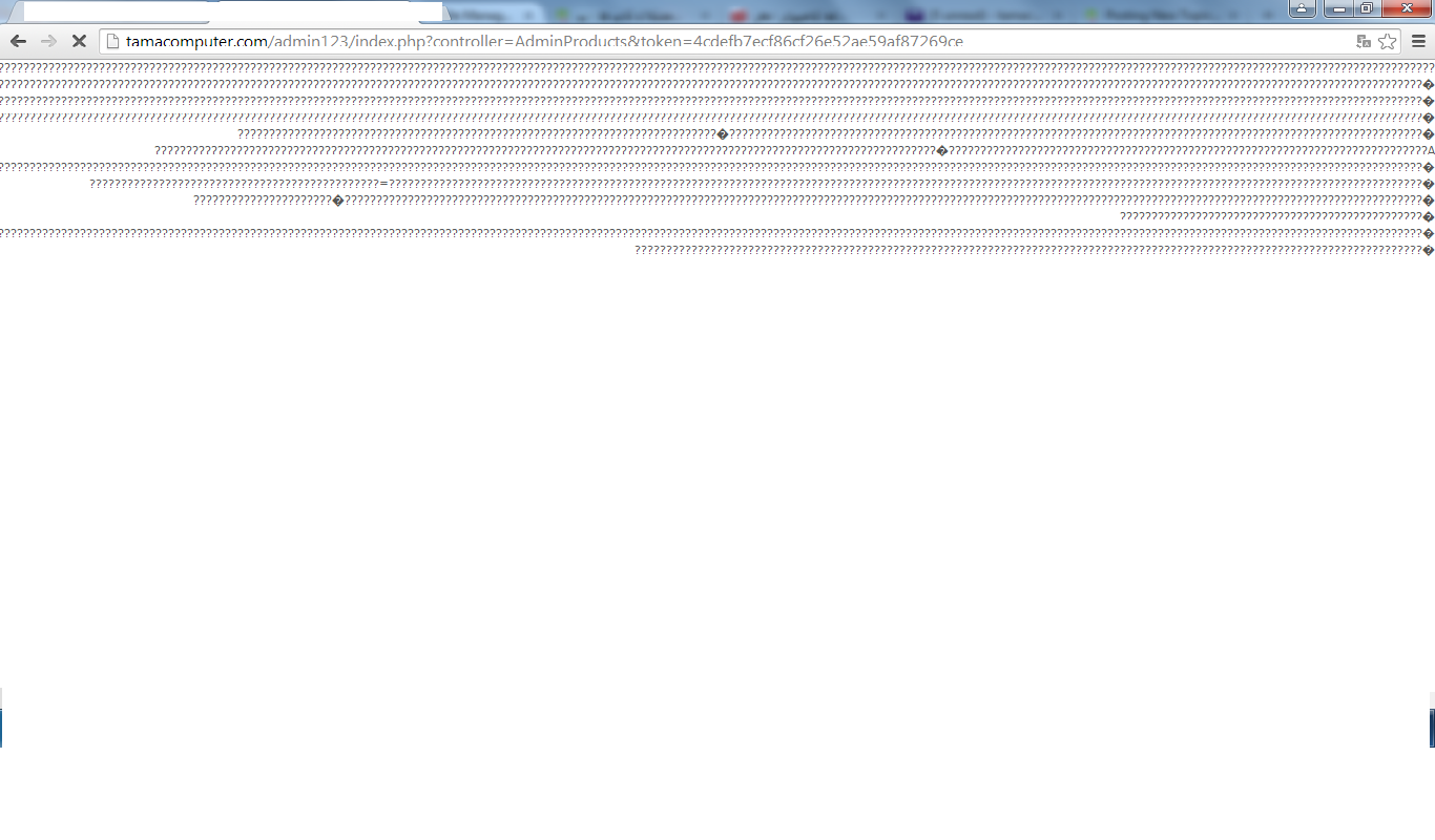

tamacomputer Posted February 7, 2015 Share Posted February 7, 2015 Hi! After shifting my host And creating php.ini file in admin folder,this charecters (????????....) appeared in my admin dashboard,i uploaded the pic of my admin dashboard after appearing the error. Help me Please Link to comment Share on other sites More sharing options...

helldog2004 Posted February 9, 2015 Share Posted February 9, 2015 Can you check your Memory_limit inside your php.ini file? If not 128M change it to this and see if this is solving any problems. Also, did you activate error reporting? And if so, does this gives any results? 1 Link to comment Share on other sites More sharing options...
tamacomputer Posted February 9, 2015 Author Share Posted February 9, 2015 tnx keka sag! i added memory_limit=128M in php.ini file but no changes happend! i activated error reporting and it dident give me any results! but , when i renamed the php.ini file for example: 1php.ini the error disappeared but this error ((Warning! Your hosting provider is using the Suhosin patch for PHP, which limits the maximum number of fields allowed in a form: 1000 for suhosin.post.max_vars. 1000 for suhosin.request.max_vars. Please ask your hosting provider to increase the Suhosin limit to 3388 at least, or you will have to edit the translation files manually)) appeard Link to comment Share on other sites More sharing options...
helldog2004 Posted February 9, 2015 Share Posted February 9, 2015 open your .htacces and enter the following php_value max_input_vars 10000 This should edit the local commands and must show you all fields. Let me know if this worked out. 1 Link to comment Share on other sites More sharing options...
tamacomputer Posted February 9, 2015 Author Share Posted February 9, 2015 i entered, this error appeared Internal Server ErrorThe server encountered an internal error or misconfiguration and was unable to complete your request. Please contact the server administrator, [email protected] and inform them of the time the error occurred, and anything you might have done that may have caused the error. More information about this error may be available in the server error log. Additionally, a 500 Internal Server Error error was encountered while trying to use an ErrorDocument to handle the request. Apache/2.2.29 (Unix) mod_ssl/2.2.29 OpenSSL/0.9.8e-fips-rhel5 mod_bwlimited/1.4 Server at tamacomputer.com Port 80 Link to comment Share on other sites More sharing options...
helldog2004 Posted February 9, 2015 Share Posted February 9, 2015 Okay, then delete the code from .htaccess and call your host if they are allowed to edit the code I gave to you. There is a possibility that they are restricting it for their users. If they increased it, let them also increase the Suhosin limit to something like 10.000 That should resolve this issue. 1 Link to comment Share on other sites More sharing options...
