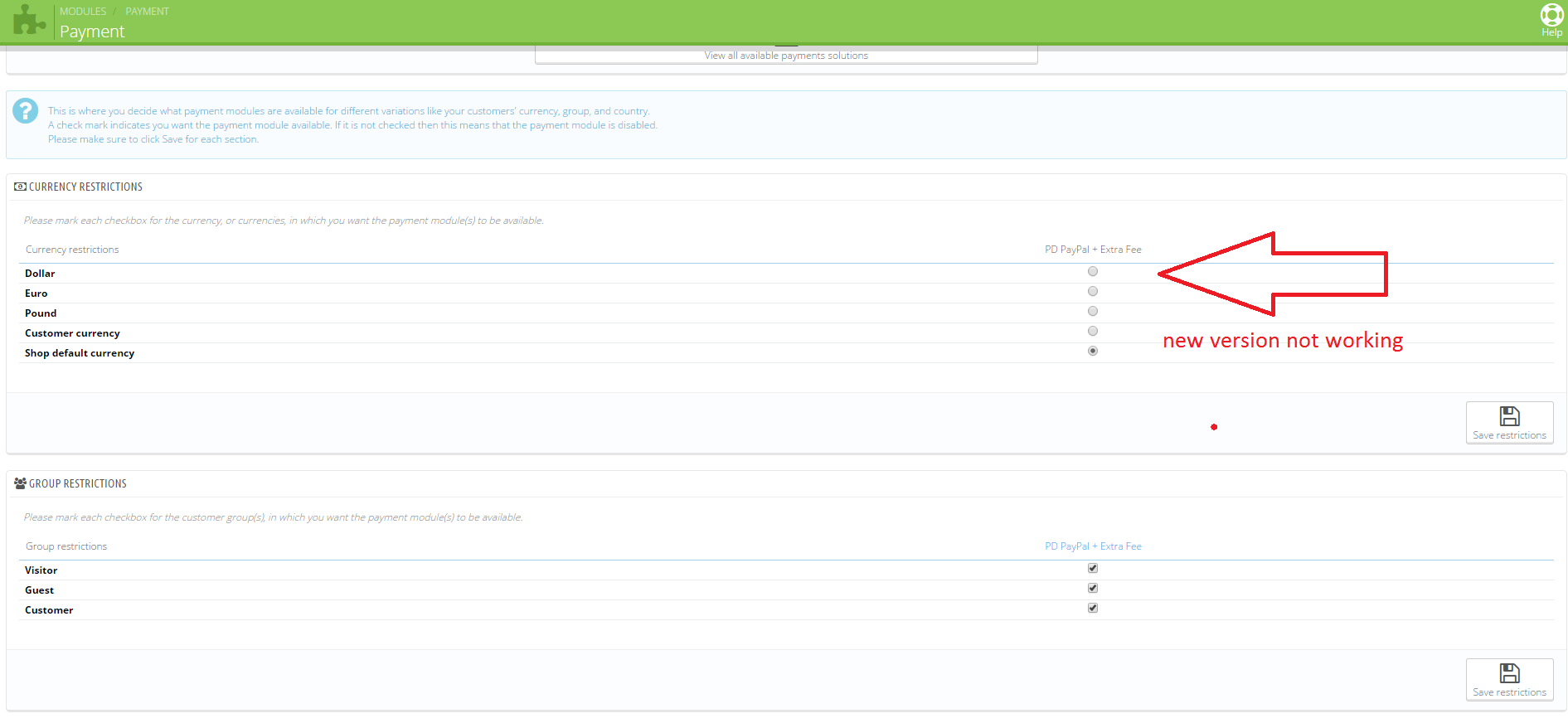

PC33 Posted February 7, 2015 Share Posted February 7, 2015 Hello everyone, i hope i can explain this right so that some one can help me. On my old Prestashop version 1.4.0.9 on Payment tab, i was able to force the customer paying only in USD in case i needed for. Basically i just selected USD and then all checkouts would be finished in USD currency, from paypal express checkout or normal checkout with Paypal. Now with the new version 1.6 everytime i pick the option USD only, on the checkout it says "no payment modules have been installed", ive been looking arround but no solution so far, not to mention that i only use Paypal as payment method. In the other hand if i select on payment the option "customer currency" it works, but i realy dont want this option because mostly we use EUR as currency and USD only when we need some USD balance. Can anyone help me with this, do i need to setup a new carrier or anything like that? Thank you all Kind Regards Link to comment Share on other sites More sharing options...

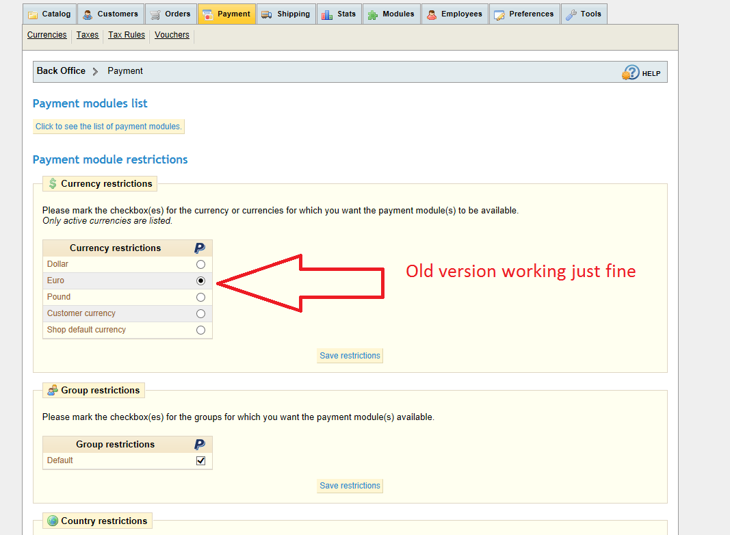

PC33 Posted February 7, 2015 Author Share Posted February 7, 2015 Hello Let me try again, on my old prestashop version 1.4.0.9 everytime i needed some USD currency on my Paypal, i only needed to change on the Payment tab the option USD as you can see on the images i posted. On this new version 1.6 everytime i need USD i was suposed to do the same, but when i do that, and a customer does a normal checkout without changing the currency to USD on the site the payment module dopes not show up, which was not needed on the old version, even when a customer used EUR as checkout, upon paypal payment page it will be in USD. Now it does not work on this new version Link to comment Share on other sites More sharing options...

PC33 Posted February 8, 2015 Author Share Posted February 8, 2015 Hello I guess no one is getting to understand my problem. My current version is Prestashop 1.6 and the defayult currency works just great, all customers can pay in Euros, but if i chose ONLY USD currency, the payment modules are gone and i cannot receive money in USD, on my old version 1.4 it was working just fine Kind Regards Link to comment Share on other sites More sharing options...

doekia Posted February 9, 2015 Share Posted February 9, 2015 (edited) @PC33, I have a strange feeling that due the upgrade some table such as module_currency did not get populated properly. Do you have the knowledge to check such? If not pv me so I'll access your database and try to figure out what happened. And I disagree with some other comments, a lot of people do remember how those beauty such as PS 1.3, 1.4 and 1.5 worked. Also double check that on "modules > payment", the various currencies are ticked on the restriction panel. The panel is just below the commercial advertisement flood about Addons modules and before the group restriction panel. Best Edited February 9, 2015 by doekia (see edit history) Link to comment Share on other sites More sharing options...

PC33 Posted February 9, 2015 Author Share Posted February 9, 2015 Hello I dont think its a module that is causing this, because it only happens when i change Payment options to any other currency on the admin panel except EUR or Shop Default Link to comment Share on other sites More sharing options...
