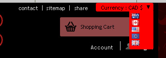

This solution works (the currencies in the drop-down list do appear now as flags), however there are two problems, see photo attached.
1.) currency currently selected still shows as a symbol, not a flag. I have no idea how to fix this, but I am sure that what I need must have to replace ths:
<input type="hidden" name="SubmitCurrency" value="" />
{l s='Currency' mod='blockcurrencies'} : {$blockcurrencies_sign}
2.) Symbols don't appear next to the flags. I would like the symbols to be inline with the images.
Can anyone please help? Thank you in advance!

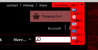

Update on problem #2: On my own I figured out how to put the symbols in next to the flags, however they are not aligning properly - see photo attached. This looks like a CSS issue, however I don't know where or how to make the drop-down list "wider" so everything will display nicely inline. All I did was change the <a> tag to:
<a href="javascript:setCurrency({$f_currency.id_currency});" title="{$f_currency.name}">
   <img src="../../img/l/{$f_currency.id_currency}.jpg" alt="" style="float:left;">
    <span style="float: right;">{$f_currency.sign}</span>
</a>
Edited by artofadornment (see edit history)
