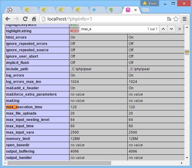

bellini13 Posted February 23, 2015 Share Posted February 23, 2015 what value does phpinfo give you? Link to comment Share on other sites More sharing options...
stevent Posted February 23, 2015 Share Posted February 23, 2015 (edited) 120 but the result is always the same in prestashop Edited February 23, 2015 by stevent (see edit history) Link to comment Share on other sites More sharing options...

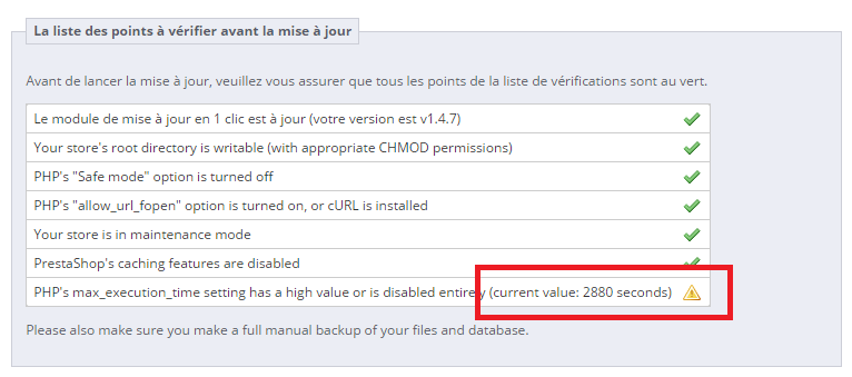

stevent Posted February 24, 2015 Share Posted February 24, 2015 (edited) thanks for hour help, there is a screenshot of my result Edited February 24, 2015 by stevent (see edit history) Link to comment Share on other sites More sharing options...
bellini13 Posted February 24, 2015 Share Posted February 24, 2015 Ok, I see. Have you tried ignoring the 'warning' and just running the upgrade? Or will it not allow you? Link to comment Share on other sites More sharing options...
stevent Posted February 24, 2015 Share Posted February 24, 2015 I dont see thé button thats The problèm Link to comment Share on other sites More sharing options...
bellini13 Posted February 24, 2015 Share Posted February 24, 2015 the auto upgrade module attempts to disable max execution time by setting the time limit to zero, and setting max_execution_time to 0 in AdminSelfUpgrade.php public function __construct() { @set_time_limit(0); @ini_set('max_execution_time', '0'); apparently your hosting environment does not like this, so I would suggest you remove these lines of code from the module, and just manually reconfigure your PHP to use an acceptable value. 120 seconds is 2 minutes, no clue if that is long enough for your store, you will just have to do trial and error and find the right value Link to comment Share on other sites More sharing options...
