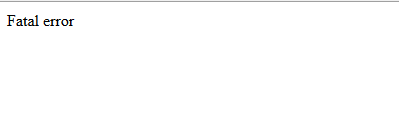

Totti Posted July 4, 2015 Share Posted July 4, 2015 Yes supplementmuscle.com What I've noticed that if I put a cart then increase the amount eerore me the attachment.Then if I change the page gives me fatal error. Link to comment Share on other sites More sharing options...
