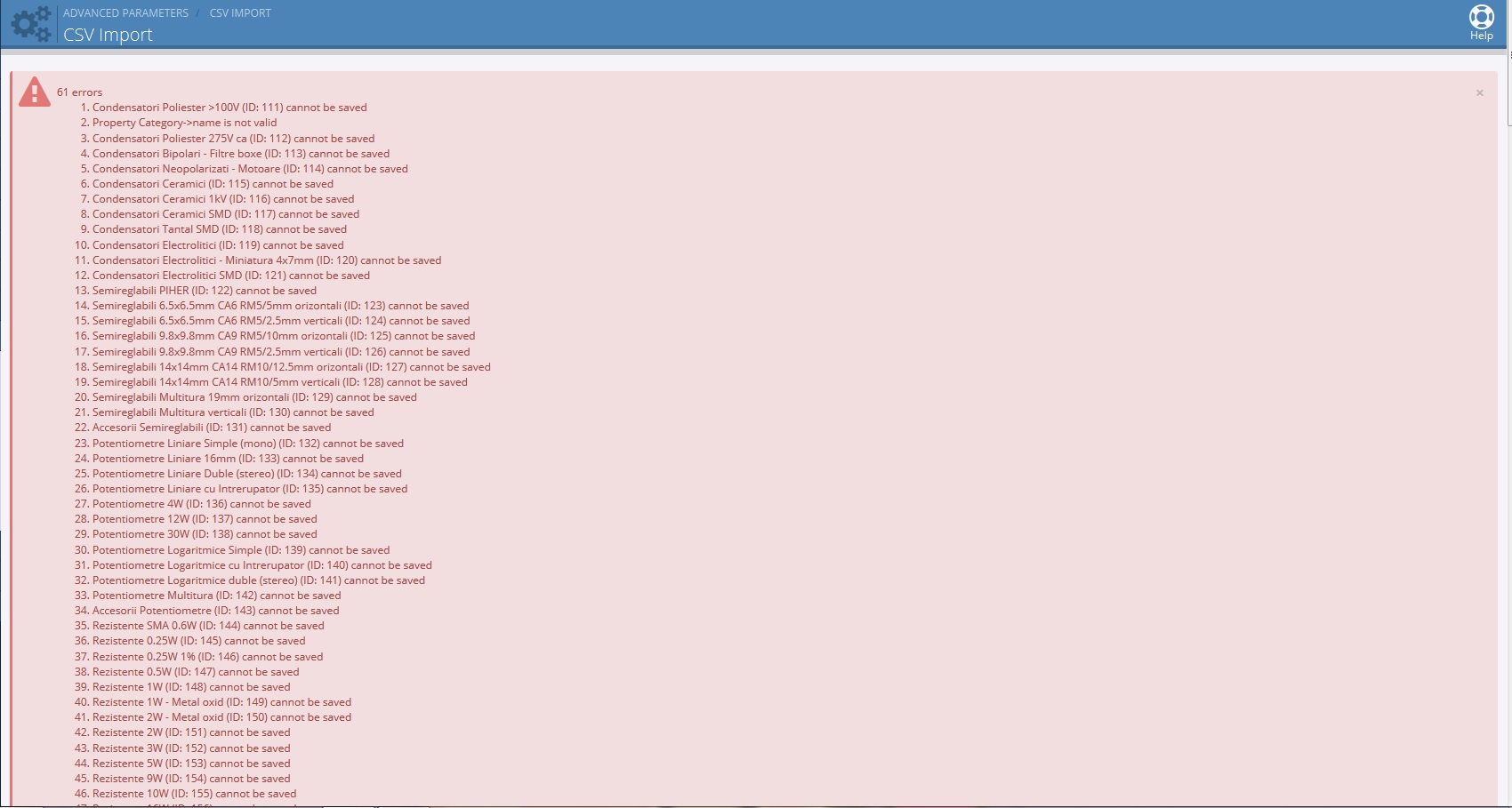

Alex Nitu Posted February 1, 2015 Share Posted February 1, 2015 I keep getting this error "(ID: XXX) cannot be saved" for lots of my categories. I will post the CSV file and tell you my steps, so maybe someone can explain why is this problem. Aslo, if you take a look at the picture, on line 2 you will se "Property Category->name is not valid", and I didn't specify that in any of the lines from the CSV file, so I'm a bit confused. After making this sample file I: - uploaded it into the CSV import tab - selected the "," as the separator value - used coding ISO 8859-1, as the way I saved the file - disabled force ID - enabled delete all categories before import - hit upload and then this error showed up I uploaded the full (or at least how much I could capture) error message, and the CSV file as a dropobx download, since I'm not allowed (for some reason) to upload it here directly. CSV file: https://www.dropbox.com/s/7agxer3472yhhg9/categories_test.csv?dl=0 Link to comment Share on other sites More sharing options...
Alex Nitu Posted February 1, 2015 Author Share Posted February 1, 2015 Ok, so I figured out what caused the issue. It seems that the script doesn't allow you to use certain symbols such as ">" or "<". These in my file, but there could be more. Hope this helps someone. Solved! Link to comment Share on other sites More sharing options...
