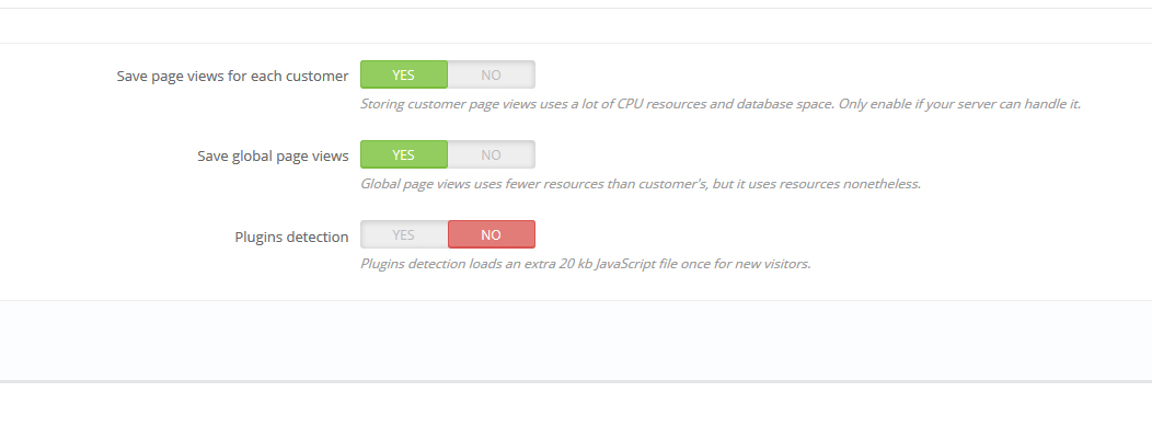

vekia Posted January 31, 2015 Share Posted January 31, 2015 query is okay, the problem is probably with fact that: - your shop doesnt have "data mining" module (installed and enabled) configuration of this module must look like: Link to comment Share on other sites More sharing options...
lateral Posted January 31, 2015 Author Share Posted January 31, 2015 Hi Vekia, The data Mining module has been installed and configured for many months and since the beginning of my store. Here is a screenshot of the current configuration: Regards Greg Link to comment Share on other sites More sharing options...
