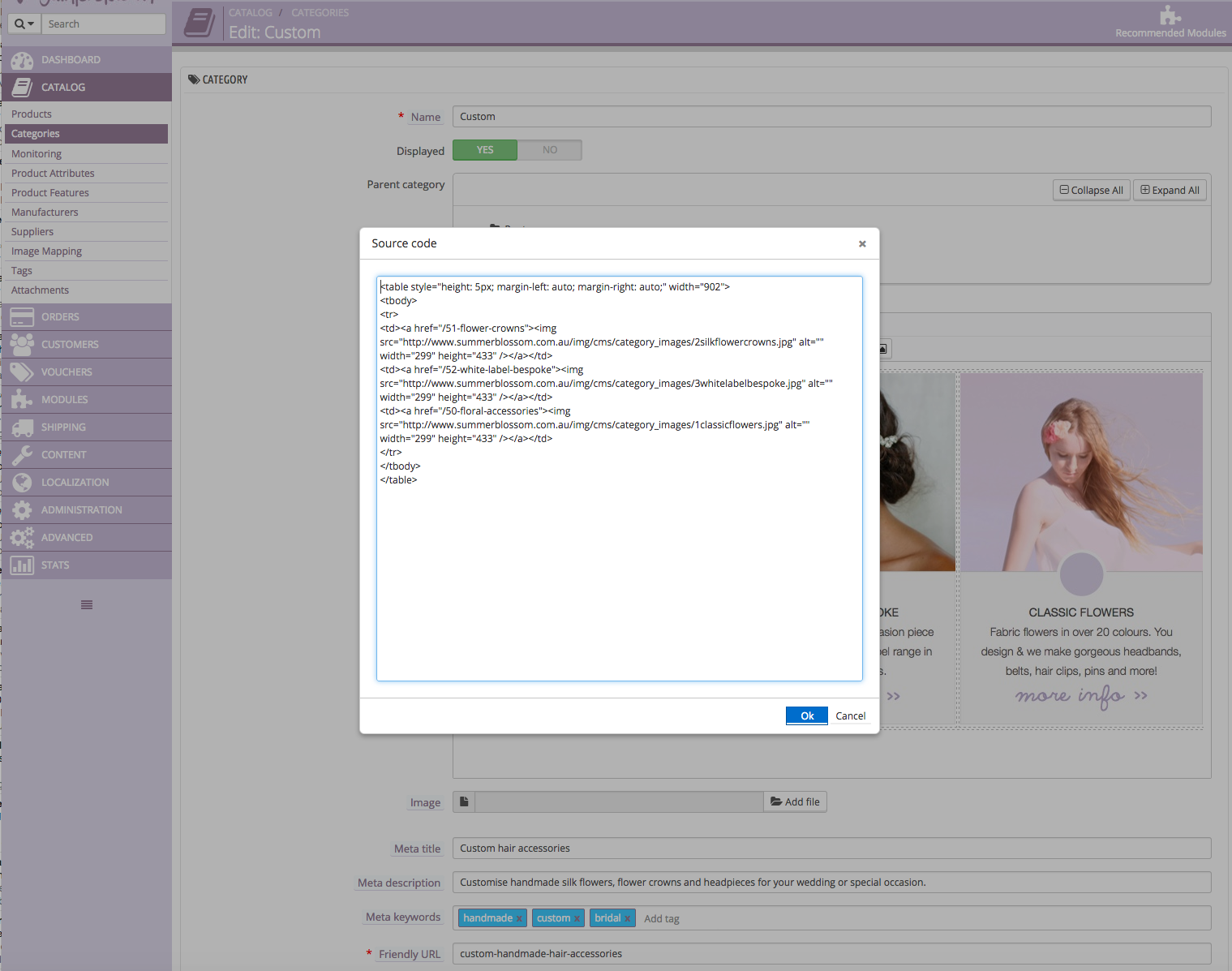

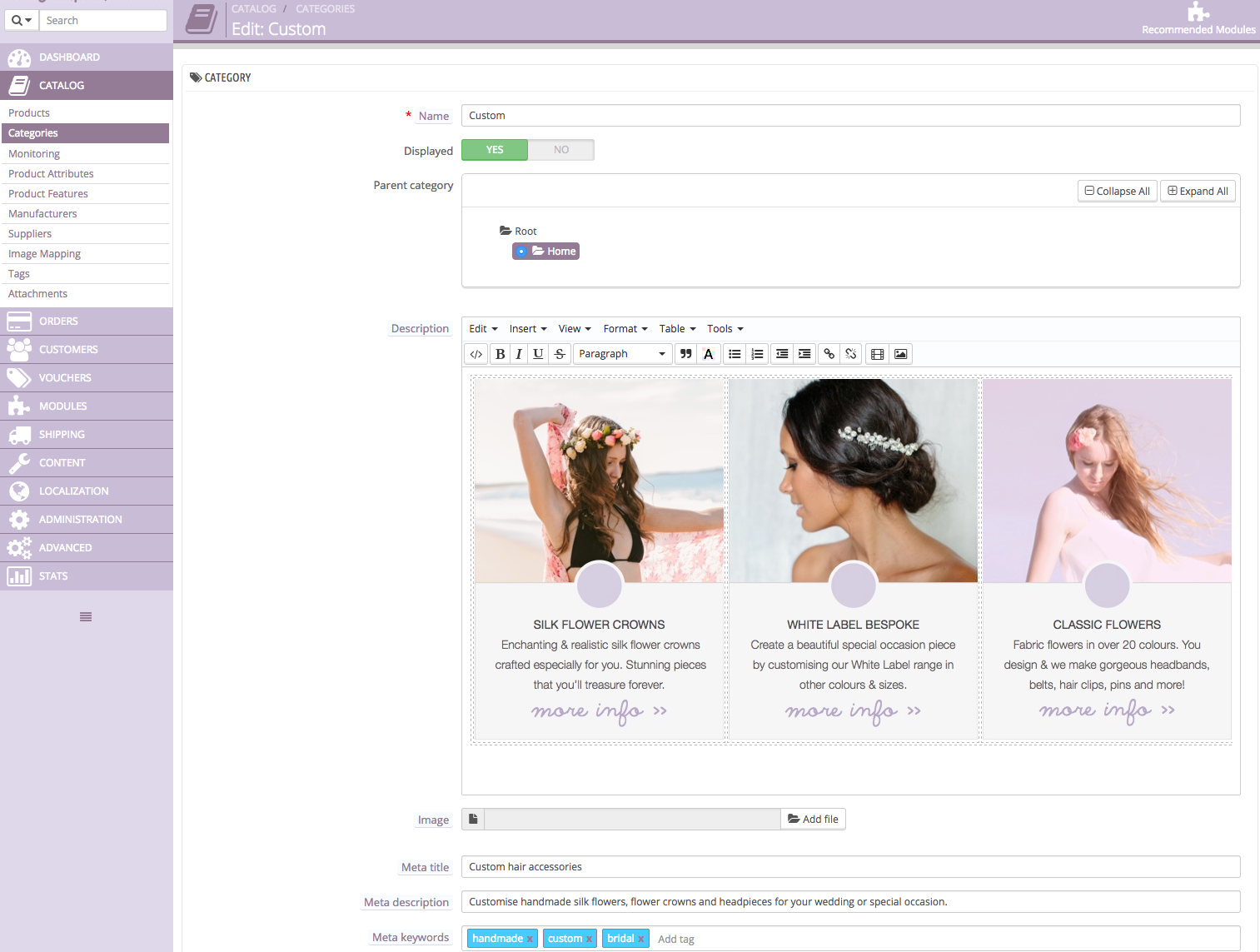

Rochelle Austin Posted January 28, 2015 Share Posted January 28, 2015 Hi all, I'm having difficulties adding images to the top of my category pages. I add one, yet from the front end there appears to be two (an exact duplicate of the first). I'm adding the images via the backend (catalog > categories > edit category). The page is attached and also live here: https://www.summerblossom.com.au/9-custom-handmade-hair-accessories The code I have is: <p><a href="/50-floral-accessories"><img src="http://www.summerblossom.com.au/img/cms/category_images/CLASSIC FLOWERS.jpg" alt="Custom made classic fabric flower accessories hair clips headbands belts bridesmaids flower girls" width="299" height="433" /></a> <a href="/51-flower-crowns"> <img src="http://www.summerblossom.com.au/img/cms/category_images/SILK FLOWER CROWNS.jpg" alt="Custom bespoke flower crowns handmade wreaths hair garlands weddings" width="299" height="433" /></a> <a href="/52-white-label-bespoke"> <img src="http://www.summerblossom.com.au/img/cms/category_images/WHITE LABEL BESPOKE.jpg" alt="Bespoke bridal handmade custom wedding hair accessories headpieces" width="299" height="433" /></a></p> I would like just one set of the three images to appear. Any help would be appreciated, thanks! Link to comment Share on other sites More sharing options...

mikewra Posted February 2, 2015 Share Posted February 2, 2015 Hi, I'm unable to recreate this error. So I'm not sure what you did to get this. Searching my own pages, I'm unable to find these ids. My best guess is that you have made "custom-handmade-hair-accessories" a subcategory of itself. Hence it turns up with both id's "category_description_short" and "category_description_full." Clicking on the "More" link under the second row of products has the page display correctly and "category_description_short" is hidden via style="display:none" However, in both cases, there is no link for either White Label Bespoke or Classic Flowers. Perhaps if you sent screen shots of where you edited this in the back office. Link to comment Share on other sites More sharing options...
Rochelle Austin Posted February 3, 2015 Author Share Posted February 3, 2015 On 2/2/2015 at 12:45 PM, mikewra said: Hi, I'm unable to recreate this error. So I'm not sure what you did to get this. Searching my own pages, I'm unable to find these ids. My best guess is that you have made "custom-handmade-hair-accessories" a subcategory of itself. Hence it turns up with both id's "category_description_short" and "category_description_full." Clicking on the "More" link under the second row of products has the page display correctly and "category_description_short" is hidden via style="display:none" However, in both cases, there is no link for either White Label Bespoke or Classic Flowers. Perhaps if you sent screen shots of where you edited this in the back office. Thanks for the info. I'll attach screen shots of where I'm editing. I don't think the category is a sub-category of itself, from what I can see. Thanks in advance. Link to comment Share on other sites More sharing options...
Rochelle Austin Posted February 6, 2015 Author Share Posted February 6, 2015 Hi mikewra, Did you happen to have a moment to have a look at my screenshots? I still can't work out a solution Thanks,Rochelle Link to comment Share on other sites More sharing options...
mikewra Posted February 6, 2015 Share Posted February 6, 2015 (edited) Hi, Sorry, didn't see the attachments the first time I looked. My best guess on this is that you are adding three categories where there should be one category; and then perhaps 3 subcategories. If you look at the attached image, you'll see the default layout for this: A main category and then three subcategories. But it also appears, and I could be wrong, that you are taking three products and making them into three categories. It doesn't seem like the products lower on the page are necessarily items in one of those three categories. Rather, it seems that everything on this page are all "Custom" or customizable products. That is, the category here should perhaps be something like "Custom Bridal Hair Accessories" and then "Silk Flower Crowns," "White Label Bespoke," and "Classic Flowers" would be individual products in that category; along with the others on that page. For reasons I don't know, putting three categories into one seems to be triggering something in the programming so that you get a "More" button underneath the duplicate rows. Again, if you look at the default layout, there is no "more" button. It's as if the program is thinking that it's one category with a bunch of description; sorta like what you see on a manufacturer's page where under the short description of the manufacturer is a "more" button for more information on manufacturer. That would account for why you have one id="category_description_short" class="rte" and another id="category_description_full" Anyway, my thought is to simplify the category into one "Custom Hair Accessories" and then add these three as products underneath. If you wanted to highlight these three products as distinct from the others on the page, one thing you could do is get Vekia's HTML Box Pro module and insert them into the page that way. Edited February 6, 2015 by mikewra (see edit history) Link to comment Share on other sites More sharing options...
