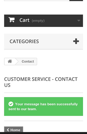

jetx Posted January 22, 2015 Share Posted January 22, 2015 Two stores, version 1.6.0.6 and version 1.6.0.9 (default templates). Both stores contact us forms are not sending emails when sending via mobile phone. Tested with iphone 4S, windows phone 8. Works on a Windows Surface, but not mobile phone. Tested over wifi and 4G. tested using both php mail and SMTP.When sending the form indicates "Your message has been successfully sent to our team". But this is not the case, not in spam box, the sender receives no notification, neither does the team (nor through BO).It just does not work. Can anybody confirm whether they can successfully send a contact us form via mobile phone?This is quite urgent as a good percentage of my customers are shopping via phone, so need a solution. Thanks in advance. 1 Link to comment Share on other sites More sharing options...

jetx Posted September 30, 2015 Author Share Posted September 30, 2015 Actually, just went back to using the built in contact form and see the problem still persists. In the exceptions log I see the following entries which I expect relate to the problem. *ERROR* 2015/09/30 - 10:12:48: Data too long for column 'user_agent' at row 1<br /><br /><pre>INSERT INTO `customer_message` (`id_employee`, `id_customer_thread`, `ip_address`, `message`, `file_name`, `user_agent`, `private`, `date_add`, `date_upd`, `read`) VALUES ('0', '15', '1854805572', 'Testing this module for issues', '', 'Mozilla/5.0 (Linux; Android 5.1.1; R7g Build/LMY47V) AppleWebKit/537.36 (KHTML, like Gecko) Chrome/45.0.2454.94 Mobile Safari/537.36', '0', '2015-09-30 10:12:48', '2015-09-30 10:12:48', '0')</pre> at line 765 in file classes/db/Db.php *ERROR* 2015/09/30 - 12:31:19: Field 'id_customer' doesn't have a default value<br /><br /><pre>INSERT INTO `ganalytics` (id_order, id_shop, sent, date_add) VALUES (8143, 1, 0, NOW())</pre> at line 765 in file classes/db/Db.php *ERROR* 2015/09/30 - 12:57:05: Data too long for column 'user_agent' at row 1<br /><br /><pre>INSERT INTO `customer_message` (`id_employee`, `id_customer_thread`, `ip_address`, `message`, `file_name`, `user_agent`, `private`, `date_add`, `date_upd`, `read`) VALUES ('0', '15', '1854805572', 'Testing this mesdage thing.', '', 'Mozilla/5.0 (Linux; Android 5.1.1; R7g Build/LMY47V) AppleWebKit/537.36 (KHTML, like Gecko) Chrome/45.0.2454.94 Mobile Safari/537.36', '0', '2015-09-30 12:57:05', '2015-09-30 12:57:05', '0')</pre> at line 765 in file classes/db/Db.php Link to comment Share on other sites More sharing options...
jetx Posted September 30, 2015 Author Share Posted September 30, 2015 So the fix for this issue, in case anyone else experiences it, is because too many characters are being entered via the useragent. The fix was to increase the varchar limit for user_agent from 128 to 256 in the customer_message table. Link to comment Share on other sites More sharing options...
