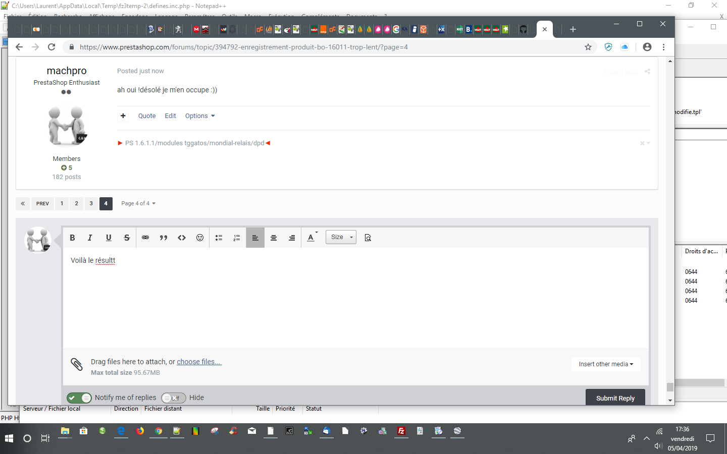

machpro Posted April 5, 2019 Share Posted April 5, 2019 Bonjour, Je viens de mettre à jour le fichier form tel que le préconise Eolia mais lorsque j'ouvre une page produit j'ai une erreur 500! est ce quelqu'un à le même problème avec une solution bien sur :)) Merci bonne fin d'apm à tous Link to comment Share on other sites More sharing options...
doekia Posted April 5, 2019 Share Posted April 5, 2019 1250 millions de milliards de trillions de fois répété. Activer le débug Link to comment Share on other sites More sharing options...
machpro Posted April 5, 2019 Share Posted April 5, 2019 ah oui !désolé je m'en occupe :)) Link to comment Share on other sites More sharing options...
machpro Posted April 5, 2019 Share Posted April 5, 2019 (edited) Voilà le résultat Edited April 5, 2019 by machpro (see edit history) Link to comment Share on other sites More sharing options...
machpro Posted April 5, 2019 Share Posted April 5, 2019 (edited) voilà le résultat Strict Standards: Declaration of Link::getProductLink() should be compatible with LinkCore::getProductLink($product, $alias = NULL, $category = NULL, $ean13 = NULL, $id_lang = NULL, $id_shop = NULL, $ipa = 0, $force_routes = false, $relative_protocol = false, $add_anchor = false) in /home/fle/public_html/override/classes/Link.php on line 0Fatal error: Uncaught --> Smarty Compiler: Syntax error in template "/home/fleurdes/public_html/fleu/themes/default/template/controllers/products/helpers/form/form.tpl" on line 54 "textarea.parent ( ' div ' ) .find ( ' span.counter ' ) .html ( ' <span style = "couleur: rouge;"> {ls = ' Maximum ' } ' + max + ' {ls = ' caractères ' }: ' + reste + ' </ span> ' );" - Unexpected " = ", expected one of: "}" <-- thrown in /home/fleu/public_html/tools/smarty/sysplugins/smarty_internal_templatecompilerbase.php on line 54 Edited April 5, 2019 by machpro (see edit history) Link to comment Share on other sites More sharing options...
doekia Posted April 5, 2019 Share Posted April 5, 2019 tu as visiblement raté quelque chose ( une } ) dans le code que tu as copié Par ailleurs tu as aussi une override "moche" concernant Link, mais ceci n'est pas lié. Link to comment Share on other sites More sharing options...
machpro Posted April 5, 2019 Share Posted April 5, 2019 J'ai fait un copier/coller du fichier sur le grib, je vais regarder ça merci encore pour ton aide bonne soirée Link to comment Share on other sites More sharing options...
machpro Posted April 5, 2019 Share Posted April 5, 2019 J'avais mal copié le fichier, ça fonctionne maintenant Merci beaucoup Link to comment Share on other sites More sharing options...
