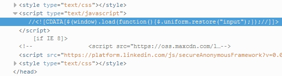

xiparos Posted January 16, 2015 Share Posted January 16, 2015 Hi Prestashop members, I don't quite understand why the following method does not work in Prestashop 1.6.0.9. I am trying to add javascript snippet into <head> tags by using hookHeader() in module, for example, public function hookHeader(){ $jscript = '<script type="text/javascript">//<![CDATA[$(window).load(function(){$.uniform.restore("input");});//]]></script>'; return $jscript; } By executing the module, I noticed that the returned javascript snippet has been included within <head> tags in webpage, like <head> ...... <script type="text/javascript"> //<![CDATA[$(window).load(function(){$.uniform.restore("input");});//]]> </script> </head> But this snippet doesn't work at all, however, after using the more traditional way to add js file, public function hookHeader() { // the js content has been put into main.js $this->context->controller->addJS(($this->_path).'js/main.js'); ....... } in html file, <head> <script type="text/javascript" src="/prestashop/module/test/js/main.js"></script> </head> It works as expected. Could you please tell me how should I do if I want to use the first way to include js snippet within <head> tag ? Thanks in advance. Link to comment Share on other sites More sharing options...

xiparos Posted January 16, 2015 Author Share Posted January 16, 2015 and what browser console spawns if you use first method? can you check it? Hi, Vekia, Thanks for your reply. I got no warning and error from console, since there is just one module installed in PS for test purpose. here is a screenshot of js snippet. Link to comment Share on other sites More sharing options...
