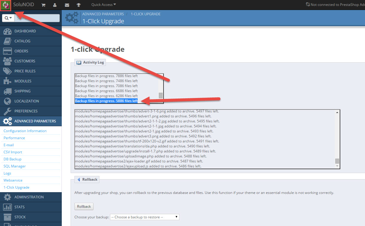

SoluNOiD Posted January 13, 2015 Share Posted January 13, 2015 (edited) Hi, I'm trying to upgrade from PS 1.6.0.9 to 1.6.0.11 via 1-click upgrade. But no matter what pc or mac i have tried and regardless of which browser, the upgrade stops while backing up at this point "Backup files in progress. 5886 files left" I had my MAC with a chrome browser running for 8 hours without any progress. The "wheel" of progress is removed from the screen at this point, and the only indication that the process is still running is the "wheel" in the upper left corner Se attached screendump Edited January 13, 2015 by SoluNOiD (see edit history) Link to comment Share on other sites More sharing options...
radler64 Posted April 11, 2015 Share Posted April 11, 2015 Hello, I am in exactly the same situation, except it is file number 7425 where it stops. I restartet it -> same behaviour. Versions are the same as above. Any suggestions in the meantime? Link to comment Share on other sites More sharing options...
safa Posted April 12, 2015 Share Posted April 12, 2015 Hello; i think you have php limit problem runtime, memory limit..etc you have to incest in php.ini i using xammp for my mac. for xammp php.ini url https://discussions.apple.com/thread/6125765 regards.. Link to comment Share on other sites More sharing options...
radler64 Posted April 12, 2015 Share Posted April 12, 2015 (edited) Hello and thanks for the reply. But as far as I understood, SoluNOiD and myself are not running the shop itself on a Mac, just the browser frontend. I am running my shop on a Linux system from a professional hoster. I have all the requirements for PHP set correctly, as far as the documentation gives it correct. What I did now because of time, is to run a separate backup via FTP to save my files before upgrading. Then I did an upgrade where I specified not to do a backup. This is a workarround for me. But I would wish, that the automated backup would work with the 1-click upgrade because it gives much more safetyness. So I would hope, that there are still some more suggestions... Thanks Dieter Edited April 12, 2015 by radler64 (see edit history) Link to comment Share on other sites More sharing options...
