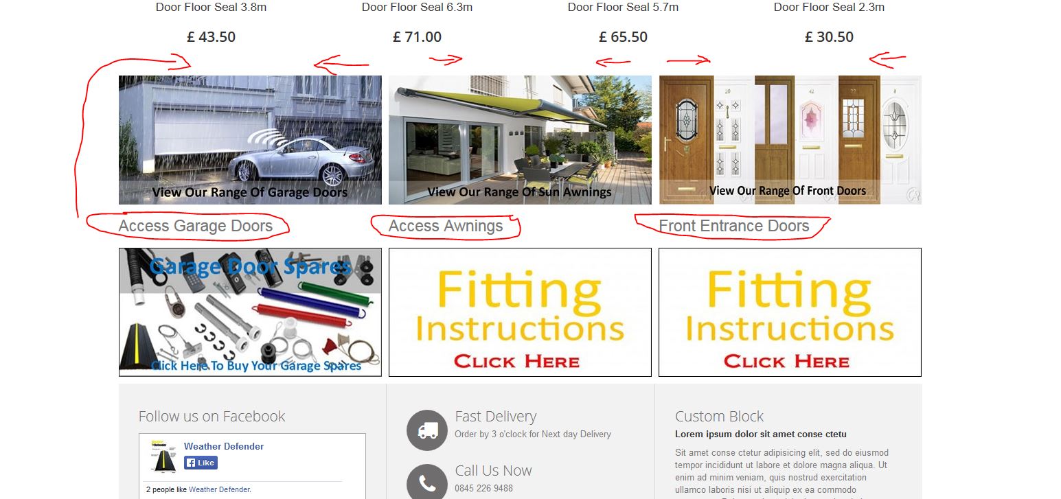

peter433 Posted January 9, 2015 Share Posted January 9, 2015 Hello, In Theme configurator where you have use title in front I want the title on top of the images not at the bottom. Any secret css or tweak for this.Please see attachment? Regards Peter Link to comment Share on other sites More sharing options...
ajaxthemestudios Posted January 9, 2015 Share Posted January 9, 2015 Hi, Using FTP, override the hook.tpl file located inside the themeconfigurator module (i.e. server/modules/themeconfigurator/views/templates/hooks/hooks.tpl) by copying the file to your theme module folder (i.e. server/themes/yourtheme/modules/themeconfigurator/views/templates/hooks/hooks.tpl). I hope you are familiar with this. If not you need to read about it. It will enable you to avoid editing the default file so that in the future when an update of that module is performed, you will not lose your change. Once this is done, edit the hook.tpl file in the theme module folder you created. Line 37 - 39 is the code for the image and line 40-42 is the code for the title. All you have to do is move the codes in line 40 - 42 before line 37 - 39. You need to backup your files before making changes to avoid problem in case you make a mistake. All the best! Link to comment Share on other sites More sharing options...
peter433 Posted January 9, 2015 Author Share Posted January 9, 2015 Hi, Using FTP, override the hook.tpl file located inside the themeconfigurator module (i.e. server/modules/themeconfigurator/views/templates/hooks/hooks.tpl) by copying the file to your theme module folder (i.e. server/themes/yourtheme/modules/themeconfigurator/views/templates/hooks/hooks.tpl). I hope you are familiar with this. If not you need to read about it. It will enable you to avoid editing the default file so that in the future when an update of that module is performed, you will not lose your change. Once this is done, edit the hook.tpl file in the theme module folder you created. Line 37 - 39 is the code for the image and line 40-42 is the code for the title. All you have to do is move the codes in line 40 - 42 before line 37 - 39. You need to backup your files before making changes to avoid problem in case you make a mistake. All the best! Hell, I can not see server/themes/yourtheme/modules/themeconfigurator/views/templates/hooks/hooks.tpl I am using default Peter Link to comment Share on other sites More sharing options...
ajaxthemestudios Posted January 9, 2015 Share Posted January 9, 2015 Hello "Server" is just a name I used for the root of your server. It is different for everybody. Replace it with yours "Your theme" is just a name I used for your theme's name. In this case, yours would be "default" Link to comment Share on other sites More sharing options...
