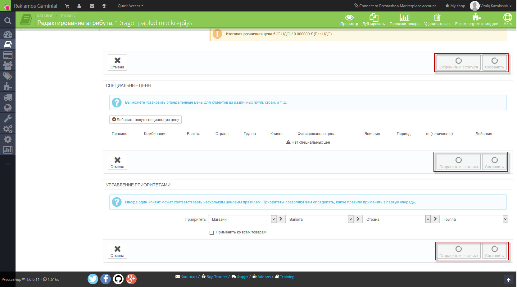

Vitalij Kazakevic Posted January 9, 2015 Share Posted January 9, 2015 Hello, after I upgraded my Prestashop v. 1.6.0.9 to v. 1.6.0.11, I fount problem - the button for saving (only in products) don't load (pls.find attached preview). Maybe somebody know how can I solve these problem? Thanks. Link to comment Share on other sites More sharing options...
NemoPS Posted January 9, 2015 Share Posted January 9, 2015 I'd suggest you to download the .11 package manually, grab all files under controllers/admin and re-upload them as fresh. See if it works. If not, try uploading the img folder as well, and the admin/themes as last resource as well 3 1 Link to comment Share on other sites More sharing options...

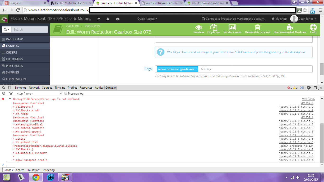

Guiom Posted January 19, 2015 Share Posted January 19, 2015 (edited) In the Chrome java console : Failed to load resource: net::ERR_CACHE_MISS /adminFolder/index.php?controller=AdminProducts&id_product=xxx&updateproduct&token=xxxxxxxxxxxxx I would guess that it's related to our problem somehow. But no clue what this means and how to fix. Anyone ? Edited January 19, 2015 by Guiom (see edit history) Link to comment Share on other sites More sharing options...

fazliddin Posted January 21, 2015 Share Posted January 21, 2015 Here is chrome console output: Uncaught SyntaxError: Unexpected identifier admin-products.js:690 Uncaught ReferenceError: languages is not defined /admin262btyanm/index.php?controller=AdminProducts&addproduct&token=71ecb05a219a54f7f8585f70fd66c2c9 Failed to load resource: net::ERR_CACHE_MISS 1 Link to comment Share on other sites More sharing options...
NemoPS Posted January 21, 2015 Share Posted January 21, 2015 Check the admin folder, this path: \themes\default\template\controllers\products\helpers\form\form.tpl Open the file and make sure you have var languages = new Array(); somewhere Link to comment Share on other sites More sharing options...
Guiom Posted January 21, 2015 Share Posted January 21, 2015 Hello, yes I do (see below in red). // if the tab has not already been loaded, load it now tabs_manager.display(id, true); tabs_manager.onLoad(id, function(){ $("#product-tab-content-"+id).show(0, function(){ $(this).trigger('displayed'); }); $("#link-"+id).addClass('active'); }); var languages = new Array(); if (btn_name == "Combinations") { $('#desc-product-new').hide(); $('#desc-product-newCombination').show(); populate_attrs(); } else if (btn_name == "Attachments") { handleSaveButtons(); } else { $('#desc-product-newCombination').hide(); // if pack is enabled, save button are visible only if pack is valid if ($("input[name=id_product]").val() != 0 || btn_name != 'Informations') handleSaveButtons(); } $('.label-tooltip').tooltip(); }); $(".productTabs a.active").click(); // disable save if Associations tab is not loaded if ($('#product-tab-content-Associations').hasClass('not-loaded')) disableSave(); tabs_manager.onLoad('Associations', function(){ if ($("input[name=id_product]").val() != 0) handleSaveButtons(); }); $('.confirm_leave').live('click', function(){ // Double quotes are necessary when the translated string has single quotes return confirm("{l s='You will lose all unsaved modifications. Are you sure that you want to proceed?' js=1}"); }); $('#toolbar-footer').appendTo($('#product-tab-content-Informations').children('.product-tab')); $('.product-tab-content').on('displayed', function(e) { $('#toolbar-footer').appendTo($(this).children('.product-tab')); }); }); Link to comment Share on other sites More sharing options...

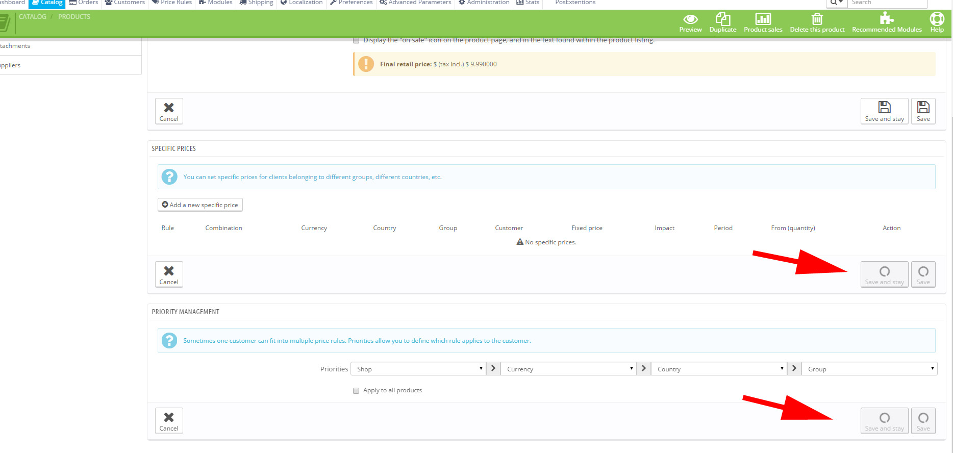

cille5 Posted January 24, 2015 Share Posted January 24, 2015 Same problem. Endelss Save button on product page. I made fresh prestashop install and still same problem. Link to comment Share on other sites More sharing options...
NemoPS Posted January 24, 2015 Share Posted January 24, 2015 I bet you'd end up having the error we all know if you rolled back. It seems to be server latency as it won't be ready till all tabs are loaded Link to comment Share on other sites More sharing options...

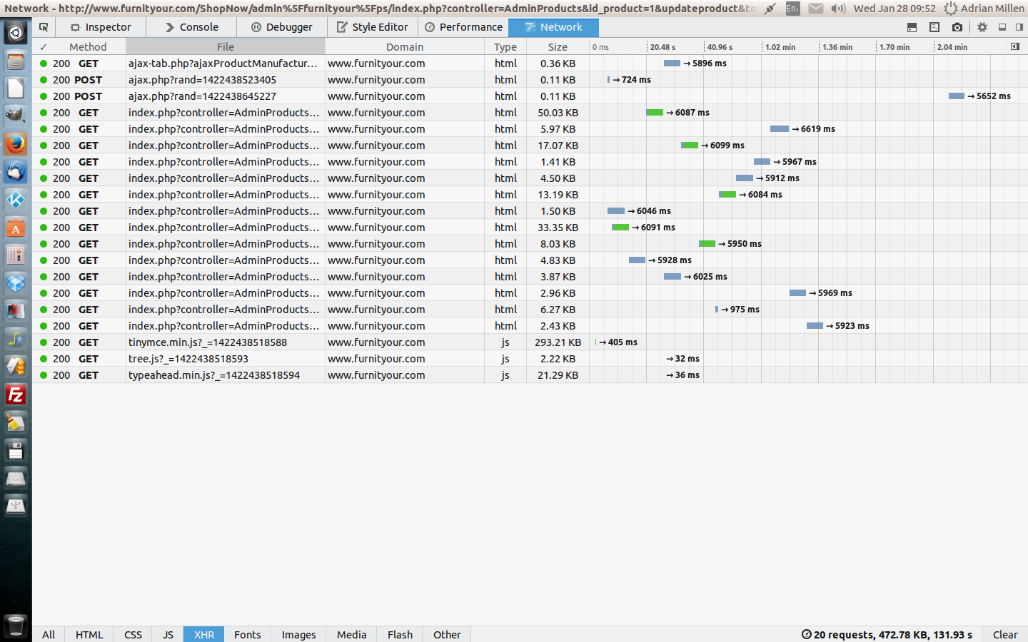

amillen Posted January 28, 2015 Share Posted January 28, 2015 Have attached screenshot although can't widen the tabs to give a full description. Can let you know what each one is if you need them. Link to comment Share on other sites More sharing options...

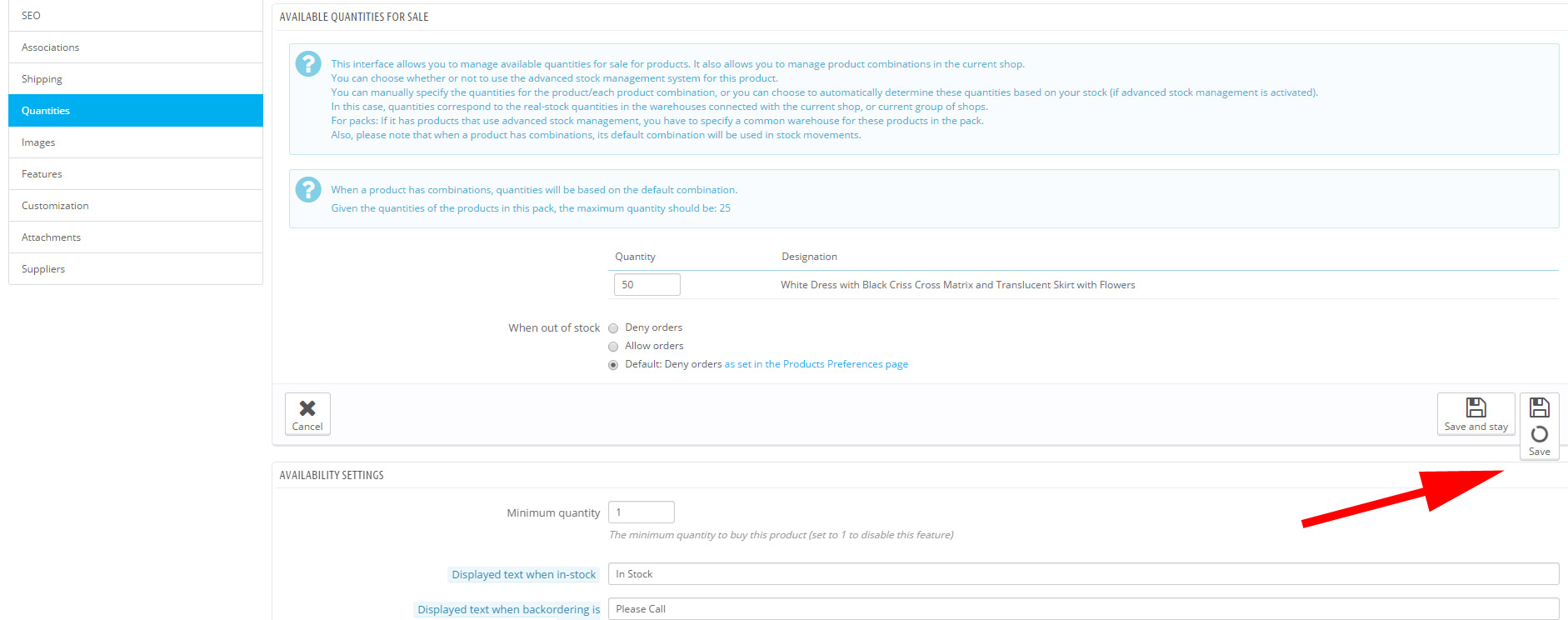

pindesign Posted January 30, 2015 Share Posted January 30, 2015 (edited) I thought I would share my notes on this matter because every other night I experiment with trying to solve this issue: about 10 hours of testing so far. Originally we had a 30 second delay without any cache/ or smarty cache enabled. 1) With smarty cache and CCC cut that down to 25 sec 2) Upgraded the server with APC cache as well as Googles mod_pagespeed cut the time down to 10 sec 3) Removed all Erros listed in Firebug (but still plenty of warnings) with no change. Oddly we had the same missing en-default-small.jpg in img/p/ as mentioned by jonah2494; I thought it was just us; now it might be a clue. 4) Prestashop debugging/profiling shows no errors or delays despite the obvious delay in the save button state. 5) Firebug shows no errors but the delay is running in jquery-1.11.0.min.js It looks to me like the ajax requests are waiting for the previous request to clear before proceeding to the next instead of happening all at the same time. I’m going to try and limit some of the requests when I get a chance. Edited January 30, 2015 by pindesign (see edit history) Link to comment Share on other sites More sharing options...

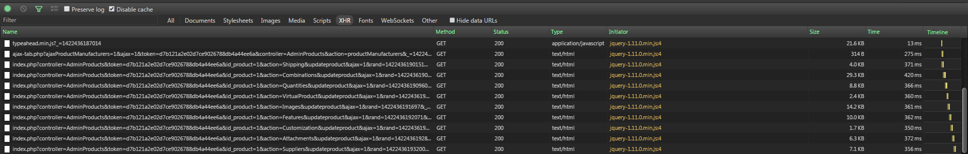

NemoPS Posted February 3, 2015 Share Posted February 3, 2015 Did you check the xhr table as mentioned before, to see which of the tabs takes longer to load? Link to comment Share on other sites More sharing options...
Andy1234 Posted February 3, 2015 Share Posted February 3, 2015 (edited) On 2/3/2015 at 11:52 AM, Nemo1 said: Did you check the xhr table as mentioned before, to see which of the tabs takes longer to load? Is that the message you posted on the 28th Jan about checking the network tab on the debug console? If so where is the debug console? All i really want to do for now is roll it back Edited February 3, 2015 by Andy1234 (see edit history) Link to comment Share on other sites More sharing options...

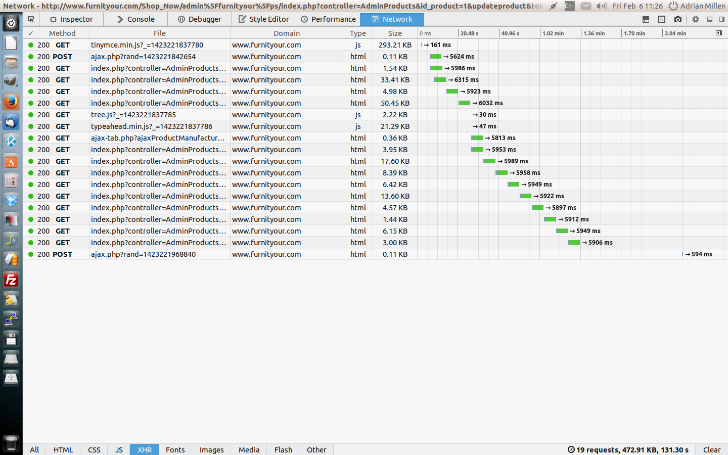

NemoPS Posted February 6, 2015 Share Posted February 6, 2015 Have a look at my tut here, can you identify the cause by following those steps? http://nemops.com/spinning-save-button-prestashop-1-6/#.VNSHdZ2jOr0 Link to comment Share on other sites More sharing options...
amillen Posted February 6, 2015 Share Posted February 6, 2015 On 2/6/2015 at 9:20 AM, Nemo1 said: Have a look at my tut here, can you identify the cause by following those steps? http://nemops.com/spinning-save-button-prestashop-1-6/#.VNSHdZ2jOr0 Thanks Nemo, Had a look through this and have attached current screenshot. The delay does not appear to be related to any modules and all seem to be the various tabs. Disable all overrides made no difference. Am I looking for particular modules to un-hook or hook as the case may be? Link to comment Share on other sites More sharing options...
NemoPS Posted February 7, 2015 Share Posted February 7, 2015 Wow, that's so damn slow. Try checking for all of the 'backoffice' hooks. Access the page, then use the browser's search (ctrl + F if you're on windows), look for 'backoffice', a couple will come up. See if there is anything relevant hooked there. Did you try a previous PS version on the same server? Link to comment Share on other sites More sharing options...
amillen Posted February 7, 2015 Share Posted February 7, 2015 On 2/7/2015 at 9:40 AM, Nemo1 said: Wow, that's so damn slow. Try checking for all of the 'backoffice' hooks. Access the page, then use the browser's search (ctrl + F if you're on windows), look for 'backoffice', a couple will come up. See if there is anything relevant hooked there. Did you try a previous PS version on the same server? Yip, it sure is slow. Have only one instance of backoffice and that is displaybackoffice header. This has 5 modules hooked to it and I un-hooked them all, made no difference. Have been running PS from 1.5.x.x and it is only since the upgrade that it has ground to a halt. I could live with the link_rewrite error compared to this, this is soooo frustrating. Link to comment Share on other sites More sharing options...
