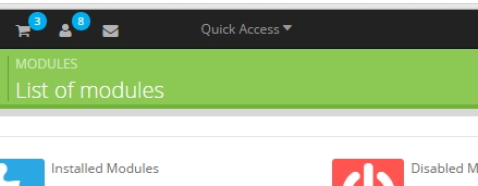

HH Services Limited Posted January 11, 2015 Author Share Posted January 11, 2015 Hi, the signs in BO to tell when a new customer or new order come will not turn off after checking on them. Usually after clicking on them they shut down but they started not shutting down all of a sudden and without installing or updating anything new. Any idea of why and how to fix this problem? Thanks. ps1.jpg Days later and it is still on the same issue... signs will not go off on two shops that I have.... Suggestions please!!! Link to comment Share on other sites More sharing options...

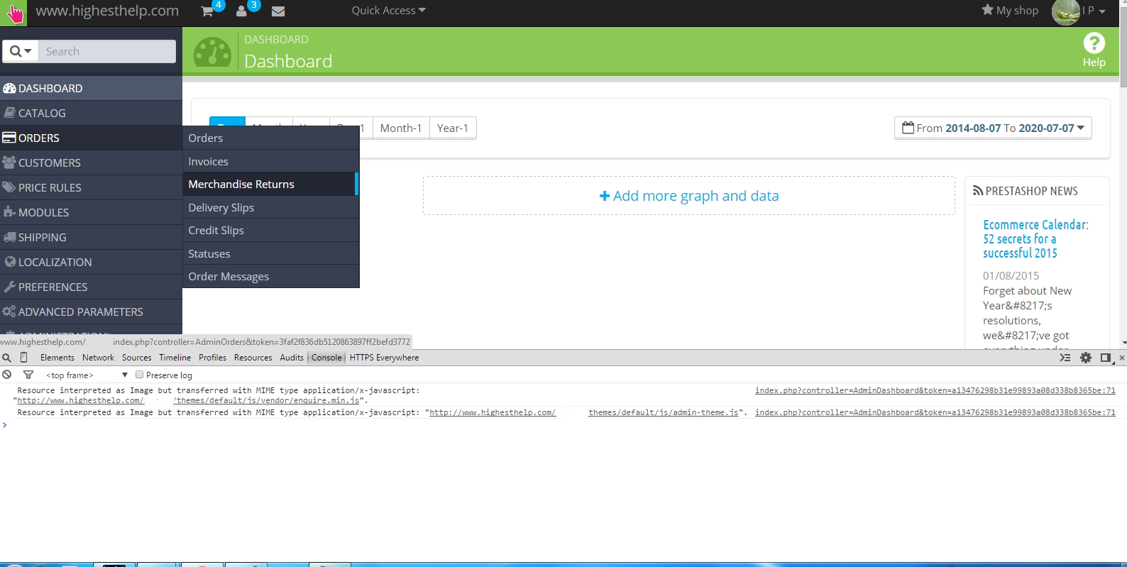

vekia Posted January 11, 2015 Share Posted January 11, 2015 it's quite impossible that console contains nothing. it should contains many reports. case needs inspection. take a look, console report: Link to comment Share on other sites More sharing options...
HH Services Limited Posted January 11, 2015 Author Share Posted January 11, 2015 it's quite impossible that console contains nothing. it should contains many reports. case needs inspection. take a look, console report: This is what I get: Link to comment Share on other sites More sharing options...

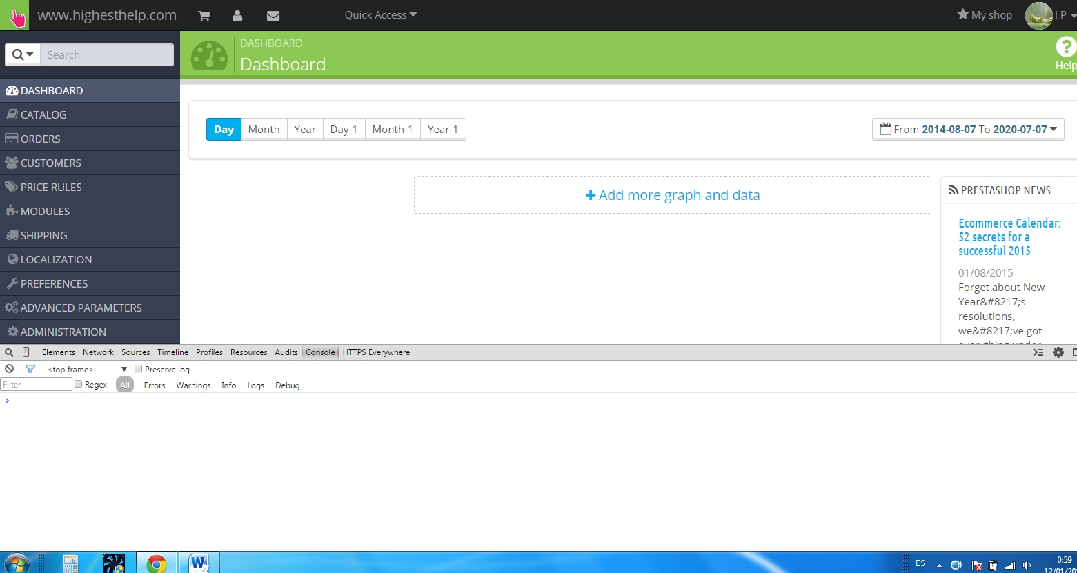

vekia Posted January 11, 2015 Share Posted January 11, 2015 click on: then make sure that "ALL" is selected. after that try to click on buttons: Link to comment Share on other sites More sharing options...
HH Services Limited Posted January 11, 2015 Author Share Posted January 11, 2015 (edited) click on: then make sure that "ALL" is selected. after that try to click on buttons: I did several times and nothing happens... Lights come back right on after reloading the page.... Any other suggestions?? Edited January 11, 2015 by De La Riviere (see edit history) Link to comment Share on other sites More sharing options...
vekia Posted January 11, 2015 Share Posted January 11, 2015 this is not a fix to your problem but a way to get detailed report in your console as long as it will not work like mine, it will be not possible to help we have to know ajax call status, and if it will be okay, ajax call response. Link to comment Share on other sites More sharing options...
HH Services Limited Posted January 12, 2015 Author Share Posted January 12, 2015 I don´t get nothing.... What can be wrong? Link to comment Share on other sites More sharing options...

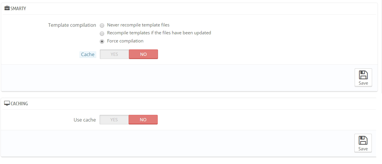

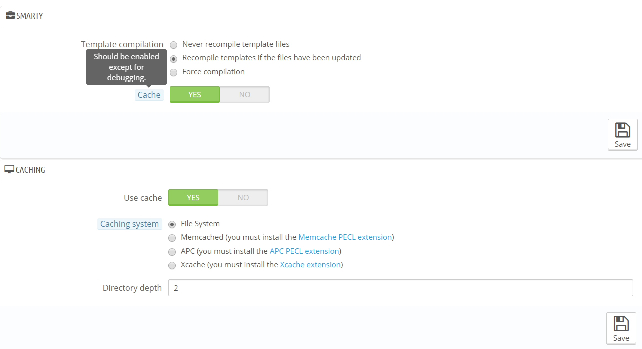

HH Services Limited Posted January 16, 2015 Author Share Posted January 16, 2015 i have no idea can i inspect it directly in your back office? if you want i can do it. Vekia, I erroneously discarded the cache issue because I had cleared cache and I thought that it should be enough. However, after I saw that I could not update the currency rates,I made the following changes and the signs went off at the same time that the currency rates were updated in the front office: I fixed it by going from: to: My question now is if after moving everything back to how it was, I did the right thing. Please note that my shared server does not support Memcached so I was using 2 file system cache as it shows in the first snapshot... was this right? By the way, I recently discover Teamviewer which it is great for remote assistance...Works great!! Link to comment Share on other sites More sharing options...
