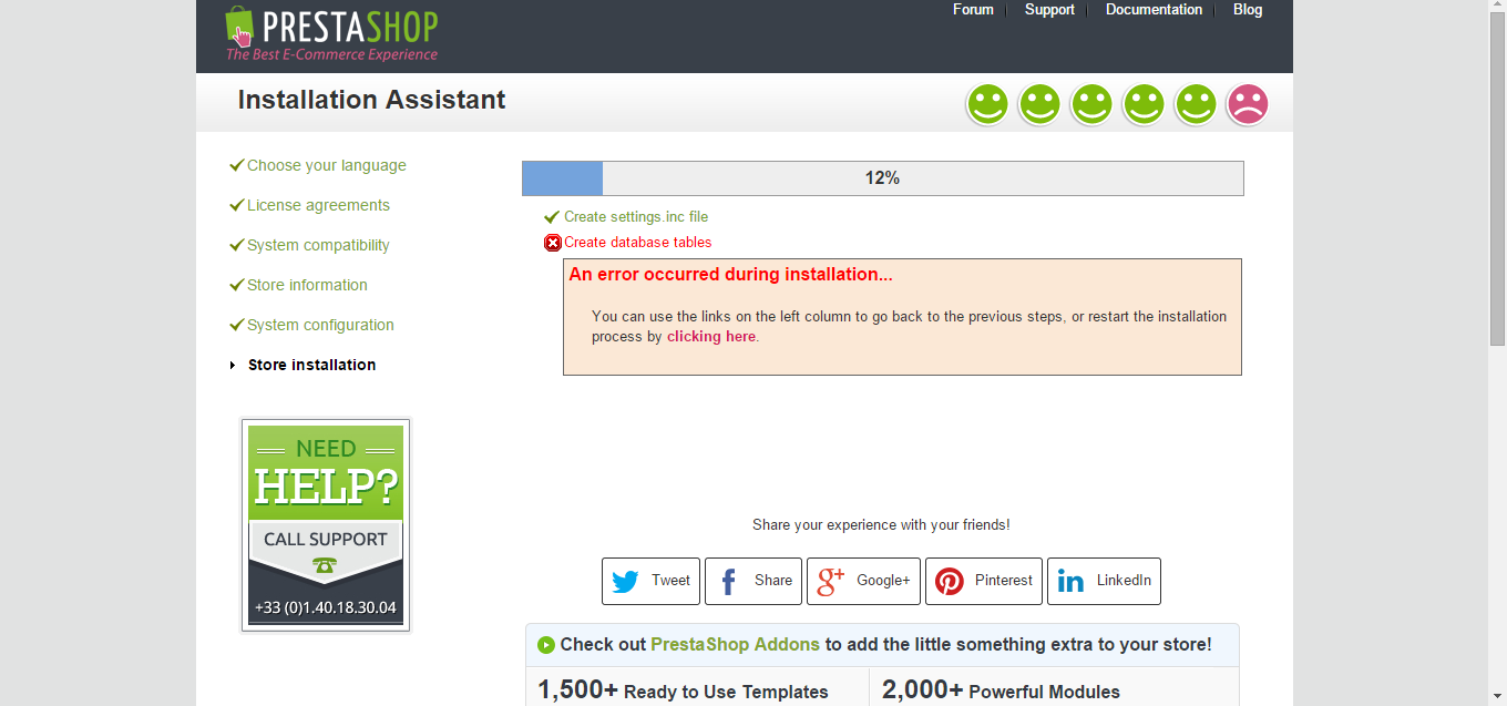

EvoCrome Posted January 7, 2015 Share Posted January 7, 2015 HelloI'm trying to install PrestaShop at my website. Unfortunately, every attempt I made was unsuccessful.I'd be glad if someone can help me about getting this issue resolved.Thank You Admin; EvoCrome Apps Link to comment Share on other sites More sharing options...
mytheory. Posted January 8, 2015 Share Posted January 8, 2015 Hi, Since this is a fresh install and its hanging on the database, I would ask your host to see if there are any errors in your mysql logs. Or there may be a setting (ie. mod_security) that may be blocking certain queries from being executed/inserted into your db. Also, I am on the prior step, you inputted your db details correctly AND clicked the test connection button. HTH! Link to comment Share on other sites More sharing options...
Dreamtheme Posted January 8, 2015 Share Posted January 8, 2015 This error is if you tried to install it twice and DB is populated, the real problem that i got with 1.6.0.11 is this one. No problem with 1.6.0.9. 1 Link to comment Share on other sites More sharing options...
Tung at RockPOS.com Posted January 9, 2015 Share Posted January 9, 2015 That's true. Drop all the tables in the database and try again. Cheers, Tung Link to comment Share on other sites More sharing options...
Steppo Posted January 9, 2015 Share Posted January 9, 2015 -- First all my thought and love goes to the kind people in France for the sad happening in Paris and also my friends there. My very sad heart are with you.-- Hello! I experience exactly the same issue. I have tried all i know with Mamp Pro and webdev skills. The installer creates all the database tables but stops when starting to put content into the tables as it seems. I would like to do a coommand line install and are following the exact procedure according to prestashop and have also looked thru everything as explains in the guides. Funny i have previous installations of prestashop running on the same server/ localhost. I will not try online server and if working copy it back to localhost. I wonder if or what i have missed.. Would be great if anyone at Prestashop could have look into this. 1 Link to comment Share on other sites More sharing options...
Dreamtheme Posted January 9, 2015 Share Posted January 9, 2015 -- First all my thought and love goes to the kind people in France for the sad happening in Paris and also my friends there. My very sad heart are with you.-- Hello! I experience exactly the same issue. I have tried all i know with Mamp Pro and webdev skills. The installer creates all the database tables but stops when starting to put content into the tables as it seems. I would like to do a coommand line install and are following the exact procedure according to prestashop and have also looked thru everything as explains in the guides. Funny i have previous installations of prestashop running on the same server/ localhost. I will not try online server and if working copy it back to localhost. I wonder if or what i have missed.. Would be great if anyone at Prestashop could have look into this. They already did, see http://forge.prestashop.com/browse/PSCSX-4249 and make those changes, this will fix it. 1 Link to comment Share on other sites More sharing options...
Steppo Posted January 9, 2015 Share Posted January 9, 2015 Ok great thanks for the update...! Very good! They already did, see http://forge.prestashop.com/browse/PSCSX-4249 and make those changes, this will fix it. Link to comment Share on other sites More sharing options...
Steppo Posted January 9, 2015 Share Posted January 9, 2015 Alright a little update. Now installed on localhost Mamp Pro. I used PHP 5.6.2 together with individual php version for each host. After changing this to use same php version to all hosts and instal using 5.2.17 installation went thru perfect with non changed installation package from Prestashop (1.6.0.11). After installation i have reverted back for my host and so far this seems ok. Hope this help anyone. Link to comment Share on other sites More sharing options...

Dreamtheme Posted January 20, 2015 Share Posted January 20, 2015 They already did, see http://forge.prestashop.com/browse/PSCSX-4249 and make those changes, this will fix it. Read this, also read the comments and implement those changes. If you do it should be ok. Or wait for ps 1.6.0.12 it will be out in Feb., and this will be fixed. 1 Link to comment Share on other sites More sharing options...
