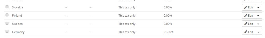

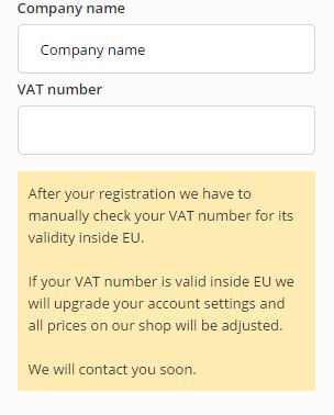

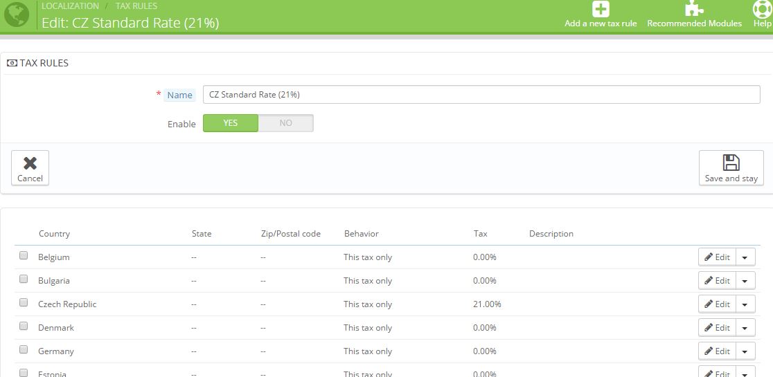

ALbi87 Posted January 2, 2015 Share Posted January 2, 2015 (edited) Hi all, after couple days I found a way how to go around with this very painful issue. In detail: I am a seller inside EU (Czech Republic) and because I sell VAT registered and non-VAT registered customers all over the World, there is couple scenarios that can happen: A - Customer inside CZ (Czech republic) - company VAT registered > VAT 21% B - Customer inside CZ (Czech republic) > VAT 21% C - Customer inside EU - VAT registered > VAT 0% D - Customer inside EU - non-VAT registered > VAT 21% E - Customer outside EU (whole world) > VAT 0% but he has to pay fees after arrival of the products to his country Great sources cvering VAT issues: https://ecommerce.shopify.com/c/shopify-discussion/t/european-vat-and-taxes-1315 What I needed to do was to create a flow for all of my possible customers without any paid module or major hard coding. I tried almost everything I could find but nothing worked perfectly. So I decided to tweak it a little bit: 1. Registration - I inform customers that I will manually check theirs VAT number (which I am supposed to do anyway for all European customers). I tried official module, but that seems very tricky to me and I am not completely sure whether that stuff works or not. So I decided to inform my customers in this way: 2. I installed free module which informs me by an email that new customer has registered and I whould check his VAT (http://www.prestashop.com/forums/topic/294459-free-module-customer-registration-admin-alerts-email-when-new-registration/) 3. Localization > Taxes : I set up one tax which is suitable for my needs = 21% 4. Localization > Tax rules: Here is the magic - Because Tax rules are written the way they are you need to distinguish customers by different countries. I have only one TAX rule named "CZ Standard Rate (21%)" and inside it are all countries I can supply to. In short there is my setting: A - Czech republic - 21% B - Czech republic - 21% that was easy. C - e.g. Germany - 0% (I have more customers VAT-registered so its is easier for me this way) D - e.g. Germany. - 21% - For this instance you need to add NEW COUNTRY which is complete identical to Germany above except the name which could be "hiscountrywiththedotattheend" etc. For this country you set up different TAX rules and when you detect non-VAT customer from this country you manually change his country from registration (e.g. Germany) to (Germany.) and that is it. E - same as C ------------ After receive an email: Are they from EUROPE? YES Are they from Czech republic? YES Is there a VAT number? YES Is it VALID inside EU? YES - Customer A - I will set him to Customer group for companies so he can see proper prices (without TAX) but I will Tax him during order process NO - Customer B (no setting) NO - Customer B (no setting) NO Is there a VAT number? YES Is it VALID inside EU? YES - Customer C - I will set him to Customer group for companies so he can see proper prices (without TAX) and thanks to TAX rules, he is set up fot 0% VAT. NO - Customer D - Manually change his country to "country." which has proper VAT in Tax rules (so he sees Tax incl. and is taxed by 21%) NO - Customer D - Manually change his country to "country." which has proper VAT in Tax rules (so he sees Tax incl. and is taxed by 21%) NO // they are from outside EUCustomer E - I dont care if its a company or not because everything is setup with 0% VAT. ----------- Yes, everything is done manually, it is not perfect, but it works like a charm. So if you need any help with that let me know If anybody found something more efficient, please let me know;) Martin Edited January 2, 2015 by ALbi87 (see edit history) 3 Link to comment Share on other sites More sharing options...
