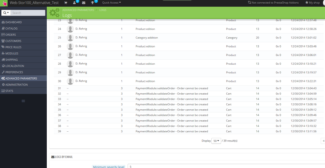

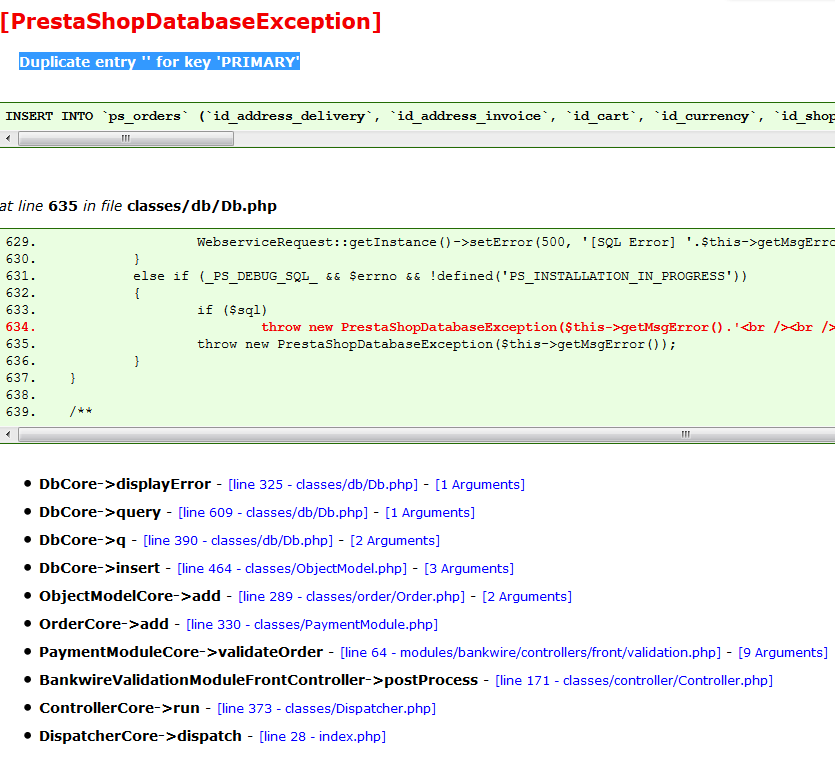

Reshkil Posted January 2, 2015 Share Posted January 2, 2015 I am developing an application using Prestashop's webservices. Here is what has happened, making some scripts for the webservice I was checking data in different loops and had to change the max_execution_time in php ini from 30 to 900 (this was a dummy number just to see if it worked). Afterwards I couldn't make new orders using the webpage, I tried to do it on the database using phpmyadmin but I get the error 500 (I attached 2 screenshots of the error and the admin dashboard). Does anyone have any idea what could be the problem? I can't make any new order because of the Duplicate entry '' for key 'PRIMARY' error. Isn't the primary key for the ps_orders table id_order which should be entered blank because of the auto increment attribute? Here is what i tried to do to troubleshoot the problem: I did the same test with a new installation and it worked just fine. I tried to repair and optimize the ps_orders table and couldn't because it is a InnoDB type table. I changed the table to MyISM, repaired it, optimized it and then turned it back to InnoDB. It didn't solve the problem. I dropped the table and created it again, then I tried to insert new rows and had the same error. If you have any information that can help me I will appreciate it. Thank you, Link to comment Share on other sites More sharing options...

Reshkil Posted January 5, 2015 Author Share Posted January 5, 2015 Hi Bellini13, The problem is that the duplicate entry comes as blank ''. The primary key for the ps_orders table is id and it is a autoincrement field, that is why the queries go blank with the id, so the database will set the id. Does anyone know why is it throwing the error with a blank id? Thank you Link to comment Share on other sites More sharing options...
Reshkil Posted January 5, 2015 Author Share Posted January 5, 2015 Hi Enrique, I am using the normal webstore in PrestaShop and making the order as an end user to test why it is not working. On the developers error screen I only see 1 query, how can I know if it is firing more than once? I have the Firebug on my Firefox to check the network tasks and only 1 request is sent. Link to comment Share on other sites More sharing options...
