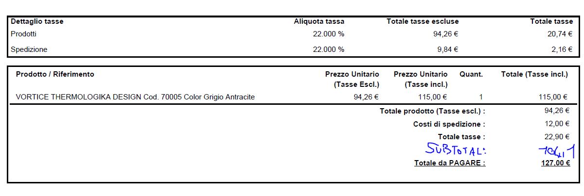

Hello guys, i made my layout invoice... trust me isn't easy at all for a noob, but when i'll do some money i'll buy m4 pdf extension cause i think that it's the best module for pdf...
anyways, i can't understand how i can put the subtotal ( product + shipment )
in the attached files you can see.
I'd like to have, at the end, just
Subtotal : 104.10
Taxes:   22.90
Total to pay :  127.00
what kind of variable i've to use?
Thanks for your support

Try something like (not tested):
{assign var="subtotal" value="`$order_invoice->total_products+$order_invoice->total_shipping_tax_excl`"}
{displayPrice currency=$order->id_currency price=$subtotal}
