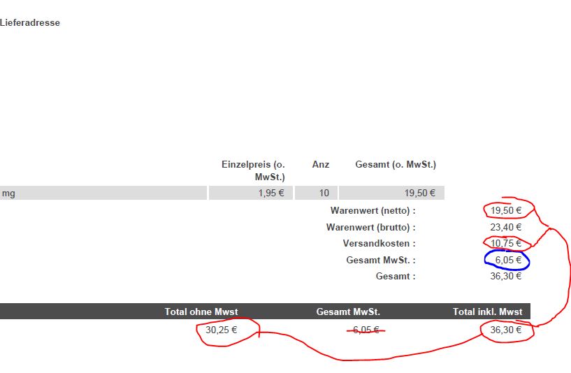

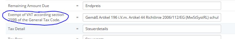

kalua Posted December 21, 2014 Share Posted December 21, 2014 Hey all Unfortunately I still have not found any solutions to my problem, but step by step. My shop should run for both client groups. Enduser that pays tax and dealer that does not. Therefor I made "two groups". Visitor,Guest,Costumer as basic that shows up tax and a dealer group without tax. These I fixed up in the BO Costumer/Groups. While everything is running fine in the cart, I have the tax showing up in the invoice for the B2B Customers which should not. Furthermore I have to add a special sentence at the end for the B2B clients which is stored in Localisation/Translations/PDF-Translations. You can find it in the attached file: But how can I do that? Or which variable will be responsible for that part? Thanks for any help Kind regards Link to comment Share on other sites More sharing options...

kalua Posted December 22, 2014 Author Share Posted December 22, 2014 Hey Tuk66 Thanks for your reply. As told above I have to groups. One incl. tax for Visitor,Guest and Consumer. This will show up great in the cart and also in the invoice. The second group are B2B Clients with European TAX-ID that don't pay tax as they provide a UID. These second group I fixed up in the BO Costumer/Groups that prices are Tax excluded. Furthermore this B2B-Client have a VAT/UID Number in the adress field. That all works find in the cart, but not in the invoice. As can see attached, the blue marked amounts should be delete so that only the correct sum to pay appears, in this case 30,25. I'am from Austria, but selling to B2B clients the have UID Thanks for your help Link to comment Share on other sites More sharing options...
