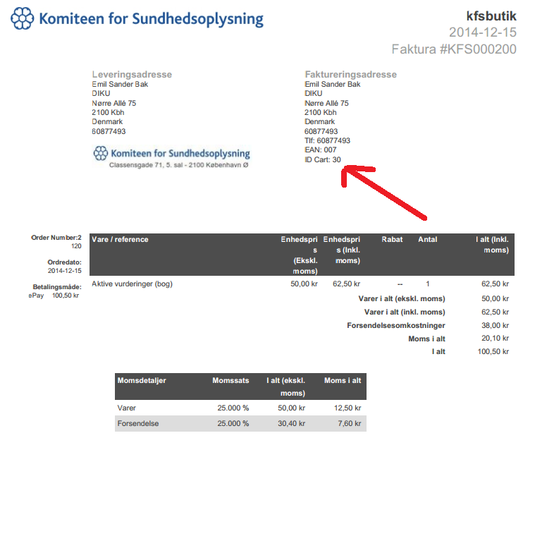

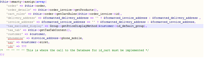

Thraundil Posted December 16, 2014 Share Posted December 16, 2014 ** Help request ** The problem: I can't seem to get "id_cart" (from ps_orders) to show up in the PDF invoice :/ I'm not very good with Prestashops way of interacting with the database, though i am a "okay" programmer. I've created the plot in invoice.tpl where it should be, and even tested that i works with other database-calls, but i can't seem to get "id_cart" in any way.. Even tried making a DB statement with "Select" and "From" and all, but then i had a problem with the "where" part.. Attatched is the picture of where i've made place for the id_cart, and the part of the code where i have to make the database call (That i keep failing at) tl:dr Need help to make a database call, to get "id_cart" from "ps_orders", for a given PDF invoice/order I dearly hope someone here might be able to help! Link to comment Share on other sites More sharing options...
eleazar Posted December 16, 2014 Share Posted December 16, 2014 You don't have to make a database call. Think different! You just need the variable for the id_cart. Use this code directly in your invoice.tpl: {l s='ID Cart: '}{$order->id_cart} That's all. 1 Link to comment Share on other sites More sharing options...
