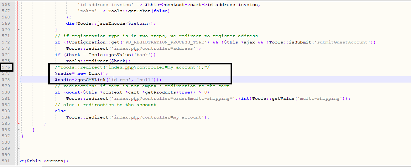

nadie Posted December 11, 2014 Share Posted December 11, 2014 (edited) Así tengo el código. La versión que utilizo es la 1.5.3.1.[/size] Linea 576 de tu version de Prestashop tienes esto: (Me acabo de bajar la 1.5.3.1 para ver el fichero) // if registration type is in two steps, we redirect to register address if (!Configuration::get('PS_REGISTRATION_PROCESS_TYPE') && !$this->ajax && !Tools::isSubmit('submitGuestAccount')) Tools::redirect('index.php?controller=address'); if ($back = Tools::getValue('back')) Tools::redirect($back); Tools::redirect('index.php?controller=my-account'); Si lo dejas asi: // if registration type is in two steps, we redirect to register address if (!Configuration::get('PS_REGISTRATION_PROCESS_TYPE') && !$this->ajax && !Tools::isSubmit('submitGuestAccount')) Tools::redirect('index.php?controller=address'); if ($back = Tools::getValue('back')) Tools::redirect($back); $nadie= new Link(); Tools::redirect($nadie->getCMSLink('id_cms', 'null')); Adjunto Imagen Edited December 11, 2014 by nadie (see edit history) Link to comment Share on other sites More sharing options...

nadie Posted December 11, 2014 Share Posted December 11, 2014 (edited) Sigue mostrando la página para registrarse de nuevo. Copio el código. // Avoid articles without delivery address on the cart $this->context->cart->autosetProductAddress(); Hook::exec('actionCustomerAccountAdd', array( '_POST' => $_POST, 'newCustomer' => $customer )); if ($this->ajax) { $return = array( 'hasError' => !empty($this->errors), 'errors' => $this->errors, 'isSaved' => true, 'id_customer' => (int)$this->context->cookie->id_customer, 'id_address_delivery' => $this->context->cart->id_address_delivery, 'id_address_invoice' => $this->context->cart->id_address_invoice, 'token' => Tools::getToken(false) ); die(Tools::jsonEncode($return)); } // if registration type is in two steps, we redirect to register address if (!Configuration::get('PS_REGISTRATION_PROCESS_TYPE') && !$this->ajax && !Tools::isSubmit('submitGuestAccount')) Tools::redirect('index.php?controller=address'); if ($back = Tools::getValue('back')) Tools::redirect($back); /*Tools::redirect('index.php?id_cms=8&controller=cms');*/ $nadie= new Link(); Tools::redirect($nadie->getCMSLink('8', 'null')); // redirection: if cart is not empty : redirection to the cart if (count($this->context->cart->getProducts(true)) > 0) Tools::redirect('index.php?controller=order&multi-shipping='.(int)Tools::getValue('multi-shipping')); // else : redirection to the account else Tools::redirect('index.php?controller=my-account'); } } } } } Muchisimas gracias. La tengo configurada con Estándar. En ese codigo que pegas, depende cambiar lo que he dicho, prueba cambiar el: else Tools::redirect('index.php?controller=my-account'); por else { $nadie= new Link(); Tools::redirect($nadie->getCMSLink('2', 'null')); } (Creo que anda por la linea 582) Edito: Recuerdo que estamos haciendo pruebas sobre el fichero original, una vez que se compruebe que funcione, lo ideal es hacer un override xD Edited December 11, 2014 by nadie (see edit history) Link to comment Share on other sites More sharing options...

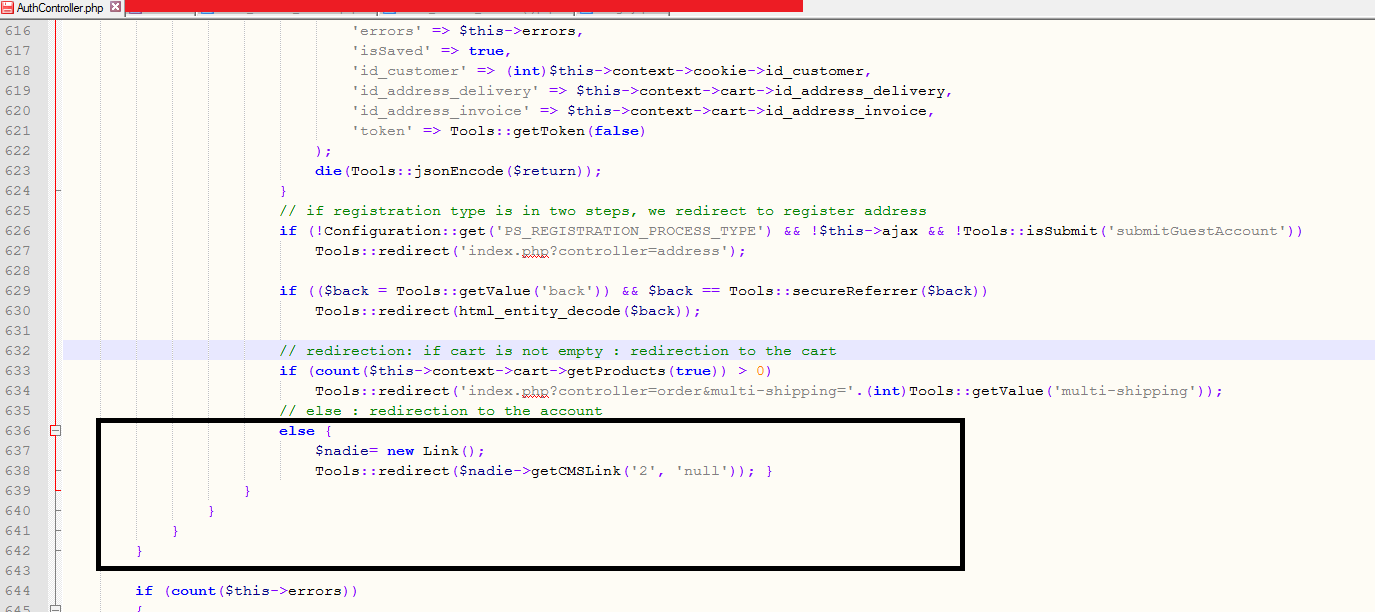

nadie Posted December 15, 2014 Share Posted December 15, 2014 Fijate que yo te dije el colocar el codigo en un sitio diferente a que lo habias puesto tu. ¿Lo has puesto en el "else" que te dije (solo en ese sitio)? Te adjunto imagen Link to comment Share on other sites More sharing options...
noranova Posted December 15, 2014 Author Share Posted December 15, 2014 Bueno pues ya lo tengo todo solucionado. Al final no me ha quedado otra que repasarme todo el código de principio a fin, entenderlo y probar. Os explico el problema y la solución: Lo que buscaba era que un usuario se registrara y al registrarse se mostrara un mensaje diciendo que su solicitud sería revisada, de forma que la cuenta no se activaba, debe hacerlo el administrador. La solución (o mejor dicho mi solución) ha sido introducir el siguiente código en la línea 636 aproximadamente, dentro de protected function updateContext(Customer $customer) y antes del comentario // if register process is in two steps, we display a message to confirm account creatio: $nadie= new Link(); Tools::redirect($nadie->getCMSLink('8', 'validacion')); También en algunas líneas arriba de el nuevo código hay un: $this->context->cookie->logged = 1; Cambiamos el valor y lo ponemos a 0: $this->context->cookie->logged = 0; Por último he cambiado todos los: $customer->active = 1; Por: $customer->active = 0; No se si habré sido demasiado "burro" con algo, pero así funciona sin problemas. Gracias a todos los que habéis aportado. Un saludo. Link to comment Share on other sites More sharing options...
