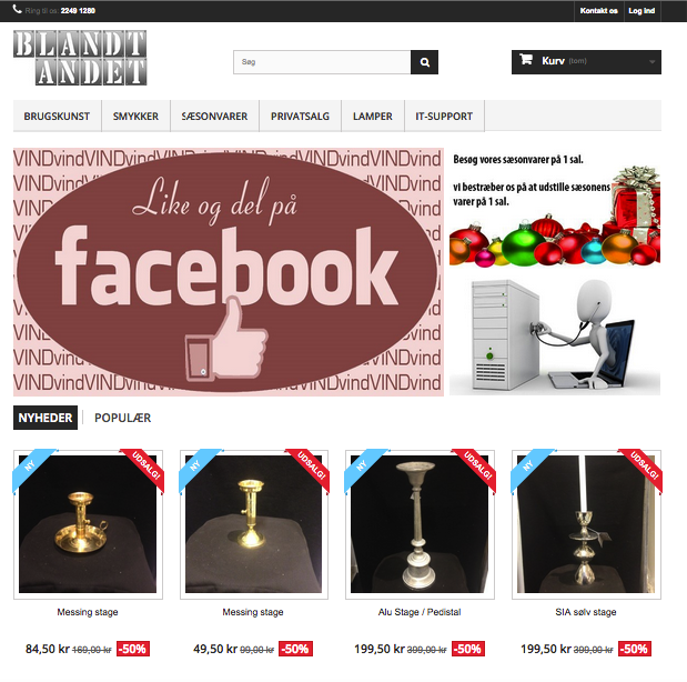

zizadk Posted January 31, 2015 Share Posted January 31, 2015 Hi Pascal I cant access back office same problem No input file specified. i would be super happy if you can c anything in the file if i send you a ftp login. and i promis to make a backup next time :-) Ziza Link to comment Share on other sites More sharing options...
