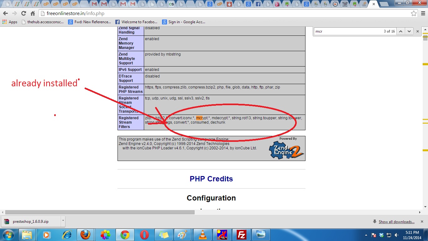

JoelWebsites Posted November 24, 2014 Share Posted November 24, 2014 I have installed mcrypt on the server but it is not showing on my prestashop ...how to load it properly? I have added memcache but that worked fine without any issues...thanks Please refer the screenshorts Link to comment Share on other sites More sharing options...
tuk66 Posted November 24, 2014 Share Posted November 24, 2014 Does it work? It can be just an informative message. Link to comment Share on other sites More sharing options...

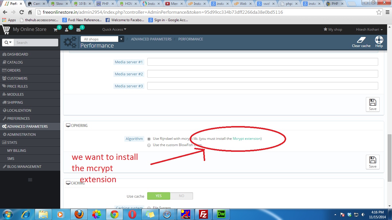

parsifal Posted November 28, 2014 Share Posted November 28, 2014 From PS .1.6.0.9 controllers/admin/AdminPerformanceController.php:449 array( 'id' => 'PS_CIPHER_ALGORITHM_1', 'value' => 1, 'label' => $this->l('Use Rijndael with mcrypt lib.').(!function_exists('mcrypt_encrypt') ? '' : $warning_mcrypt) ), it looks like a check is being done to decide whether to display the warning. joel, how exactly did you install the mcrypt extension on your server? Also, in the phpinfo output, scroll down a bit more. Do you see something like the first screenshot in this article? Link to comment Share on other sites More sharing options...

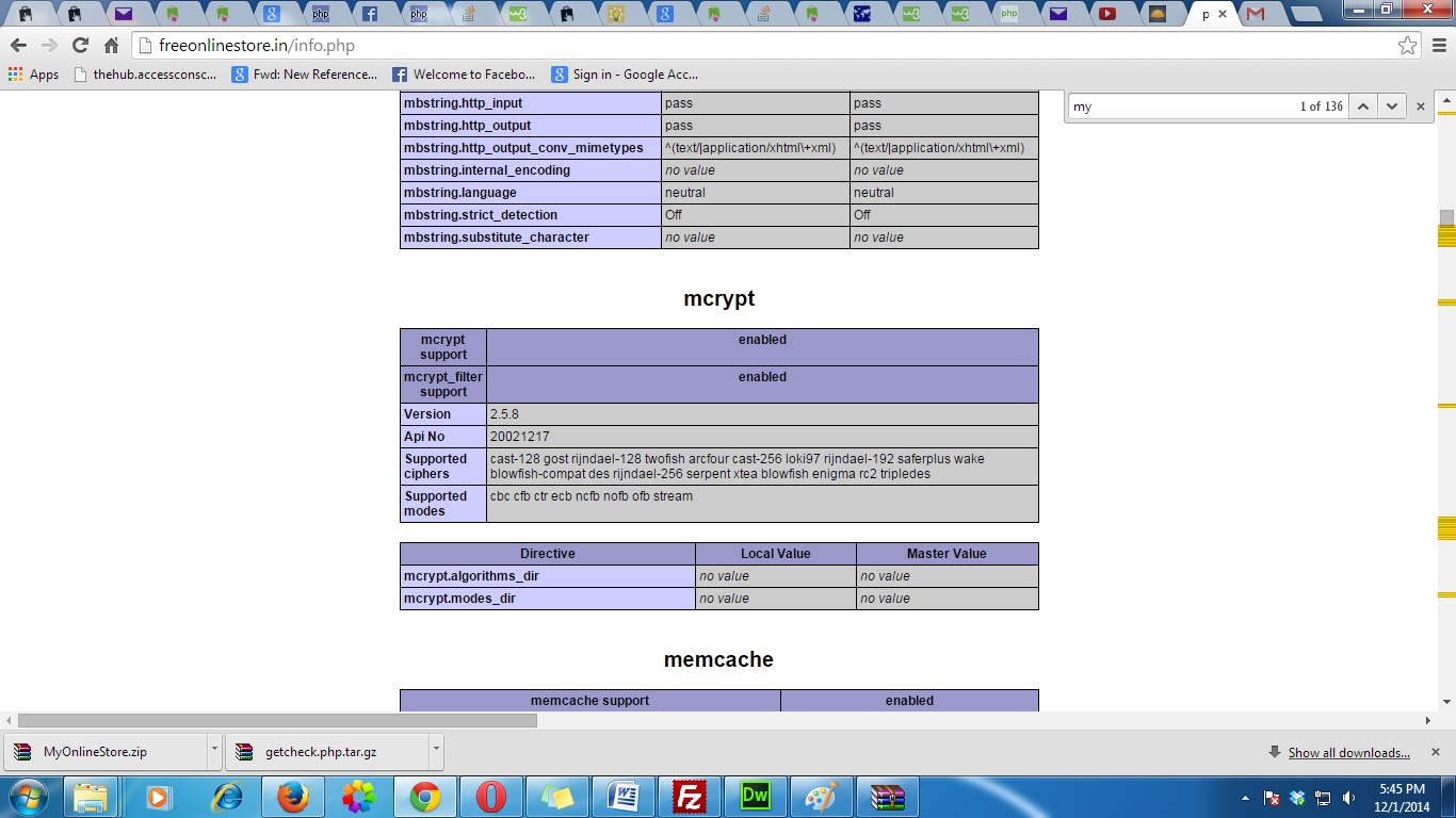

JoelWebsites Posted December 1, 2014 Author Share Posted December 1, 2014 Yes here is the screenshort Link to comment Share on other sites More sharing options...
bellini13 Posted December 1, 2014 Share Posted December 1, 2014 I had used amazon server i had used sudo yum install memcached in ssh and then you need to load the dynamic extension on the php.ini you can even contact your hosting provider to get this done .. And that is not an infomative message are we talking about memcache? or are we talking about mcrypt? According to your screen shot, it appears that mcrypt is installed and enabled, however for some unknown reason the mcrypt_encrypt function is not being found. Maybe a bug in the php version you are using? Or maybe the AWS server has some sort of security configured to avoid providing this information. function_exists('mcrypt_encrypt') Are you having an issue logging into the back office and front office? If you are not having issues, then it sounds like mcrypt is working properly, and you can just ignore this 'notice'. Alternatively, you can change the function_exists statement to use a different mcrypt function during the test. One that might be located? Link to comment Share on other sites More sharing options...

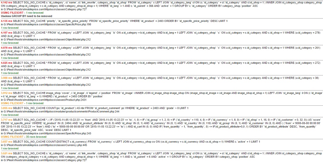

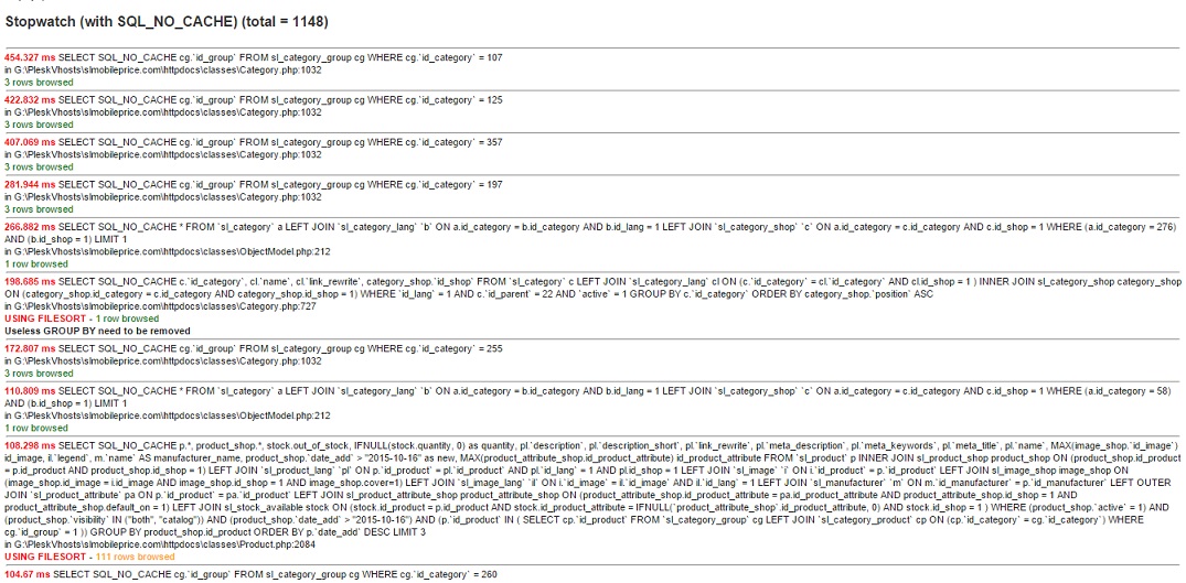

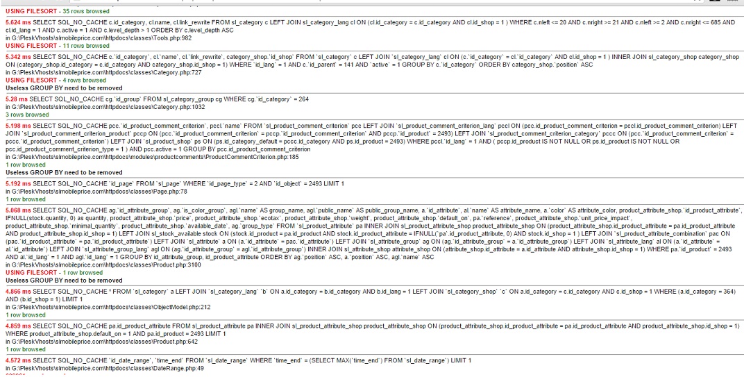

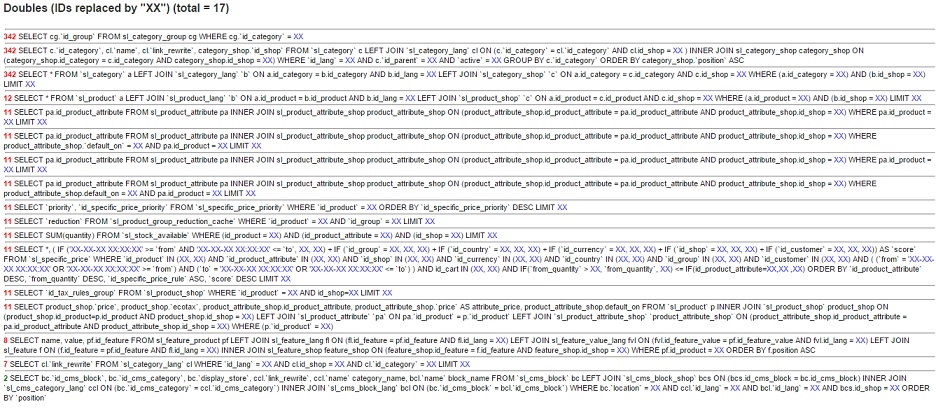

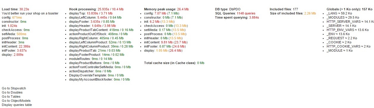

somits1 Posted November 5, 2015 Share Posted November 5, 2015 thanks for reply but where i have to do this? Also after enabling debug mode getting these error as my site running too slow, taking 10 sec to load.. check screen shot. Link to comment Share on other sites More sharing options...

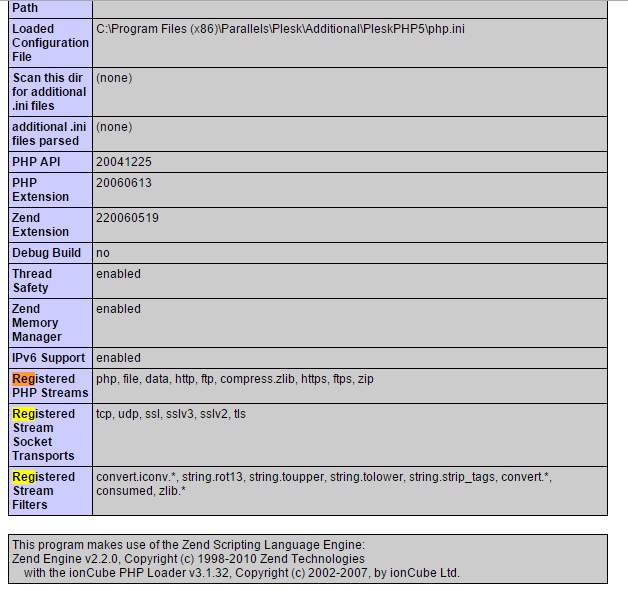

somits1 Posted November 5, 2015 Share Posted November 5, 2015 I have checked and i think mcrypt not installed so could you please tell me how to install mcrypt extension, for prestashop 1.5.6 , using godaddy Hosting. check php info in image. Link to comment Share on other sites More sharing options...
bellini13 Posted November 6, 2015 Share Posted November 6, 2015 I already answered your question. You should contact your hosting provider. Link to comment Share on other sites More sharing options...
