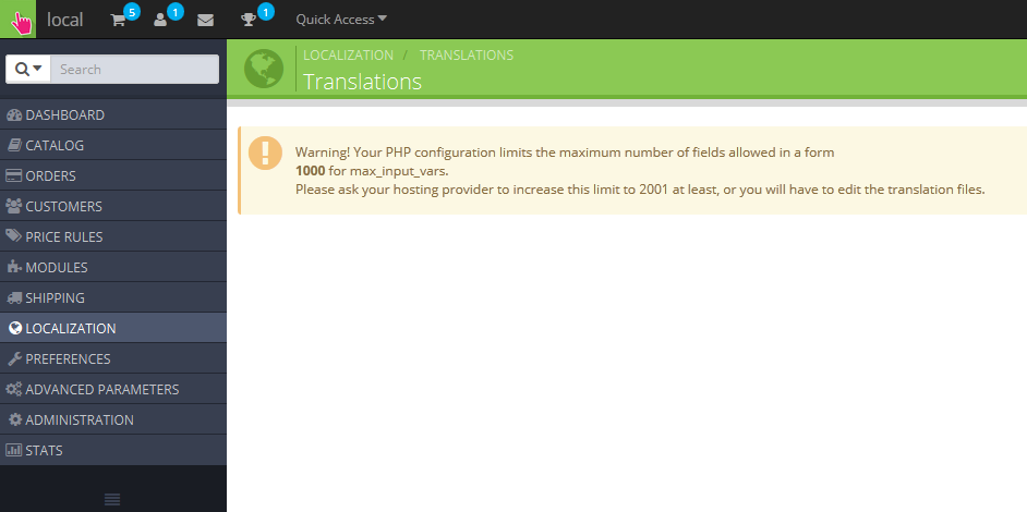

Craze18 Posted November 12, 2014 Share Posted November 12, 2014 (edited) Hello guys.I am using cPanel and having a problem with php and the error is "Warning! Your PHP configuration limits the maximum number of fields allowed in a form: 1000 for max_input_vars.Please ask your hosting provider to increase this limit to 1952 at least, or you will have to edit the translation files. " My hosting provider made the php setting changes but the result remain same. Same error. Is there anyone who can show me some light? Any help on that issue will be highly anticipated. Thanking you. Edited November 12, 2014 by Craze18 (see edit history) Link to comment Share on other sites More sharing options...

mickeyboy1 Posted November 13, 2014 Share Posted November 13, 2014 I have the same issue in 1.6.0.9 on localhost If i try to choose anything other than Front-office translations in localization/translations then i also get this error I have my max_input_vars in php.ini set to 100000 Link to comment Share on other sites More sharing options...
