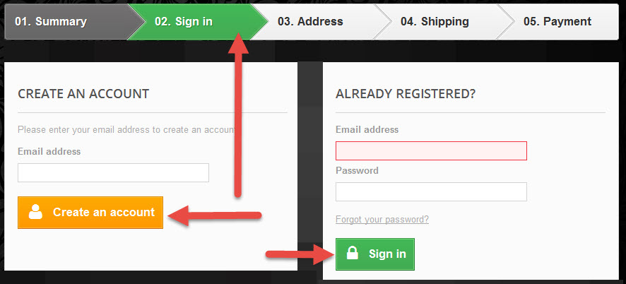

TechCov Posted November 12, 2014 Share Posted November 12, 2014 Anyone who can assist me how can i change the following button colors, i have marked them with RED ARROW signs. I have tried to change using global.css but it is just changing the border (top, bottom, left, right) but not the main background color of buttons Any advices how can i achieve the required colors changing these default ones thanks Link to comment Share on other sites More sharing options...
Leap-IT Posted November 12, 2014 Share Posted November 12, 2014 Hi id look in global.css in the themes folder. look for something button-medium exclusive for the yellow button and button-medium for the green Link to comment Share on other sites More sharing options...
vekia Posted November 12, 2014 Share Posted November 12, 2014 On 11/12/2014 at 12:56 PM, TechCov said: Anyone who can assist me how can i change the following button colors, i have marked them with RED ARROW signs. I have tried to change using global.css but it is just changing the border (top, bottom, left, right) but not the main background color of buttons Any advices how can i achieve the required colors changing these default ones thanks 1) order breadcrumbs: global.css line 6687 ul.step li.step_current span { color: white; text-shadow: 1px 1px #208931; border: 1px solid; border-color: #73ca77 #74c776 #74c175 #74c776; position: relative; } + line 6678 ul.step li.step_current { font-weight: bold; background: #42b856; background: -moz-linear-gradient(top, #42b856 0%, #43ab54 100%); background: -webkit-gradient(linear, left top, left bottom, color-stop(0%, #42b856), color-stop(100%, #43ab54)); background: -webkit-linear-gradient(top, #42b856 0%, #43ab54 100%); background: -o-linear-gradient(top, #42b856 0%, #43ab54 100%); background: -ms-linear-gradient(top, #42b856 0%, #43ab54 100%); background: linear-gradient(to bottom, #42b856 0%, #43ab54 100%); filter: progid:DXImageTransform.Microsoft.gradient(startColorstr='#42b856', endColorstr='#43ab54',GradientType=0); border-color: #399b49 #51ae5c #208931 #369946; } 1 Link to comment Share on other sites More sharing options...
Leap-IT Posted November 18, 2014 Share Posted November 18, 2014 (edited) as you can see the button has a gradient effect on it so its not a single color statment that you will find in the css but a few lines that look like this background-image: -webkit-gradient(linear, 50% 0%, 50% 100%, color-stop(0%, #fdaa02), color-stop(100%, #fe9702)); background-image: -webkit-linear-gradient(top, #fdaa02, #fe9702); background-image: -moz-linear-gradient(top, #fdaa02, #fe9702); background-image: -o-linear-gradient(top, #fdaa02, #fe9702); background-image: linear-gradient(top, #fdaa02, #fe9702); } a quick way to override this would be to add a background-color value to the appropriate element for the yellow button you could change this line: (you will lose the gradient style but the background color will change) lets just make it red for example .button.button-medium.exclusive span { border-color: #fec133 #febc33 #feb233 #febc33; } to this .button.button-medium.exclusive span { border-color: red red red red ;background-color:red; } for the green button look for this .button.button-medium span { display: block; padding: 10px 10px 10px 14px; border: 1px solid; border-color: #74d578; } change to this .button.button-medium span { display: block; padding: 10px 10px 10px 14px; border: 1px solid; border-color: red; background-color:red;} play also with the following for mouse over .button.button-medium.exclusive:hover (yellow button) and .button.button-medium:hover (green button) hope this is helpfull Edited November 18, 2014 by Leap-IT (see edit history) 1 Link to comment Share on other sites More sharing options...
Leap-IT Posted November 18, 2014 Share Posted November 18, 2014 Ok i just played around and you could also do the following: look for .button.button-medium { font-size: 17px; line-height: 21px; color: white; padding: 0; font-weight: bold; background: #43b754; background: -moz-linear-gradient(top, #43b754 0%, #41b757 2%, #41b854 4%, #43b756 6%, #41b354 38%, #44b355 40%, #45af55 66%, #41ae53 74%, #42ac52 91%, #41ae55 94%, #43ab54 96%, #42ac52 100%); background: -webkit-gradient(linear, left top, left bottom, color-stop(0%, #43b754), color-stop(2%, #41b757), color-stop(4%, #41b854), color-stop(6%, #43b756), color-stop(38%, #41b354), color-stop(40%, #44b355), color-stop(66%, #45af55), color-stop(74%, #41ae53), color-stop(91%, #42ac52), color-stop(94%, #41ae55), color-stop(96%, #43ab54), color-stop(100%, #42ac52)); background: -webkit-linear-gradient(top, #43b754 0%, #41b757 2%, #41b854 4%, #43b756 6%, #41b354 38%, #44b355 40%, #45af55 66%, #41ae53 74%, #42ac52 91%, #41ae55 94%, #43ab54 96%, #42ac52 100%); background: -o-linear-gradient(top, #43b754 0%, #41b757 2%, #41b854 4%, #43b756 6%, #41b354 38%, #44b355 40%, #45af55 66%, #41ae53 74%, #42ac52 91%, #41ae55 94%, #43ab54 96%, #42ac52 100%); background: -ms-linear-gradient(top, #43b754 0%, #41b757 2%, #41b854 4%, #43b756 6%, #41b354 38%, #44b355 40%, #45af55 66%, #41ae53 74%, #42ac52 91%, #41ae55 94%, #43ab54 96%, #42ac52 100%); background: linear-gradient(to bottom, #43b754 0%, #41b757 2%, #41b854 4%, #43b756 6%, #41b354 38%, #44b355 40%, #45af55 66%, #41ae53 74%, #42ac52 91%, #41ae55 94%, #43ab54 96%, #42ac52 100%); filter: progid:DXImageTransform.Microsoft.gradient(startColorstr='#43b754', endColorstr='#42ac52',GradientType=0 ); border: 1px solid; border-color: #399a49 #247f32 #1a6d27 #399a49; -webkit-border-radius: 0; -moz-border-radius: 0; border-radius: 0; } then go to this site http://www.colorzilla.com/gradient-editor/ just replace the code in red with the one copied from the generator to the css element do this for .button.button-medium { ........... .button.button-medium:hover { ........... .button.button-medium.exclusive { ........... .button.button-medium.exclusive:hover { notice the not all buttons change the color on hover sometimes just the border so look at the code have fun 1 Link to comment Share on other sites More sharing options...
TechCov Posted November 18, 2014 Author Share Posted November 18, 2014 Thanks a lot vekia and Leap-it. Leap-it Thanks dude I Really appreciate your concerns. Link to comment Share on other sites More sharing options...
