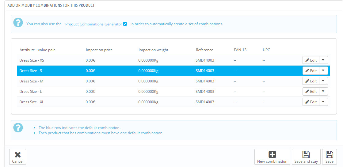

But, when i open the product page (pressing "More" button) the message displayed is
"This combination does not exist for this product. Please select another combination."
It is strange all the combinations are exhausted as all the quantities against each size is not in stock any more. it should just display "Out of Stock".
What should i have to do???????

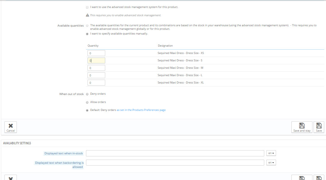

Yes it's default template and an upgrade from ver 1.6.0.5, cache cleared
I want it to display "product out of stock" than "the combination does not exist for this product. Please select another combination" as all the combinations have zero products
