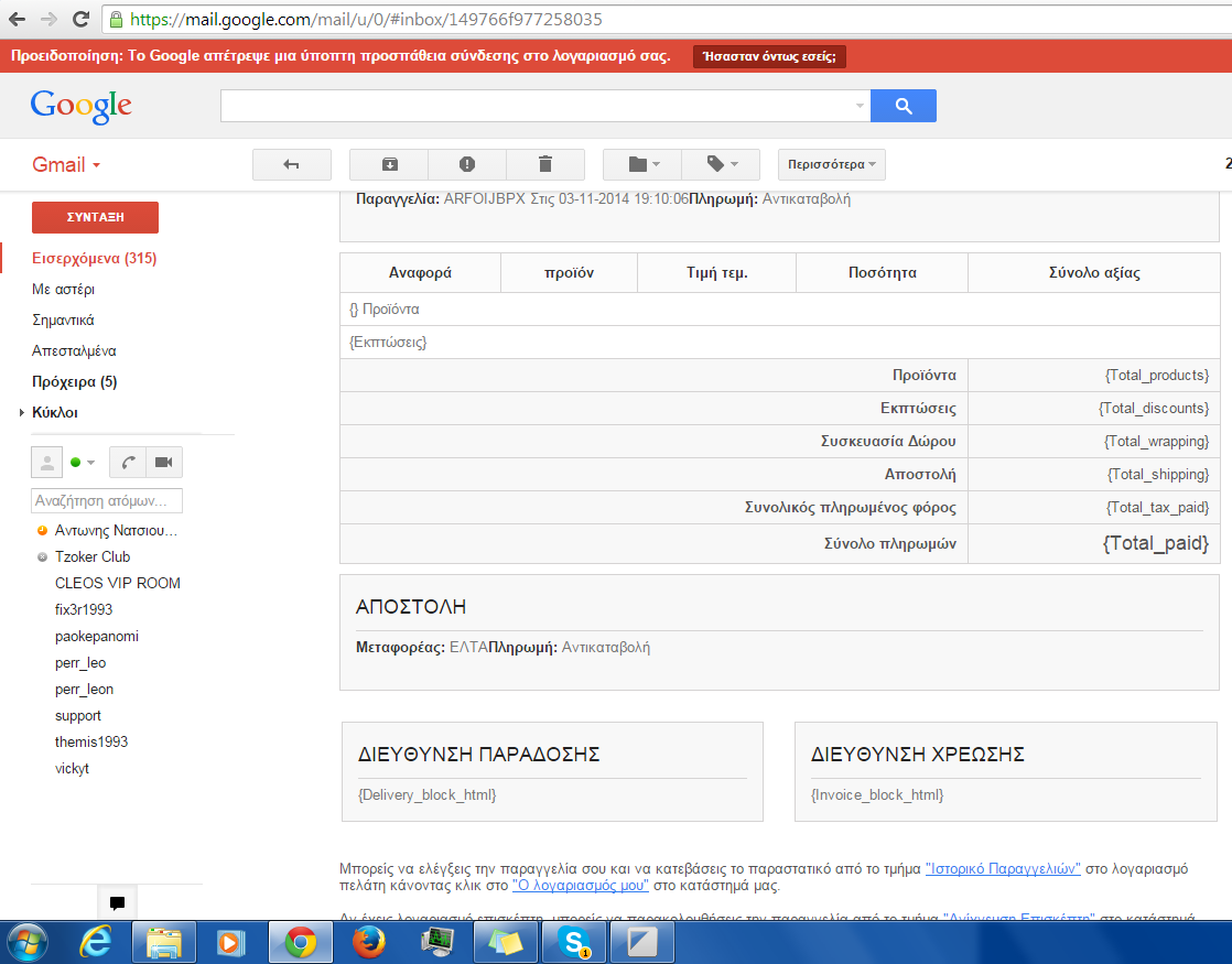

tsalas77 Posted November 3, 2014 Share Posted November 3, 2014 When a costumer make an order and takes the confirmation mail with the order the attribues in the email don't work look at the photo i uploaded and tell me if you know what it is to fix it (the language is Greek) Link to comment Share on other sites More sharing options...

FullCircles Posted November 4, 2014 Share Posted November 4, 2014 If you open up the following file: mail/el/order_conf.html Then try having a compare of one of the working sections, to one of the ones not working. I can see that the order reference and date are fine, and they should look similar to this </span> {order_name} (Greek) {date}<br /> Then compare to one of the sections below {Total_products} The issue may be that the total_products section has a capitalised first letter.. but it could be that googlemail is applying auto styling to that, so might not. It should be {total_products} though, so if it doesn't look like that, then it will need changing. If that's not the case, if you can upload and attach that file here, will take a look over it Link to comment Share on other sites More sharing options...
