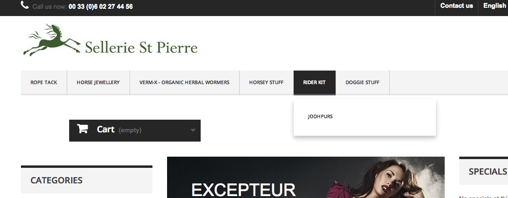

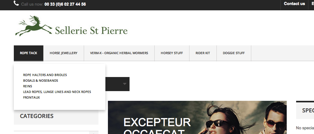

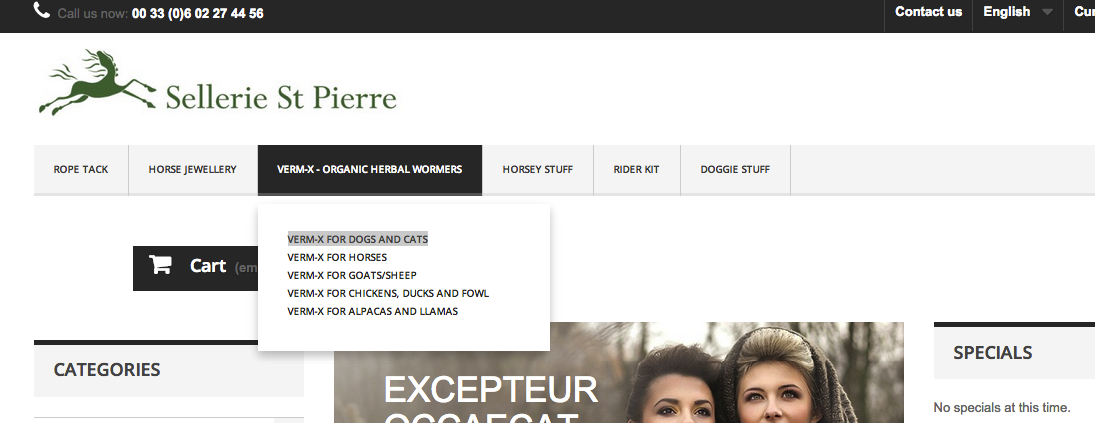

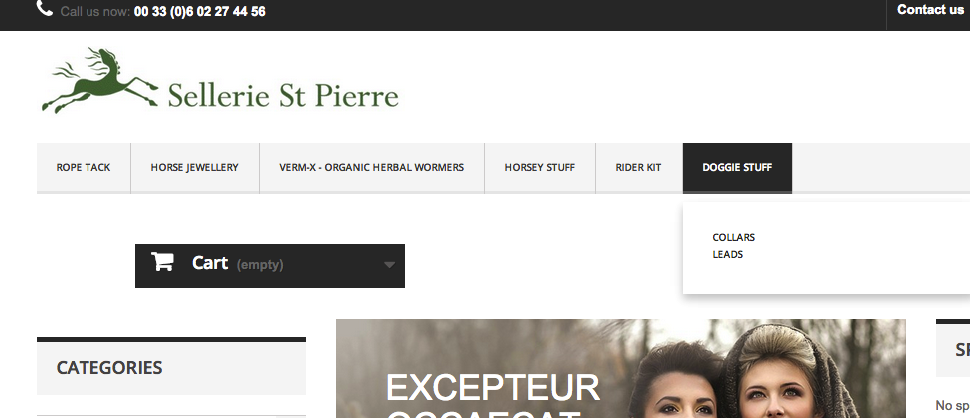

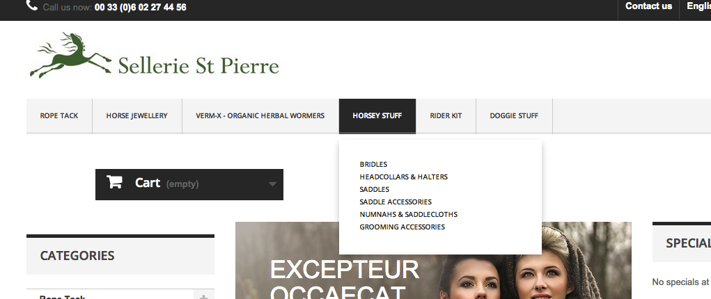

PascalVG Posted November 11, 2014 Share Posted November 11, 2014 Marrone, re-try my suggestions in post #2, and add one more change to the same file (line 138) , to make the submenu hang directly below the top menu item you open: .sf-menu > li > ul { padding: 26px 30px 31px; width: 25%; left: inherit; // <-- add this line } Result: as you see, smaller fonts for the menus/submenus and items below each other. Hope this is what you wanted pascal. Link to comment Share on other sites More sharing options...
