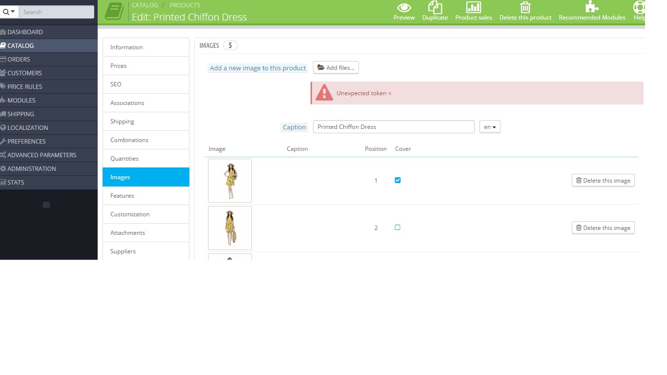

manson84 Posted October 26, 2014 Share Posted October 26, 2014 Dear all, I am unable to upload product images - images turn out to be a grey question mark. After turning on the debug mode, it shows "Unexpected token <" on the product page (see screenshot attached). I searched for similar issues like mine and tried their methods but so far nothing works. Such as this: http://www.prestashop.com/forums/topic/290297-uploading-products-images-issues/ The Img folder have been set to writable recursively. This is a show-stopper and I'm desperate to get this fixed soon. Any [spam-filter] please help? - Chris Link to comment Share on other sites More sharing options...

manson84 Posted October 29, 2014 Author Share Posted October 29, 2014 F12 > Console tab Hi, it's showing: Failed to load resource: the server responded with a status of 503 (temporarily overloaded) http://mywebsite.com/img/p/en-default-cart_default.jpg Failed to load resource: the server responded with a status of 500 (Internal Server Error) http://mywebsite.com/admin/index.php?controller=AdminProducts&toke…cd53bd05abb9&ajax=1&id_product=1&action=addProductImage&rand=1414553060037 Doesn't look like a AJAX error yeah? Any idea what these mean? Link to comment Share on other sites More sharing options...
tuk66 Posted October 29, 2014 Share Posted October 29, 2014 Now you know where to begin - /controllers/admin/AdminProducts.php, ajaxProcessaddProductImage(). I would use some IDE + XDebug or gradually deleted die() commands after every line in this method to find the exact line of failure. Link to comment Share on other sites More sharing options...

manson84 Posted October 30, 2014 Author Share Posted October 30, 2014 Hi, Coming back with updated error messages that are displaying in my chrome console while trying to upload the product image again: ======================= Resource interpreted as Image but transferred with MIME type application/javascript: "http://mywebsite.com/admin/themes/default/js/vendor/enquire.min.js". Resource interpreted as Image but transferred with MIME type application/javascript: "http://mywebsite.com/admin/themes/default/js/admin- theme.js". modernizr.min.js: GET http://mywebsite.com/43-small_default/faded-short-sleeve-tshirts.jpg 404 (Not Found) index.php?controller=AdminProducts&id_product=1&updateproduct&token=b1bcaa92f11ffaf69eb8cd53bd05abb9:1651 GET http://mywebsite.com/img/p/4/3/43-cart_default.jpg 404 (Not Found) jquery-1.11.0.min.js:3 GET http://mywebsite.com/img/p/en-default-cart_default.jpg 404 (Not Found) jquery-1.11.0.min.js:3 ======================= Does it look like I'm missing some files here? Or that there were some broken links? I'm not using the default prestashop theme, but a 3rd party one. Link to comment Share on other sites More sharing options...

manson84 Posted November 5, 2014 Author Share Posted November 5, 2014 Hi everyone, Just a quick update on this issue. I did a clean re-install and noticed that the same problem still exists (definitely not caused by 3rd party template). Instead of further complicating the situation, i decided to trim the file size (from 1MB to a few KB) and tah-dah...it's working now. Link to comment Share on other sites More sharing options...
