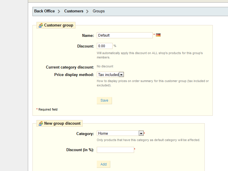

glamundfun2014 Posted October 24, 2014 Author Share Posted October 24, 2014 (edited) Yes please see the screenshot. I only have one group default customers and i enabled the display of VAT. It doesn't work. You can test the case I described in my post. Prices with VAT will be displayed only if user added his address in checkout. All prices till then are displayed without VAT Screenshot attached. Edited October 24, 2014 by glamundfun2014 (see edit history) Link to comment Share on other sites More sharing options...
