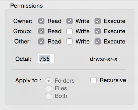

BZZYBI Posted October 23, 2014 Author Share Posted October 23, 2014 (edited) That error appears when this coomand returns false/null Tools::ZipExtract($theme_zip_file, $sandbox.'uploaded/') and $sandbox is $sandbox = _PS_CACHE_DIR_.'sandbox'.DIRECTORY_SEPARATOR.$uniqid.DIRECTORY_SEPARATOR Check zip extension and write permissions on that /cache/sandbox folder. Hi Tuk66 Thank you very much for your help. What do you mean when you say check zip extension? I am not trying to upload any theme or zip file. All i would like to do is edit the "Advanced Setting" of my theme that had already been installed a long time ago. As for the permissions for the sandbox folder. I went on my ftp and did a get info request and its set to 755. I attached an image just in case. Thanks for your help. Edited October 23, 2014 by BZZYBI (see edit history) Link to comment Share on other sites More sharing options...

tuk66 Posted October 23, 2014 Share Posted October 23, 2014 Who knows. I would put die('foo') functions before any line in the /classes/Tools:ZipExtract method and remove one-by-one to find the exact line where code fails. Link to comment Share on other sites More sharing options...
