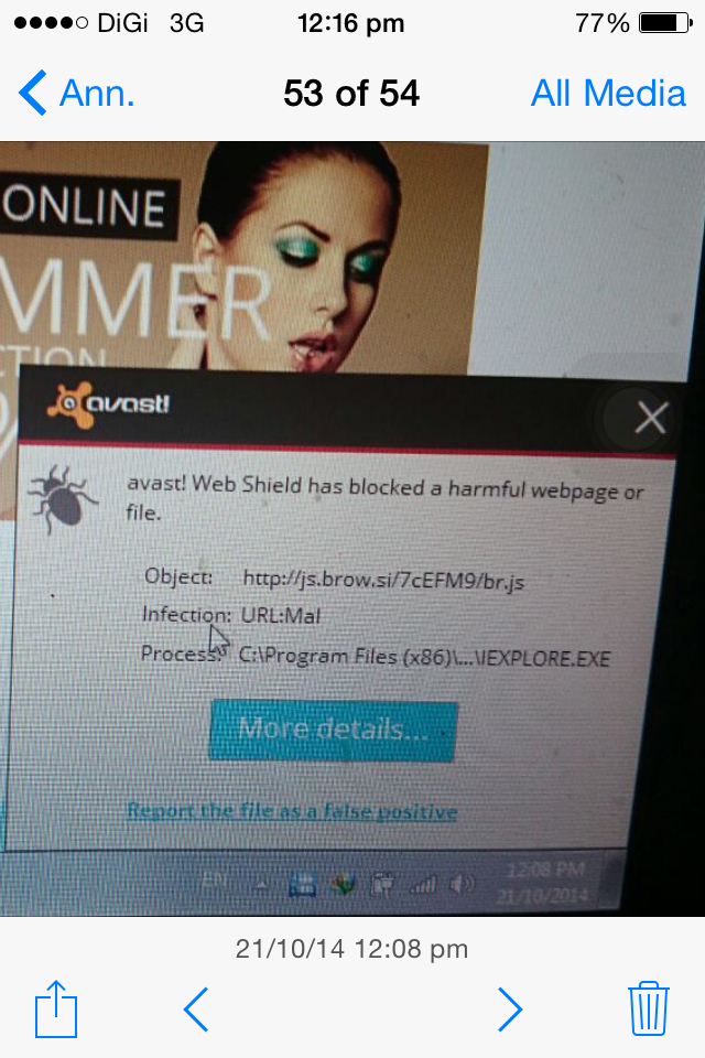

tchench Posted October 21, 2014 Share Posted October 21, 2014 Hello, I just noticed the AVAST antivirus detected malware on my website. How can i solved it? I didn't install any third party addon into the website. Pls help. Thank you Link to comment Share on other sites More sharing options...

maconl Posted October 21, 2014 Share Posted October 21, 2014 (edited) @Vekia : </script><script type="text/javascript"> var _brPrestashop = { checkout: 'http://cncdeal.com.my/v4/index.php?controller=order&step=1', cart: 'http://cncdeal.com.my/v4/index.php?controller=order', cartAjax: baseDir }; (function(w, d){ w['_brSiteId'] = '7cEFM9'; w['_brPlatform'] = ['prestashop', '1.6.0.9']; function br() { var i='browsi-js'; if (d.getElementById(i)) {return;} var siteId = /^[a-zA-Z0-9]{1,7}$/.test(w['_brSiteId']) ? w['_brSiteId'] : null; var js=d.createElement('script'); js.id=i; js.async=true; js.src='//js.brow.si/' + ( siteId != null ? siteId + '/' : '' ) + 'br.js'; (d.head || d.getElementsByTagName('head')[0]).appendChild(js); } d.readyState == 'complete' ? br() : ( w.addEventListener ? w.addEventListener('load', br, false) : w.attachEvent('onload', br) ); })(window, document); </script> As you see it is indeed there but don't know if it is only that line ,, js.src='//js.brow.si/' + ( siteId != null ? siteId + '/' : '' ) + 'br.js'; Edit : i copied the wrong line abouve Edited October 21, 2014 by maconl (see edit history) Link to comment Share on other sites More sharing options...

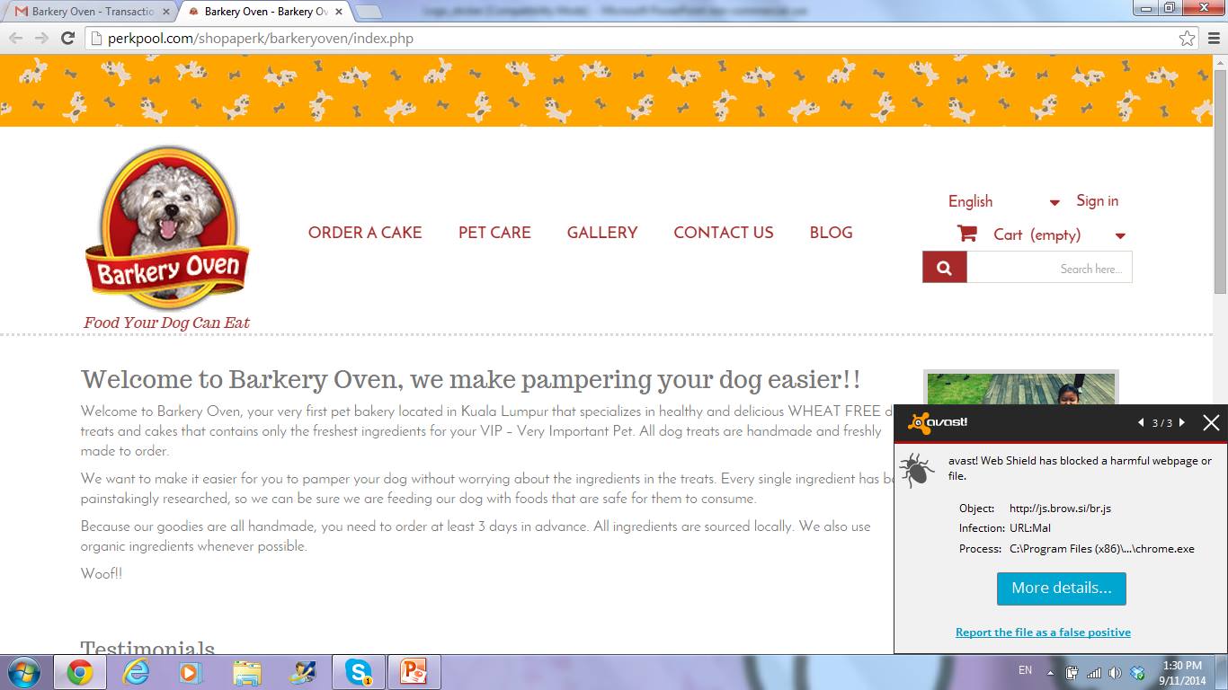

PrinceMakaveli Posted November 9, 2014 Share Posted November 9, 2014 I too face this problem when using Avast antivirus. Is this a false reading? How can I solve this issue? Please guide me because its worrying my client. Thanks Link to comment Share on other sites More sharing options...
tuk66 Posted November 10, 2014 Share Posted November 10, 2014 Do you use Brow.si Analytics? https://chartjs.challengepost.com/submissions/16431-brow-si-analytics A module or patch? It looks like that service is no longer active. 1 Link to comment Share on other sites More sharing options...
PrinceMakaveli Posted November 11, 2014 Share Posted November 11, 2014 @tuk66 I did install and use that module for testing purpose. Thanks for the info. Will update here again if the error still persist after I have disable & uninstall that Brow.si Analytics. Have a nice day. Link to comment Share on other sites More sharing options...
PrinceMakaveli Posted November 12, 2014 Share Posted November 12, 2014 Its confirm, uninstalling that module (Brow.si Analytics) solve the problem. Thanks to all. Keep up the good work. Have a nice day. Link to comment Share on other sites More sharing options...
