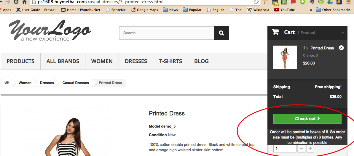

I would indeed add just a fixed message somewhere in your header or in the cartblock. If you want to make this header only appear when there's not a multiple of six, you need to add with the ajax code (ajax code send/receives values to server without leaving the page) etc, which is not so 'obvious'/simple...
So just a general message here would probably do. This you can add to either themes/<your theme folder>/header.tpl or to themes/<your theme folder>/modules/blockcart/blockcart.tpl
For example in blockcart.tpl, somewhere halfway the file you have the following code (add the red code):  (Make back up first!!!)
      <p class="cart-buttons">
        <a id="button_order_cart" class="btn btn-default button button-small" href="{$link->getPageLink("$order_process", true)|escape:"html":"UTF-8"}" title="{l s='Check out' mod='blockcart'}" rel="nofollow">
          <span>
            {l s='Check out' mod='blockcart'}<i class="icon-chevron-right right"></i>
          </span>
        </a>
      </p>
      <span id="six_box_cart_message">{l s='Order will be packed in boxes of 6. So order size must be (multiples of) 6 bottles. Any combination is possible' mod='blockcart'}</span>
    </div>
  </div>
</div><!-- .cart_block -->
and add to themes/<your theme folder>/css/global.css this code (at the end) to center the text:

in your_theme/modules/blockcart/blockcart.tpl (Prestashop 1.5.6.2), modify as:
		<p id="cart-buttons">
		{if $order_process == 'order'}<a href="{$link->getPageLink("$order_process", true)|escape:'html'}" class="button_small" title="{l s='View my shopping cart' mod='blockcart'}" rel="nofollow">{l s='Cart' mod='blockcart'}</a>{/if}
			<a href="{$link->getPageLink("$order_process", true)|escape:'html'}" id="button_order_cart" class="exclusive{if $order_process == 'order-opc'}_large{/if}" title="{l s='Check out' mod='blockcart'}" rel="nofollow"><span></span>{l s='Check out' mod='blockcart'}</a>
		</p>
		<script>
		$(document).ready(function(){
			ajaxCart.refresh();
			var cartUrl = $('#button_order_cart').attr('href');
			$("#button_order_cart, #shopping_cart").on('click', function (e) {
				e.preventDefault();
				if (ajaxCart.nb_total_products > 0 && ajaxCart.nb_total_products % 6 == 0) {
					$("#six_box_cart_message").css('color','green');
					$(location).attr('href',cartUrl);
				else
					$("#six_box_cart_message").css('color','red');
		</script>
		<p id="six_box_cart_message" style="margin-top: 10px;font-weight: 700;background-color: white;padding: 5px;">
		</p>
in your_theme/modules/blockcart/blockcart.tpl  (Prestashop 1.6.0.8), modify as:
								<span>
								</span>
							</a>
						</p>
						<script>
								ajaxCart.refresh();
								$("#button_order_cart, .shopping_cart").on('click', function (e) {
									e.preventDefault();
									else
						</script>
						<p id="six_box_cart_message" style="margin-top: 10px;font-weight: 700;padding: 5px;">
						</p>
A check is also required on the cart page (if the client knows the url)
