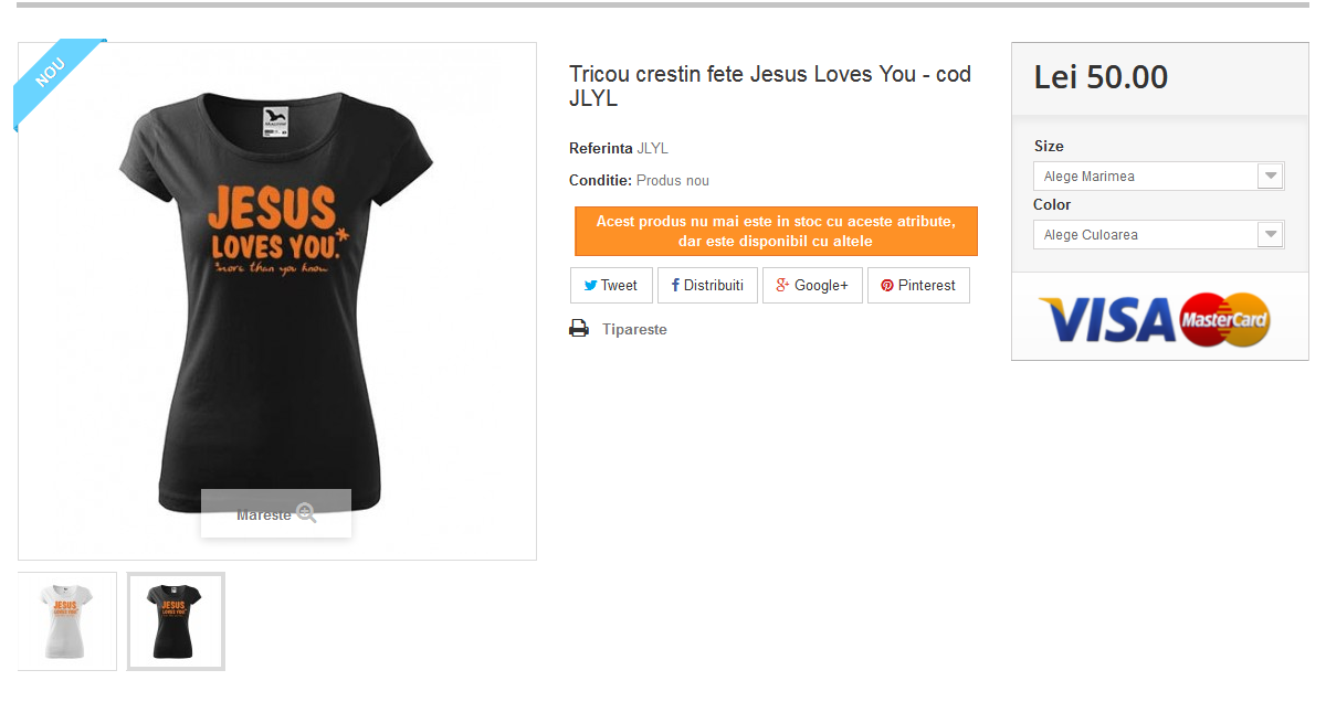

c64girl Posted July 11, 2016 Share Posted July 11, 2016 I found something funny in PS 1.6.1.6 maybe its in the lover versions too. If You add Attribute to some product that is quantity 0 PS will always disable the add to basket button for costumers. But when You have in products all Attributes on quantity more than 0 it will always pick default attribute. One problem with adding one attribute width quantity 0 to products is this in the products > monitoring will show that You out of quantity in the all products. So if You dont use products > monitoring to check the quantity its a nice trick Link to comment Share on other sites More sharing options...

Durarte Posted March 20, 2020 Share Posted March 20, 2020 Hello! I found a solution that worked for me: I created atributes "colour-choose colour" and "size - choose size" and I made combinations. So, I have a combination product-colour "choose colour" - size "choose colour" wich I make it implicit. All other combinations that include "choose size" or "choose colur" are with stock 0. And cart is not shown because implicit product size is "choose size" and implicit colour is "choose size" wich are with stock 0 Ex. here http://crossmark.ro/tricouri-fete/23-tricou-jesus-loves-you-dama.html Prestashop 1.6.1.24 Link to comment Share on other sites More sharing options...
