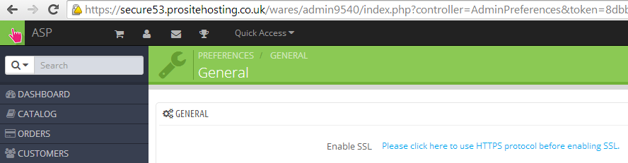

ASP Posted October 13, 2014 Author Share Posted October 13, 2014 Thank you for the continued support Mr. Dalton, I greatly appreciate the help.Please note that I am not at the stage of the scenario above. I'm stuck at the point of enabling SSL. The Pref/General page still displays the "Please click here to us HTTPS..." link. When I click, the admin page refreshes but nothing changes: Link to comment Share on other sites More sharing options...
Bill Dalton Posted October 13, 2014 Share Posted October 13, 2014 If I go to https://secure53.prositehosting.co.uk/wares/ I do see the site in maintenance mode. In Preferences/SEO & URLs/Set shop URL Shop Domain: www.example.com SSL domain: secure53.prositehosting.co.uk Base URI: /wares/ Please confirm this matches what you have. 1 Link to comment Share on other sites More sharing options...
ASP Posted October 13, 2014 Author Share Posted October 13, 2014 Yes, but the only difference is no "www.": Shop Domain: example.com Link to comment Share on other sites More sharing options...
Bill Dalton Posted October 14, 2014 Share Posted October 14, 2014 That's fine. Please try it from another browser, or clear your browser cache. It wouldn't hurt at this point to clear your web site cache \cache\smarty\compile\cache\smarty\cache\themes\your-theme\cache 1 Link to comment Share on other sites More sharing options...
ASP Posted October 14, 2014 Author Share Posted October 14, 2014 Tried in a different clean browser (Firefox), cleared my usual browser cache (Chrome) and deleted all files contained in: \cache\smarty\compile\cache\smarty\cache\themes\your-theme\cache All to no avail, I'm afraid. Still getting this: On 10/13/2014 at 10:52 AM, ASP said: Please note that I am not at the stage of the scenario above. I'm stuck at the point of enabling SSL. The Pref/General page still displays the "Please click here to us HTTPS..." link. When I click, the admin page refreshes but nothing changes: Link to comment Share on other sites More sharing options...
Bill Dalton Posted October 14, 2014 Share Posted October 14, 2014 It seems for whatever reason the PHP routines are not recognising your SSL domain even though it is a working address. Lets try to bypass that. Your host controls ... use to open your MySQL directly. In table ps_configuration Change id_configuration 31 PS_SSL_ENABLED Change to value 1id_configuration 232 > PS_SHOP_DOMAIN_SSL Change to value secure53.prositehosting.co.uk Please note the id_configuration numbers may be different, I used mine, the important part is to find PS_SSL_ENABLED and change the value to one, using the numeral 1. Also find PS_SHOP_DOMAIN_SSL. 1 Link to comment Share on other sites More sharing options...

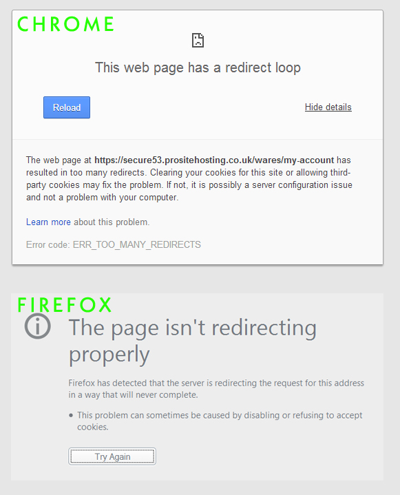

ASP Posted October 15, 2014 Author Share Posted October 15, 2014 Thank you so much, we're getting somewhere now! SSL is now enabled, but I am now unable to access the secure areas of the store due to Error code: ERR_TOO_MANY_REDIRECTS: Link to comment Share on other sites More sharing options...
Bill Dalton Posted October 15, 2014 Share Posted October 15, 2014 Lets first try regenerating .htaccess. Preferences/SEO & URLs If you have Friendly URL on, please turn off, don't forget to save. If you are not using Friendly URL please delete file .htaccess. 1 Link to comment Share on other sites More sharing options...
ASP Posted October 16, 2014 Author Share Posted October 16, 2014 (edited) Have turned off and saved, but same error received. I have Clean URLs installed, so also disabled that, but no change. Edited October 16, 2014 by ASP (see edit history) Link to comment Share on other sites More sharing options...
Bill Dalton Posted October 16, 2014 Share Posted October 16, 2014 Next please change Preferences / SEO & URLs > Redirect to the canonical URL > No Redirection. 1 Link to comment Share on other sites More sharing options...
ASP Posted October 16, 2014 Author Share Posted October 16, 2014 No change Link to comment Share on other sites More sharing options...
Bill Dalton Posted October 16, 2014 Share Posted October 16, 2014 (edited) You will need to contact your host, I should be able to reach your web site here, http://secure53.prositehosting.co.uk/wares/ If I use the secure version I am redirected. https://secure53.prositehosting.co.uk/wares/ This as you can see doesn't work. Contact your host, let them know. They may be able to change the configuration to eliminate the redirect. Edited October 16, 2014 by Bill Dalton (see edit history) 1 Link to comment Share on other sites More sharing options...

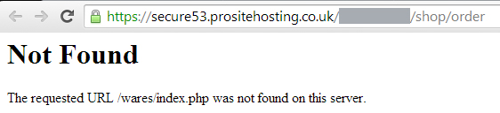

ASP Posted October 17, 2014 Author Share Posted October 17, 2014 As advised by the host, I have copied the full set of Prestashop files to https://secure53.prositehosting.co.uk/SecureDomainFolder/shop/ but the URLs for the secure content such as '/order' and '/my-account' are not real directories and result in this error:"The requested URL /SecureDomainFolder/shop/order was not found on this server."With SSL disabled I'm taken through to '/shop/order' for the cart summary page. Link to comment Share on other sites More sharing options...
Bill Dalton Posted October 17, 2014 Share Posted October 17, 2014 To be clear, you are trying to run two sets of files? If so that will not work. It will only work if you use one set of files. That means if you wish to use SSL, you must enable SSL access to the path of your PS installation. For example, if you setup you shop in https://secure53.prositehosting.co.uk/SecureDomainFolder/shop/ You need to have your host point yourdomain.com to THAT folder SecureDomainFolder/shop/ so that both can be reached. As you can see using a shared SSL domain will cause some headaches. Including having two access points that also create some duplicate content issues. That means you must also make use of Robots.txt to block search engines from indexing content from the https://secure53.prositehosting.co.uk path and only the yourdomain.com path. Add to that .... Google is now encouraging all websites to run 100% SSL. I really strongly suggest you consider installing your own dedicated SSL certificate for yourdomain.com. That is not to say we can't continue with your present course. Full speed ahead Captain, if you like. 1 Link to comment Share on other sites More sharing options...
