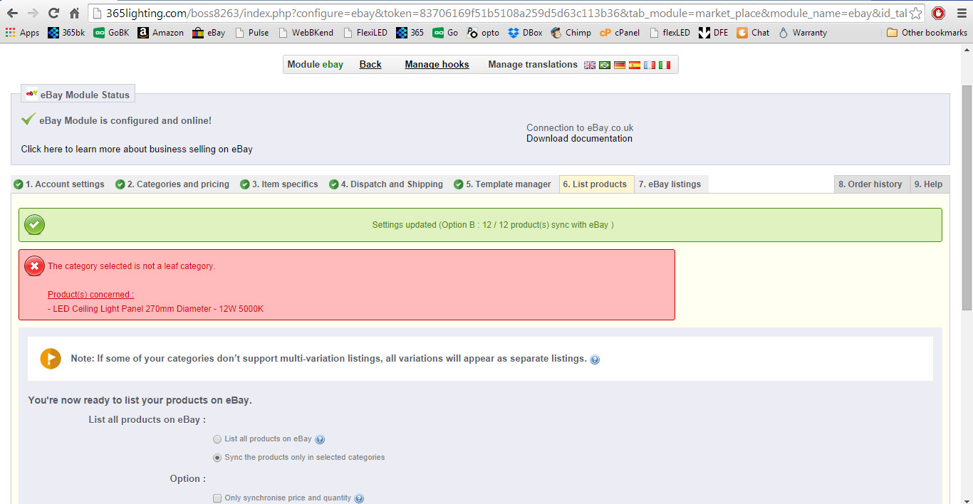

Hello all,

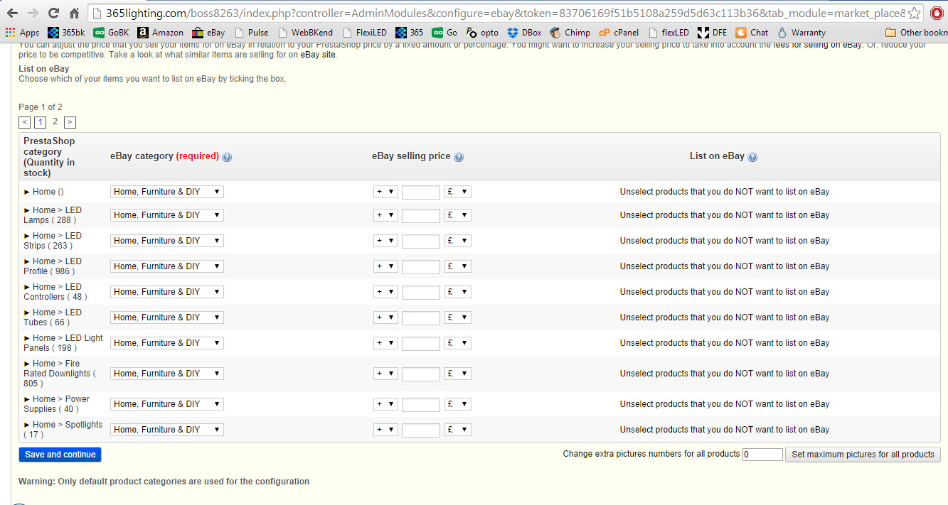

I've been using the ebay module for months now and haven't encountered this problem before. When i try to upload products I'm getting the error "The category selected is not a leaf category". After a little research I found that this meant that the category it's being uploaded to is wrong. I checked the category assignment tab and found that the upper category is correct but non of the lower category's are being displayed. Previously all of the products were assigned to the relevant sub category's without any problems.

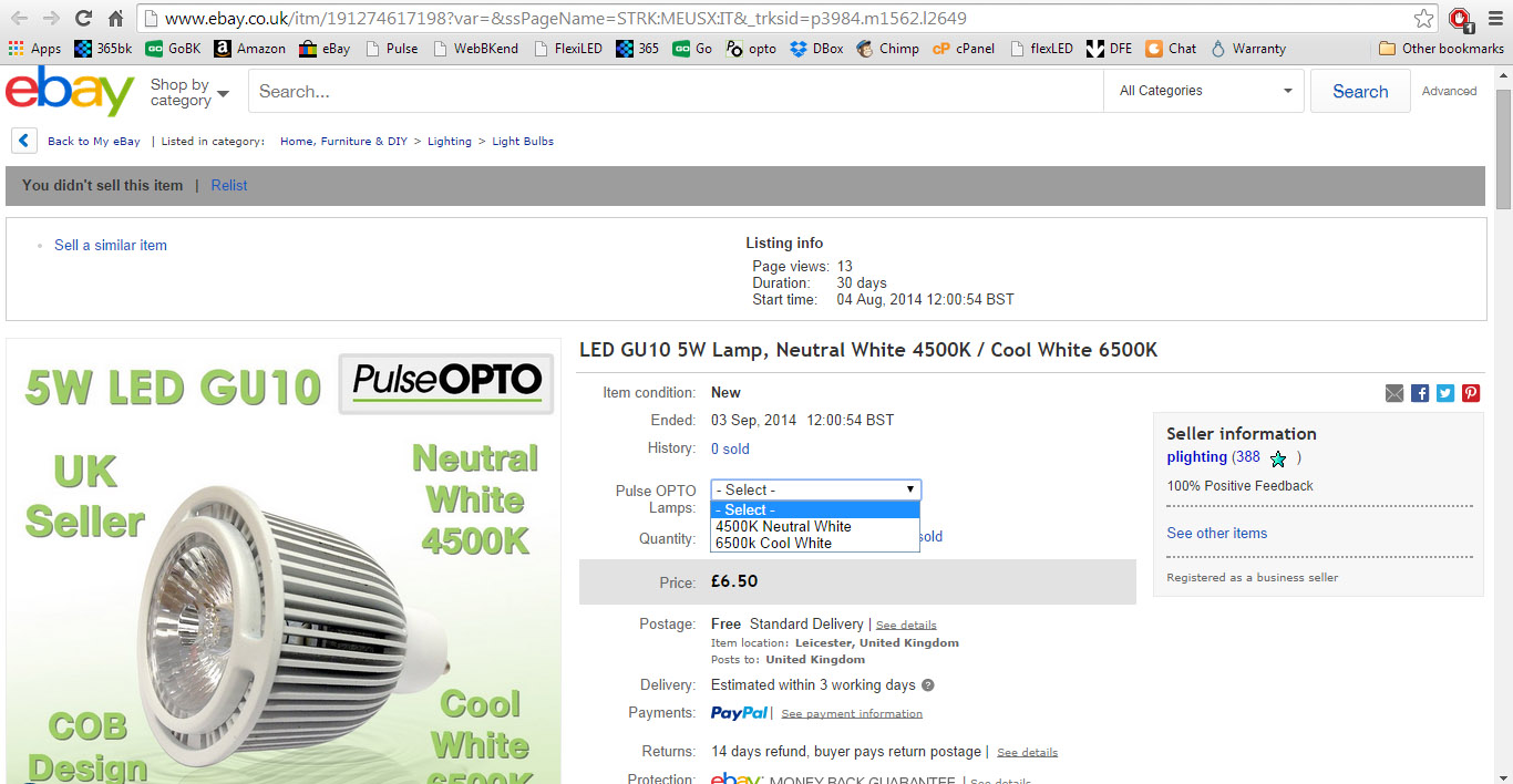

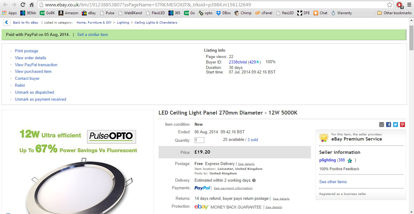

One of the attached images shows that the variants are not an issue when uploading to ebay.
