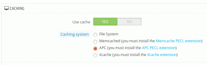

Master One Posted September 25, 2014 Author Share Posted September 25, 2014 (edited) Well, I'm still on PHP 5.5.17 with OPcache enabled, but as it seems that's not giving me any advantage, right? In Advanced Parameters >> Performance >> Caching there is only this: So as far as I understand this, without active support by PrestaShop for using OPcache as caching system I'm stuck here with either no cache or File System, because APC is only available up to PHP 5.4, Memcached is not available from my ISP, and Xcache is a Lighttpd extension (and the server my site is running on obviously is using Apache). What are my options here? Should I stick with PHP 5.5.17 and Use cache: NO stick with PHP 5.5.17 and Caching system: File System go back to PHP 5.4 and Caching system: APC ? Edited September 25, 2014 by Master One (see edit history) Link to comment Share on other sites More sharing options...

roband Posted September 25, 2014 Share Posted September 25, 2014 Well, I'm still on PHP 5.5.17 with OPcache enabled, but as it seems that's not giving me any advantage, right? In Advanced Parameters >> Performance >> Caching there is only this: So as far as I understand this, without active support by PrestaShop for using OPcache as caching system I'm stuck here with either no cache or File System, because APC is only available up to PHP 5.4, Memcached is not available from my ISP, and Xcache is a Lighttpd extension (and the server my site is running on obviously is using Apache). What are my options here? Should I stick with PHP 5.5.17 and Use cache: NO stick with PHP 5.5.17 and Caching system: File System go back to PHP 5.4 and Caching system: APC ? Ah, I've been through this some time ago, and can understand the confusion. The Prestashop "Use cache" option has nothing to do with the PHP OPcache, only about caching database query results. PHP 5.4 and earlier does not contain neither an OPcache nor the APIs needed by the Prestashop "Use cache" option. If you install the APC extension it provides both of these. PHP 5.5 and later contains an OPcache builtin, but not the APIs needed by the Prestashop "Use cache" option. If you install the APCu extension it provides this API. So your options are one of: PHP 5.4 + APC PHP 5.5 + APCu Both of these allow you to configure Prestashop "Use cache" Yes, and then choose APC as caching system. Cheers, Robert. 2 Link to comment Share on other sites More sharing options...
Master One Posted September 26, 2014 Author Share Posted September 26, 2014 Thanks for the explanation, Robert. I have just submitted a support request to our ISP, because the APCu module is not available in their PHP configuration. I can't tell if they are going to provide it, so if not, should I stick with PHP 5.5 + OPcache and Advanced Parameters >> Performance >> Caching disabled, should I use it with File System as caching system, or should I go back to PHP 5.4 + APC ? Link to comment Share on other sites More sharing options...
roband Posted September 26, 2014 Share Posted September 26, 2014 Thanks for the explanation, Robert. I have just submitted a support request to our ISP, because the APCu module is not available in their PHP configuration. I can't tell if they are going to provide it, so if not, should I stick with PHP 5.5 + OPcache and Advanced Parameters >> Performance >> Caching disabled, should I use it with File System as caching system, or should I go back to PHP 5.4 + APC ? You would have to run benchmarks using your own setup to be sure. My guess is PHP 5.4 + APC will perform best. Cheers, Robert. 1 Link to comment Share on other sites More sharing options...

n_s_simpson Posted August 18, 2015 Share Posted August 18, 2015 Okay so I'm using FastCGI, OPCache and have installed APCu. When I go into Caching System and select APC I get and error saying I need to install the APC PECL extention. Please help. Link to comment Share on other sites More sharing options...
n_s_simpson Posted August 18, 2015 Share Posted August 18, 2015 Aha, reboot server and it's working. Are there any special settings I should be using? Currently I just have: extension=apcu.soapc.enabled=1apc.write_lock=1apc.shm_size=100Mapc.slam_defense=0apc.enable_cli=1 Plus I added to php.ini the following: [uPCu} apc.enabled=1 apc.shm_size=256M Is there anything else I should do? Cheers Nick 1 Link to comment Share on other sites More sharing options...
