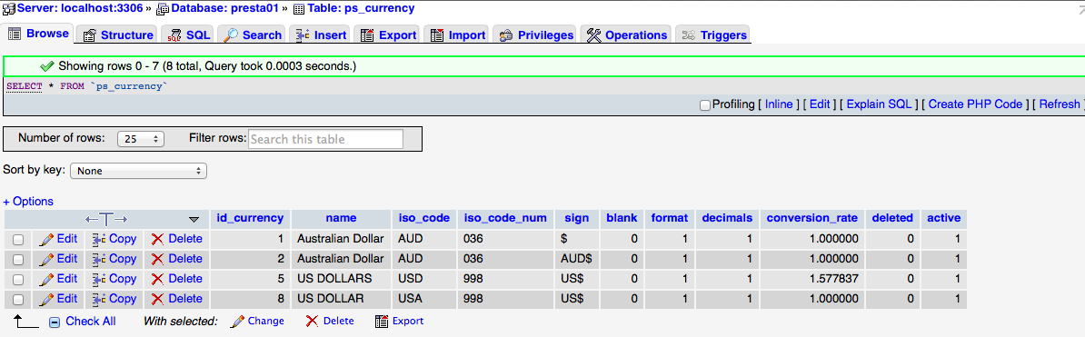

Little Black Market Posted November 27, 2014 Share Posted November 27, 2014 I have the same problem in single shop mode... It only happened after i tried to do multi-store then decided against. i went back to single store and now i get the same message as above for AUSTRALIAN AUD$ AND BRITSH POUNDS GBP... I get an error report "THIS CURRENCY ALREADY EXISTS". In fact they do not exist anywhere that I can find, and does not appear in the front shop... only the default currency of US$ appears at the shop front. At one point i did import a localization pack for these currencies... Thanks in advance. Craig Link to comment Share on other sites More sharing options...

Little Black Market Posted November 27, 2014 Share Posted November 27, 2014 how did you open up database table ps_currency and table called ps_curreny_shop??? maybe this currencies appear in there, and nowhere else??? Link to comment Share on other sites More sharing options...
Joachim Torngren Posted November 27, 2014 Author Share Posted November 27, 2014 Are you running 1.6.0.9? Then I think you should have clear cache button. Look in upper right corner: In regards to database, you need to have a program like phpMyAdmin or similar. If you haven't done that before I suggest first testing the clear cache. Link to comment Share on other sites More sharing options...

Little Black Market Posted November 28, 2014 Share Posted November 28, 2014 how do you get the database page/ table called ps_curreny_shop that Joachim Torngren has shown on his original thread... maybe if it appears in there, i can delete it and re-input again?? Link to comment Share on other sites More sharing options...
Little Black Market Posted November 28, 2014 Share Posted November 28, 2014 (edited) "THIS CURRENCY ALREADY EXISTS" error. when you get this error, do the following and it will fix it... SOLUTION... Go to phpadmin using MAMP (or whatever you are using)/presta01 (or your name)/ps-currency/browse/delete all currencies you do not need. NOTE: Some currencies appear here and not in BO or shop front, hence the error. Re-input your currencies in BO as per normal.. NOTE: If your currency options is not on your shop front to choose, simply go to modules/currency block/enable. Problem solved.... Thanks to everyone that has helped me with all my Prestashop 1.6 problems.. I am so proud that I found a solution with the communities help and now I can now give back... I am a newbie, so this is a big deal to me.... Special thanks for your help Joachim Tirngren, I would not have found it without you steering me in the right direction. Edited November 28, 2014 by Little Black Market (see edit history) 1 Link to comment Share on other sites More sharing options...
