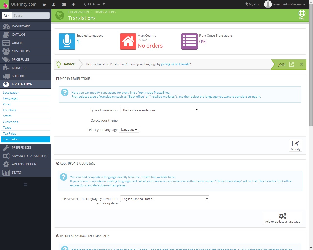

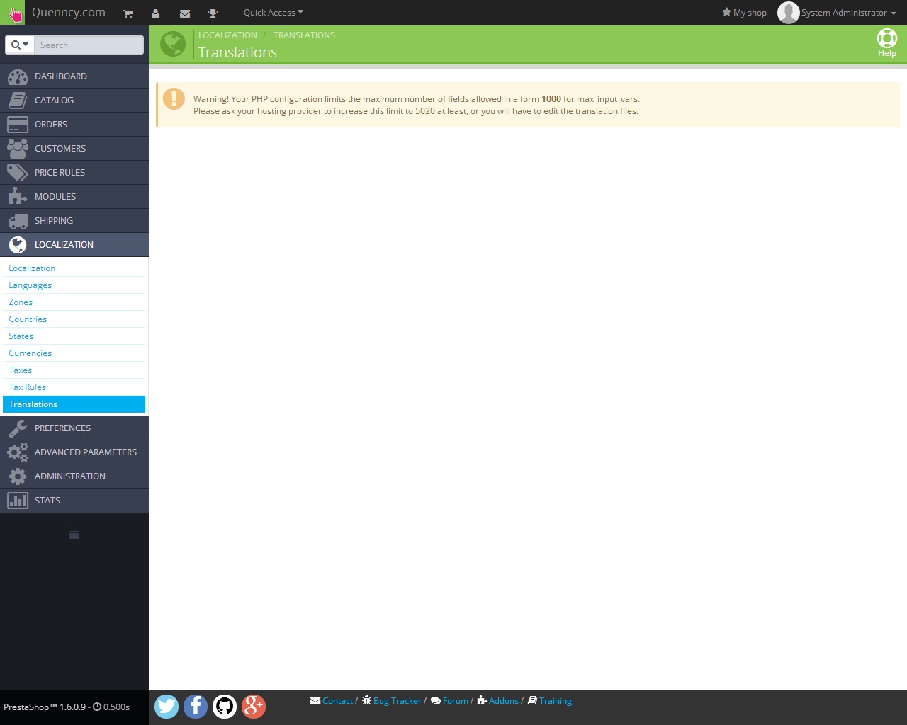

Quenncy Posted September 4, 2014 Author Share Posted September 4, 2014 (edited) Got a couple of errors thus far with your instructions. For one if you select back office translations under MODIFY TRANSLATIONS then the theme sectioning totally disappears (pic attached) and if you skip over the them and select language then I get a error about the max_input_vars (pic attached). If you could give me some insight on this it would be of great pleasure. Thanks, Quentin To change the text, you can simply head to localization->translations in the back office. Select installed modules translations, the theme, and click the language flag, then locate blockuserinfo To add other texts, on the other hands, you have to amend nav.tpl, that you can find here themes\default-bootstrap\modules\blockuserinfo Edited September 4, 2014 by quenncy (see edit history) Link to comment Share on other sites More sharing options...

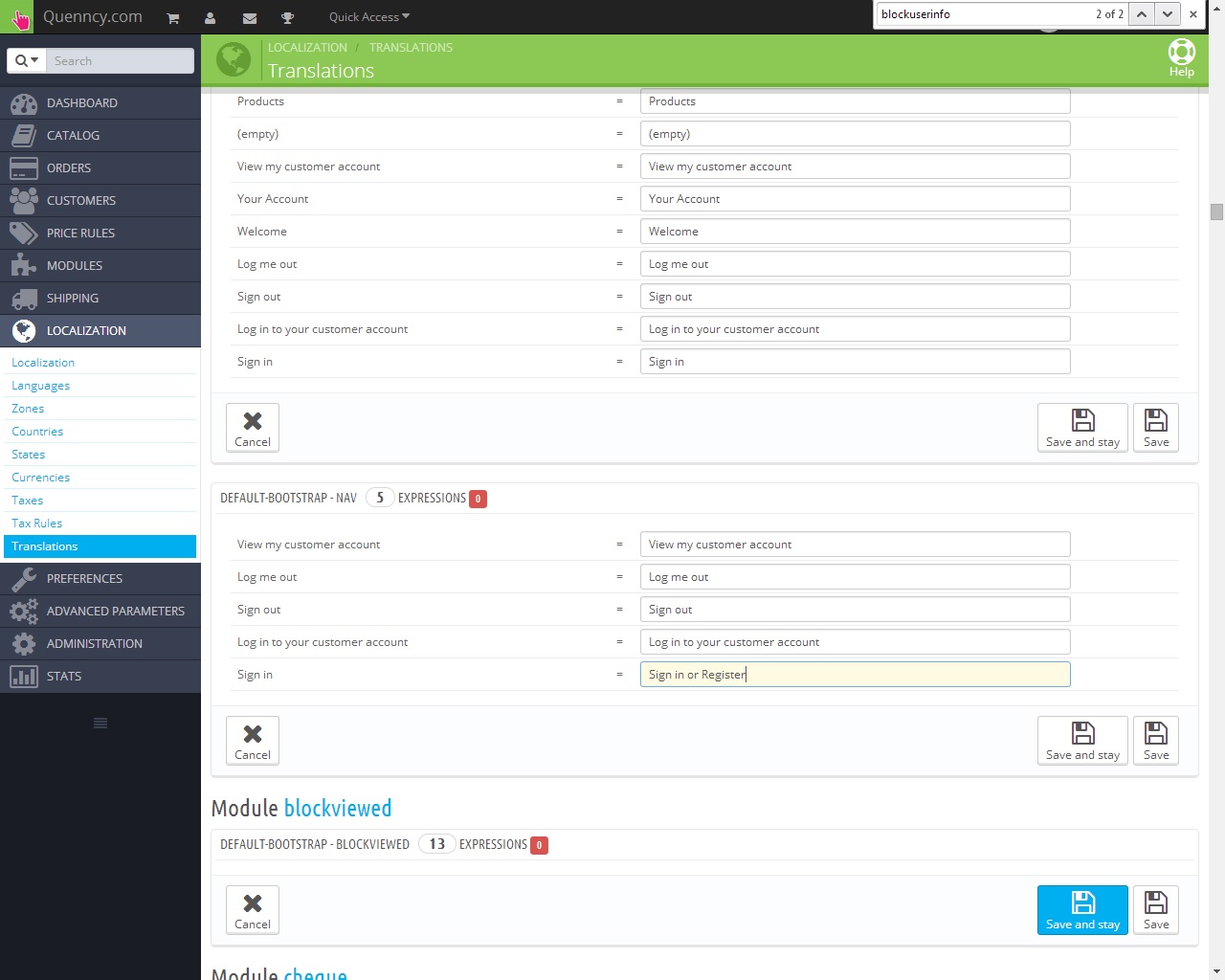

Quenncy Posted September 4, 2014 Author Share Posted September 4, 2014 Ok so I found out what area you was talking about but and I changed SIGN IN to SIGN IN or REGISTER but it did not show up on the front in. Still says SIGN IN. (pic attached) Thanks, Quenncy To change the text, you can simply head to localization->translations in the back office. Select installed modules translations, the theme, and click the language flag, then locate blockuserinfo To add other texts, on the other hands, you have to amend nav.tpl, that you can find here themes\default-bootstrap\modules\blockuserinfo Link to comment Share on other sites More sharing options...
NemoPS Posted September 5, 2014 Share Posted September 5, 2014 Really weird, are you changing it for the correct template?If you get the max input vars issue again, you can ask your hosting company to fix it as it's a php.ini problem 1 Link to comment Share on other sites More sharing options...
Quenncy Posted September 5, 2014 Author Share Posted September 5, 2014 (edited) Yes picked the only template as I am only using the default. Contact my hosting company and got my max input vars MAX OUT. Found it just shortly below the Module blockuserinfo in DEFAULT-BOOTSTRAP - NAV and changed my Sign in to Sign in or Register. Looks good on the front end now. Thank You so much and God Bless, Quenncy Really weird, are you changing it for the correct template? If you get the max input vars issue again, you can ask your hosting company to fix it as it's a php.ini problem Edited September 5, 2014 by quenncy (see edit history) Link to comment Share on other sites More sharing options...
NemoPS Posted September 6, 2014 Share Posted September 6, 2014 Ah, yes, it was nav indeed, as I mentioned above (nav.tpl) Glad you solved it! 1 Link to comment Share on other sites More sharing options...
