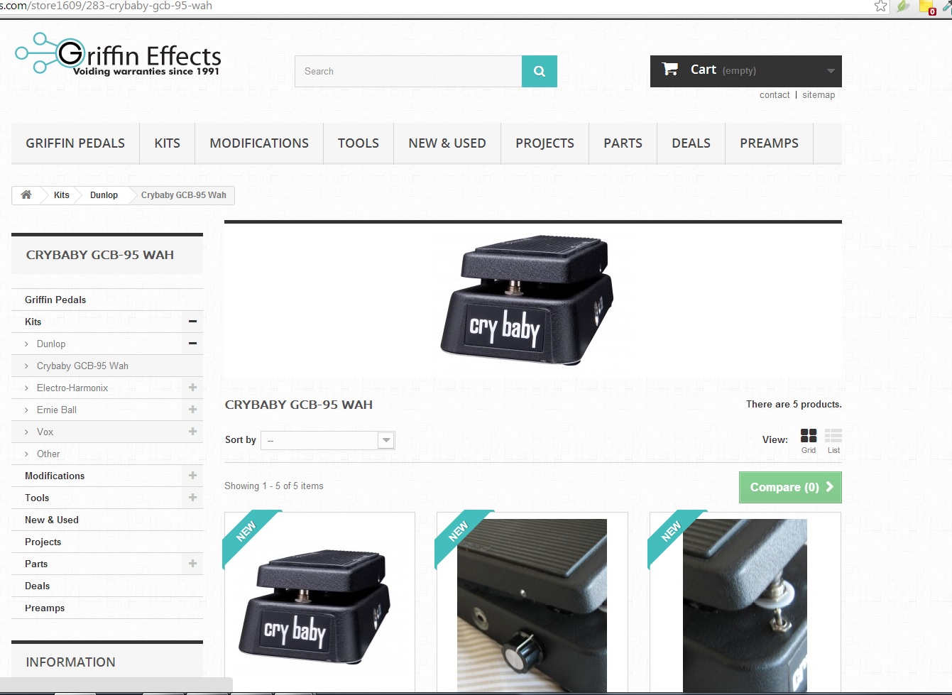

So I've been having issues with my 1.6.0.8 install so I thought I would start over with a fresh install of 1.6.0.9. Everything has been going fine until today when I saw there weren't any subcategories showing on all the category pages. As you can see in the picture, there are subcategories in the Kit main category. They show up in the menu bars but if I click on Kits, the subs don't show up. Also when I click
on the Dunlop cateory (which has subs) they don't show up either. As you can see from the second picture, once I click on the CRYBABY GCB-95 WAH category, I do get products and the breadcrumbs are right.
I checked and all the subcategories are showing they are in the main categories in the BO.
