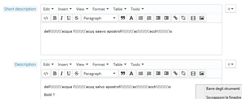

mehere Posted August 27, 2014 Share Posted August 27, 2014 (edited) Hello, hope not to duplicate questions but I searched through the forums and found nothing. Each time I add a ' (apostrophe) in product description (short and long) and click on save, a minimum of 1 "\" is automatically added. After a couple of save to make corrections in descriptions many \ make the final description barely not readable (so many \\\\\). See screenshot attached. Also, can not use Bold for texts and few other things in the editor. I disabled html purifier and tried also to enable/disable "allow iframes"...but the issue is still there. Actually I recall this issue being there since 1.6.0.5 Does anyone know how to fix? Cheers! Edited August 28, 2014 by El Patron (see edit history) Link to comment Share on other sites More sharing options...

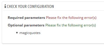

mehere Posted August 28, 2014 Author Share Posted August 28, 2014 Hmmmm El Patron, thank you very much for that plugin.... It says: magic_quotes_gpc On On magic_quotes_runtime Off Off magic_quotes_sybase Off Off But in Ps under Advanced->Cfg info I have Check your configurationRequired parameters Please fix the following error(s) Optional parameters Please fix the following error(s) magicquotesWhat's your opinion? Cheers! Link to comment Share on other sites More sharing options...
El Patron Posted August 28, 2014 Share Posted August 28, 2014 can you post a screen shot of the magic quotes setting please? your copy and paste is not clear to me, thanks Link to comment Share on other sites More sharing options...
mehere Posted August 28, 2014 Author Share Posted August 28, 2014 Huh? Sorry, in the editor it looked a nice table....didn't check then the real post :S Sorry to make you waste time... Here you have the 2 screenshots, Cheers! Link to comment Share on other sites More sharing options...
El Patron Posted August 28, 2014 Share Posted August 28, 2014 turn off magic_quotes_gpc if you do not know how contact your hosting company. There are many examples outside of PrestaShop you can try. Link to comment Share on other sites More sharing options...
