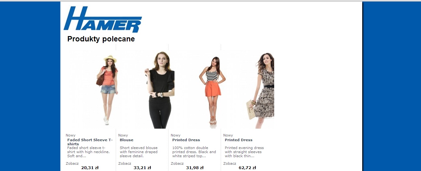

To update prestashop I didn't use One click upgrade or sth like this, just installed new prestashop. Now, I've got problems with moving old theme to new prestashop. Strangest thing is that, menu have to be in displayHeader AND in displayTop hook. If it is only in header it desn't appear at all (banner under it also disappears), and if it is only in Top it looks like in the attached image.
Also, strange thing is that when I remove menu, banner that should be under it also disappears.

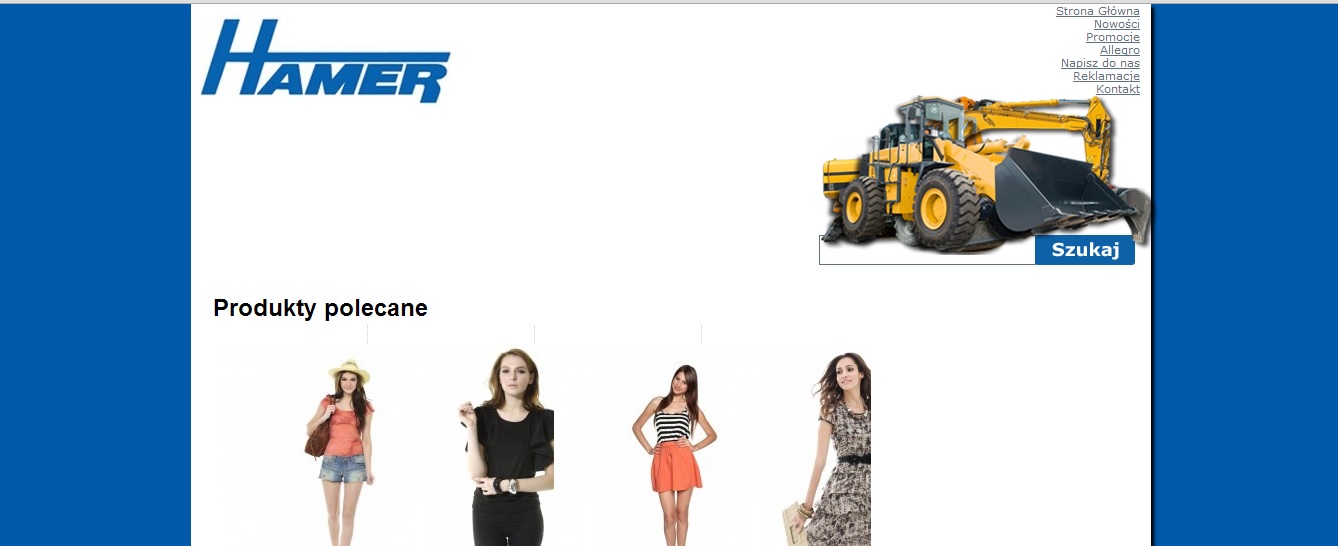

And, unfortunately, menu still has to be in both displayHeader and displayTop hooks. When its only in header, it looks like this:

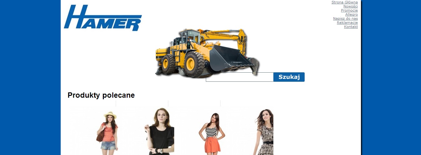

And when its only in Top it looks like this:
Do You have any idea why menu is connected to this image slider under it and to this search bar (the one with "Szukaj" button)? When menu is OK, everything is OK, when I remove only menu, all these three things disappear etc...
It worked...because of the CSS :)
Simply it was skewed inside of 70% part of the site, inside of going full-width.
You need to have it hooked in both hooks!
HookHeader assigns the css, that's why it looks so weirdly when it's onnly in the top.
HookTop assigns the content through the .tpl file - that's why you don't see anything, when only css/js files are assigned.
