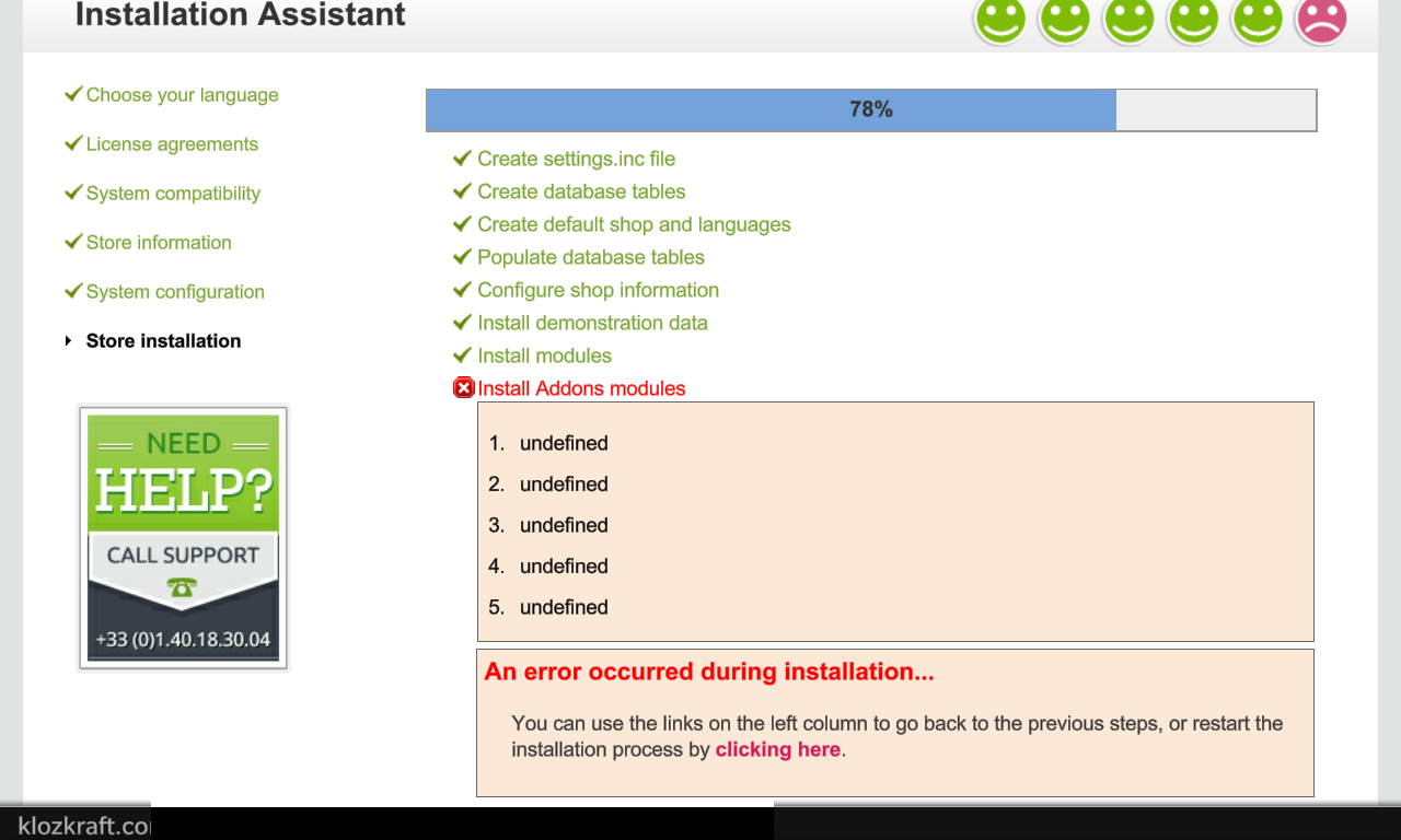

patelbhavin Posted August 22, 2014 Share Posted August 22, 2014 Hi, I am trying to install Prestashop 1.6.0.9 version on shared hosting from SiteGround.com. While installation of software process stop at 78% when installation process reaches at "Installing Addons". I tried for three four times but no luck. Even tried solution that was giving in other post but still no luck. Also gone through installation guide but no resolution giving there. Guide only has normal installation process but not any kind of specific error resolution. One more thing I notice is if I do installation with Softaculous it gets completed so this shows there is no issue with hosting. Just I get this error when I do separate direct installation with out Softaculous Right now we are in process of evaluation process for our new ecommerce business and Prestashop in one among other Four. So I seriously look for the solution here to conclude final best platform. Also attaching screen shot of error. Link to comment Share on other sites More sharing options...
El Patron Posted August 22, 2014 Share Posted August 22, 2014 That's odd..sorry you have this issue see if this post helps (but one would think you have this update)) http://www.prestashop.com/forums/topic/263678-step-install-modules-addons-fails-at-67/?p=1629907 Link to comment Share on other sites More sharing options...
patelbhavin Posted August 22, 2014 Author Share Posted August 22, 2014 Thanks for reply EI Patron. Yes I had gone through this post and even tried fresh installation with removing folder database but no luck. Link to comment Share on other sites More sharing options...
El Patron Posted August 22, 2014 Share Posted August 22, 2014 visit your hosting account (log in), and check the php and apache error logs. also, I think (never done this) that you can turn on ps error reporting during installation, let's say at db verification. open file config/defines.inc.php set to true (make sure to set to false later) define('_PS_MODE_DEV_', true); --also I have seen some issues when installed in other language than English, what those other languages were I am not sure)...so if not installing in English, try that...you can import your language and set as default later. Link to comment Share on other sites More sharing options...
stellatmy Posted August 23, 2014 Share Posted August 23, 2014 (edited) Hi, I faced this problem before. It's due to Siteground's execution limit since it's shared hosting. You have to ask Siteground on this issue. They will charge an amount to do the installation for you. Alternatively you have to use localhost method to do the installation then upload it to your server. Edited August 23, 2014 by stellatmy (see edit history) Link to comment Share on other sites More sharing options...
patelbhavin Posted August 23, 2014 Author Share Posted August 23, 2014 @ EI Patron.. thanks for information let me check as u side for PS error.. and i can confirm that i am doing installation in english only and even not changing any default selection while installation. @ stellatmy... thank for reply. but do you really feel it is hosting problem? As I said in opening messg that if installation is carried out with softaculous then we dont get any error but we get error when doing direct installation.... Link to comment Share on other sites More sharing options...

stellatmy Posted August 28, 2014 Share Posted August 28, 2014 @ EI Patron.. thanks for information let me check as u side for PS error.. and i can confirm that i am doing installation in english only and even not changing any default selection while installation. @ stellatmy... thank for reply. but do you really feel it is hosting problem? As I said in opening messg that if installation is carried out with softaculous then we dont get any error but we get error when doing direct installation.... You should check with SiteGround as they can assist to check their log to identify the problem. When I faced this problem, their reply is this: On our shared servers we have set the max_execution_time for PHP to 45 seconds. This is a global setting that cannot be changed individually. This is done to ensure that all our customers use a fair share of the server resources and to prevent users from overloading the shared server. Link to comment Share on other sites More sharing options...
