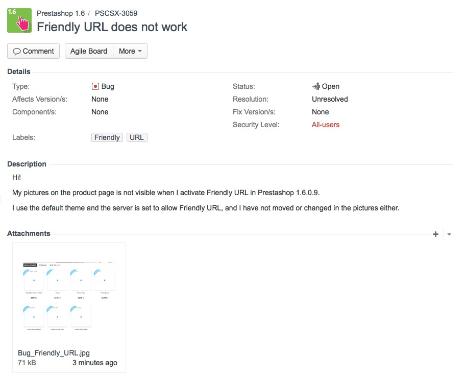

MacRoy Posted August 19, 2014 Author Share Posted August 19, 2014 I have now submitted a bug report to PrestaShop. I hope they'll look into this as soon as possible. I suggest everyone who has problems with this, report it. Regards MacRoy Link to comment Share on other sites More sharing options...
El Patron Posted August 19, 2014 Share Posted August 19, 2014 I have now submitted a bug report to PrestaShop. I hope they'll look into this as soon as possible. I suggest everyone who has problems with this, report it. Regards MacRoy please post forge report url here. Link to comment Share on other sites More sharing options...
MacRoy Posted August 19, 2014 Author Share Posted August 19, 2014 Here it comes! http://forge.prestashop.com/browse/PSCSX-3059?filter=-2 1 Link to comment Share on other sites More sharing options...
MacRoy Posted August 19, 2014 Author Share Posted August 19, 2014 [solved] Problem solved! It turned out that since updating Ubuntu Server 14.04 they had made a change in the whole structure. So the error could be corrected by adding (All) in (apache2.conf) file! I have also reported to the PrestaShop! Feels very good .... regards MacRoy 1 Link to comment Share on other sites More sharing options...
