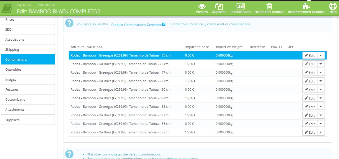

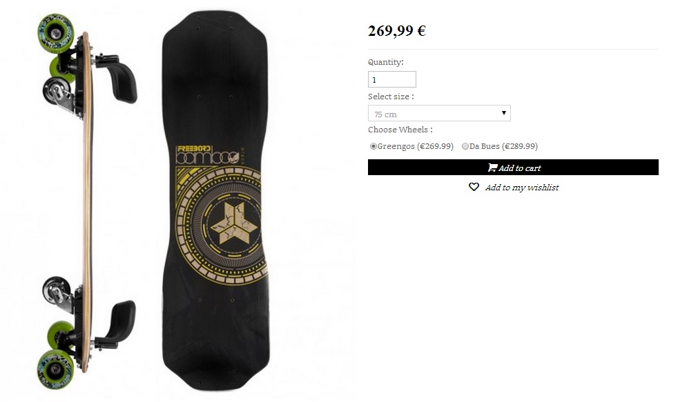

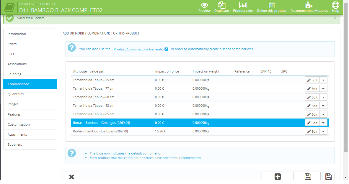

tiga Posted August 4, 2014 Share Posted August 4, 2014 (edited) Hi, I am using PS 1.6.0.8 and I need to solve a problem in my products combination To help you guys understanding the problem there are 2 files attached, front office with product page, and backoffice with Product combinations. My Store sells Freebords, a kind of Skateboard so a Complete pack includes: 1 x deck ( 5 sizes available)1 x Wheels ( 2 options with price changing)2 x trucks & 1 x bindings ( here there are no options) To make this work, I've created 2 attributes: Deck Size: 5 options (75cm, 77,80,83,85) Wheel type: 2 options (Grengos and Da blues) Problem 1# prestashop does not allow combinations in packs so I chose not to have a 'pack of existing products' and simply create Standard products. (my main concern in stock is the deck, the other items are not a problem) I've created a std product in wich you can choose the deck size and the type of wheel (one just increases 20€ in the final cost) --> The problem is when I create the combinations manually first the 5 deck sizes and then the wheels, price doesn't change, and I understand why, because the combinations are separated. --> When I use the combination generator, It creates one deck of each size for each type of wheel, everything works fine except this way I have double decks, so I'll have a problem in stock, and when some customer buys a specific pack it will just affect that specific stock. --> any way of solving this? I hope I've been explicit, otherwise let me know. tks in advance! Edited August 4, 2014 by tiga (see edit history) Link to comment Share on other sites More sharing options...
