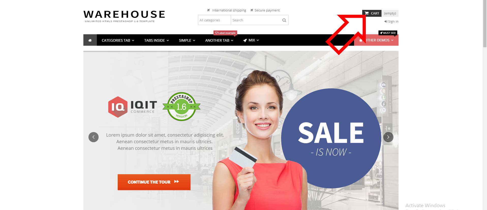

Alexandra-Ionela Posted November 12, 2018 Share Posted November 12, 2018 Hi! Does anyone knows wich is the path to the source code of the "Cart icon" in the desktop version of the website, so I can change the cart icon (font awesome) with this icon (Google material icon): <i class="material-icons">shopping_basket</i> ? I've put the "Google material icons" source code in my theme "header", I've managed to change the "User" and "Cart icon" in the mobile version of my website butI don't know how wich is the path to the file that contains the source code of te "Cart icon" from desktop version of the theme. I am using PrestaShop 1.6.1.23 + arehouse theme. Thank you in advance! Link to comment Share on other sites More sharing options...
Alexandra-Ionela Posted November 13, 2018 Share Posted November 13, 2018 (edited) 19 hours ago, mdekker said: /themes/warehouse/modules/blockcart/blockcart.tpl Hi! I've changed all the <i class="icon..............."></i> elements from the "blockart.tpl" file with this code <i class="material-icons">shopping_basket</i> and I haven't seen any change :(((( Am I missing something? Thank you! Edited November 13, 2018 by Alexandra-Ionela Wrong translate (see edit history) Link to comment Share on other sites More sharing options...
